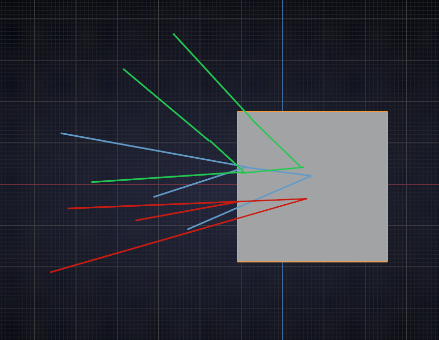

This I can understand, I think; subsurface scattering IRL is random per photon, but because of the amount of photons, that becomes a coherent effect. Think of throwing a dice, then the outcome is random, but when you throw it many times (like a googol (10 to the power of 100) times or so, then you will see a coherent result: about as many sixes as ones as threes and so on.
But in CG you can only calculate a limited number of samples, so in order to simulate life, they need to be not random.
Why this can lead to a cross shaped pattern I do not understand, but I can grasp how a pattern can be ‘amplified’ by a larger radius (how deep the photons penetrate before they get scattered (this is probably my worst drawing ever):
The rest is actually quite obvious, I think.

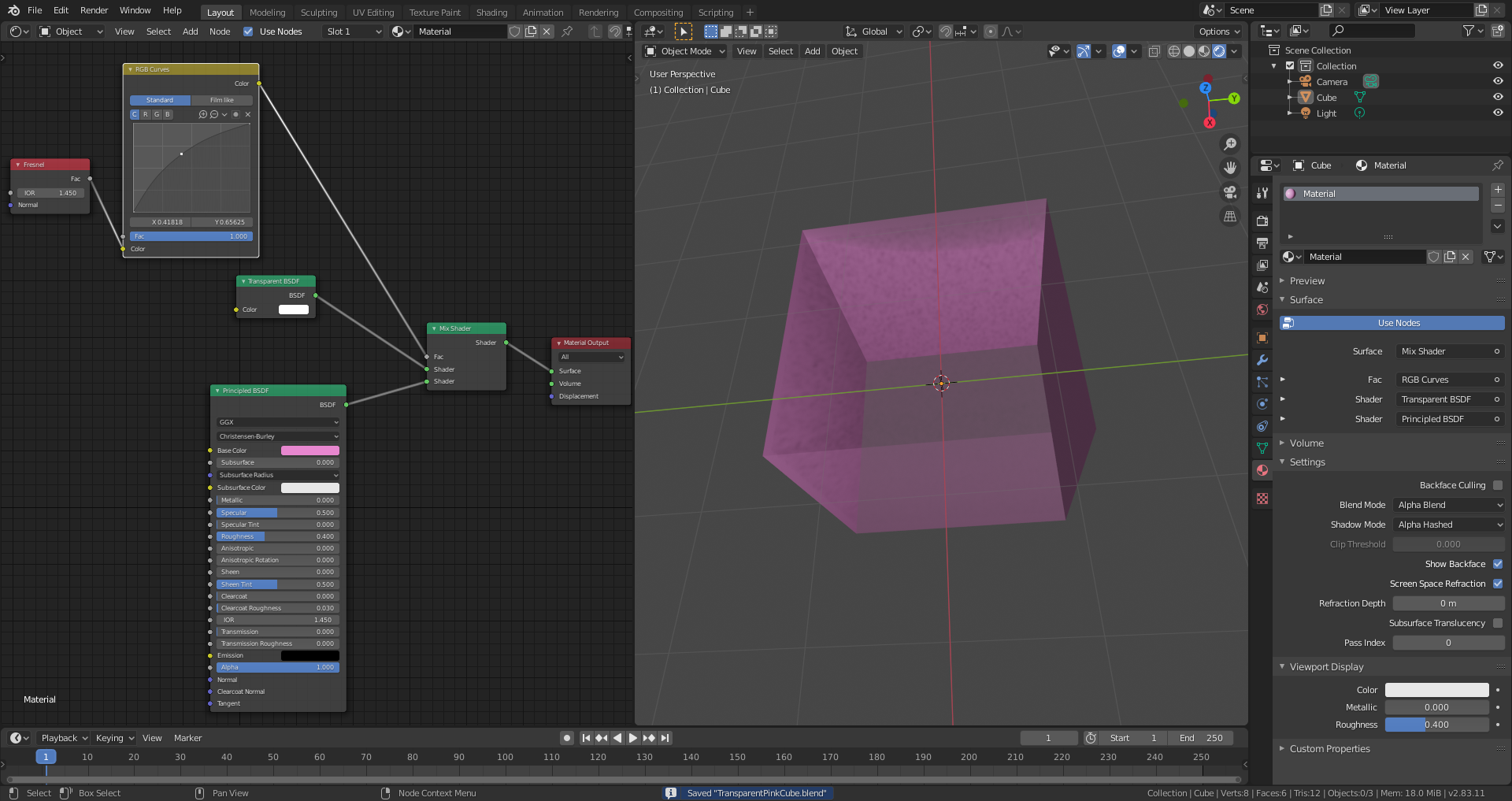

I’ve chosen “Alpha Blend” instead for creating a transparen cube. It seems for me to be a good choice:
