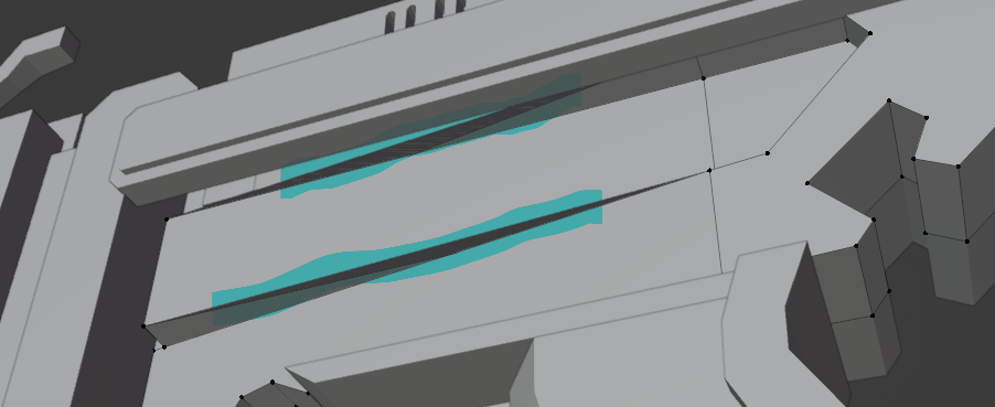

      Hey Guys, so I believe I am doing this part correctly, It’s hard to tell if Jonathan has my same issue, however, my edges seem to create a shading that is not very appealing to the eye when implementing the shearing method. Please see below images for reference. What is the proper way to handle this issue?
      #75896
        You might have double faces there interacting, or one face occupying the space of another face. If you could make the .blend file available I could take a better look.

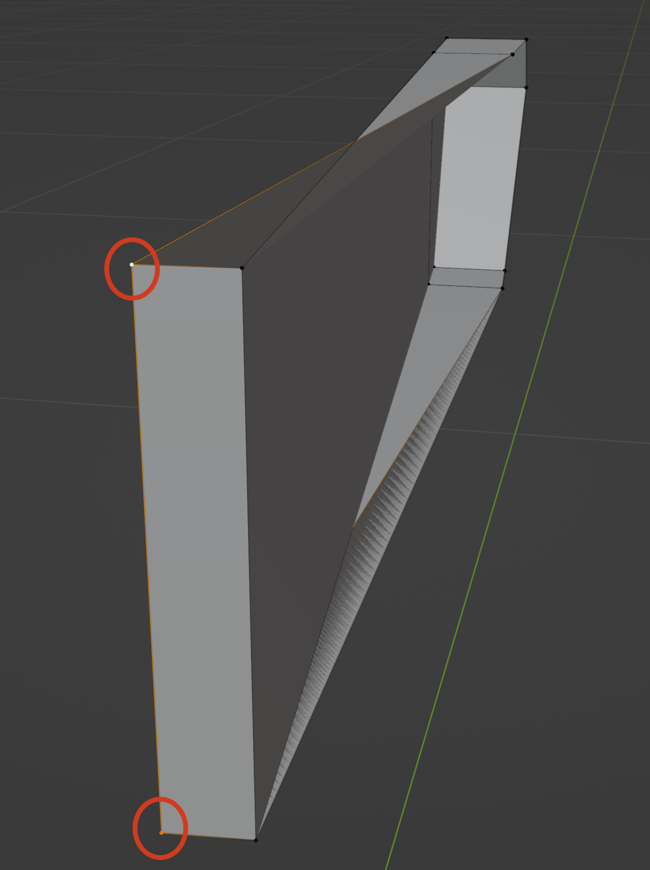

            No, you have those faces criss-crossing, folding in on itself. You can see how there is Z fighting in there, where the faces meet it looks jagged. You can select the vertices and pull them in X and they will unwind:
