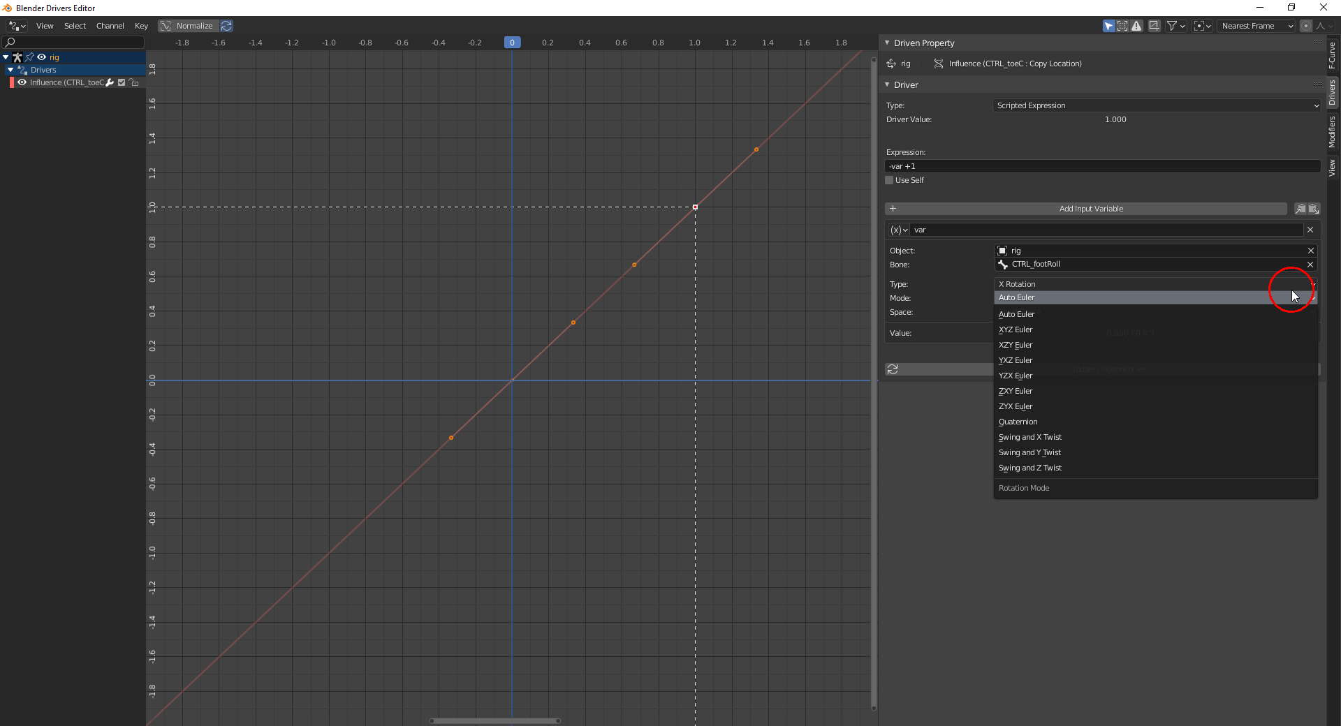

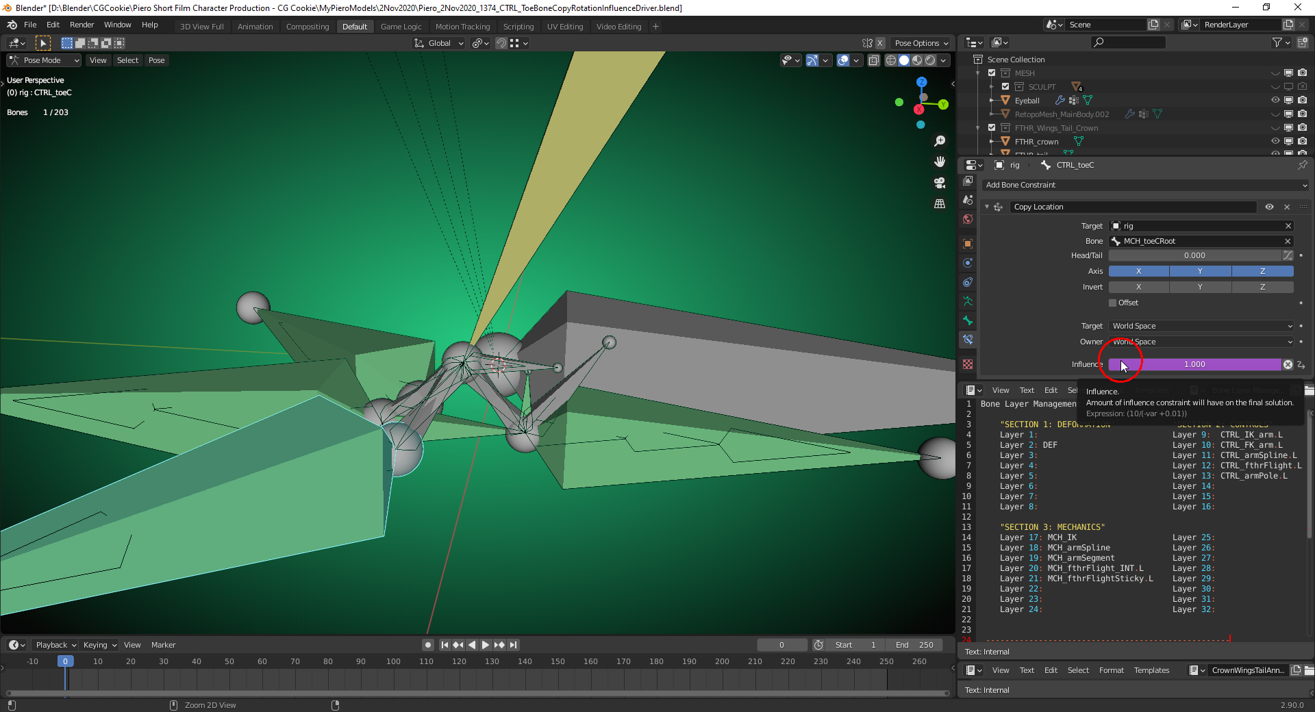

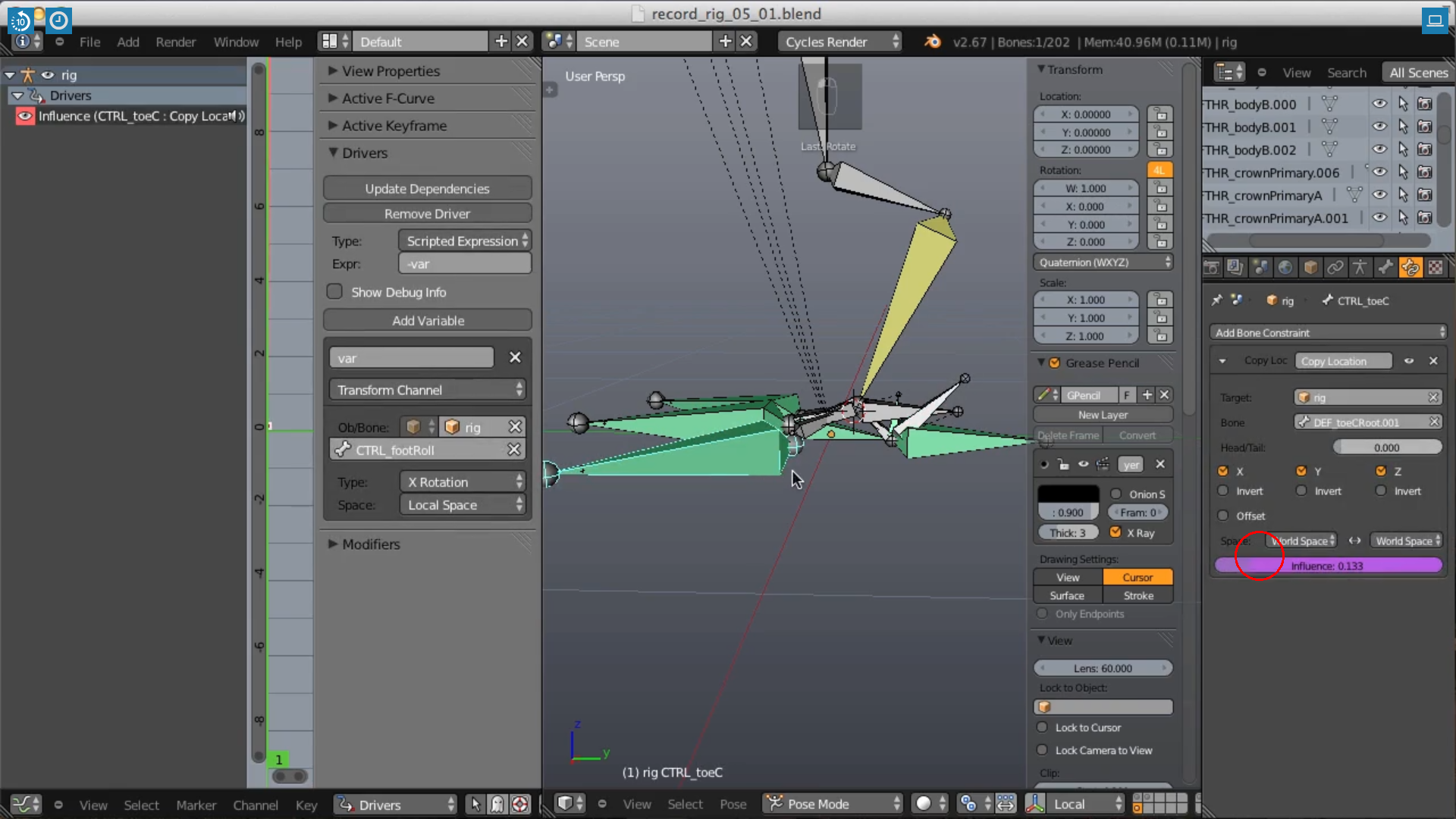

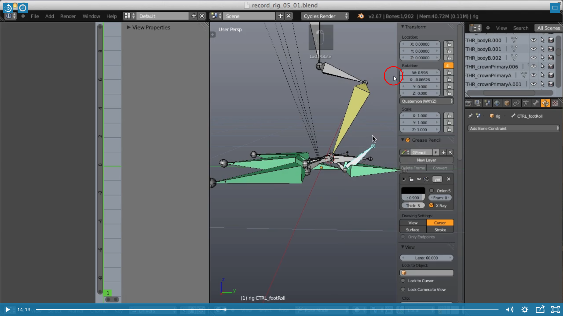

I’wondering why an “X Rotation” value of “-0.06626” of the “CTRL_footRoll” bone is translated into a “Scripted Expression” value of “0.133” with “-var” as “Scripted Expression”:
At 15:44 and the following seconds in the video “Rotation X” is set to 0.28″ and “var” as the only “Driver Variable” copies the “Local Space X Rotation”. Therefore, I expect the expression “-var +1” to have the value of “0.72”, but it’s “0.433” that is beeing fed into the driven “Influence” value!
I’ve just seen that in Blender 2.90 you can select a “Mode for calculating rotation channel values” which is set to “Auto Euler” per default:
Since the “Bone Rotation” in “Pose Mode” is set to “Quaternion” per default, one might suppose that this could be the explanation for the discrepancy described above. Blender 2.67, which is used by Kent in the video, doesn’t offer that “Mode Selection”.

Rotate a bone in “Quaternion (WXYZ)” (default for bones in “Pose Mode”) around its “Local X Axis” and “W” as well as “X” will change!

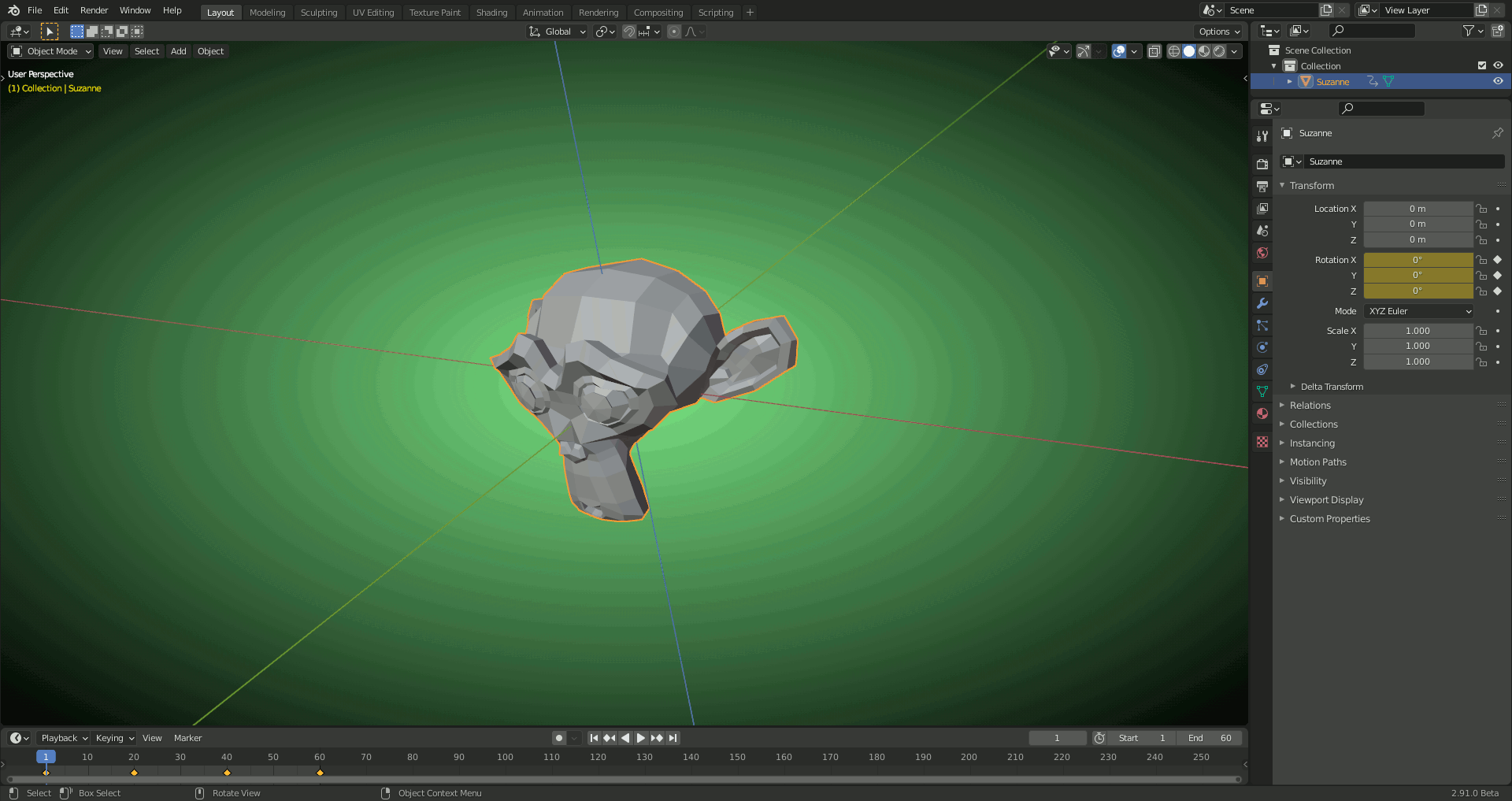

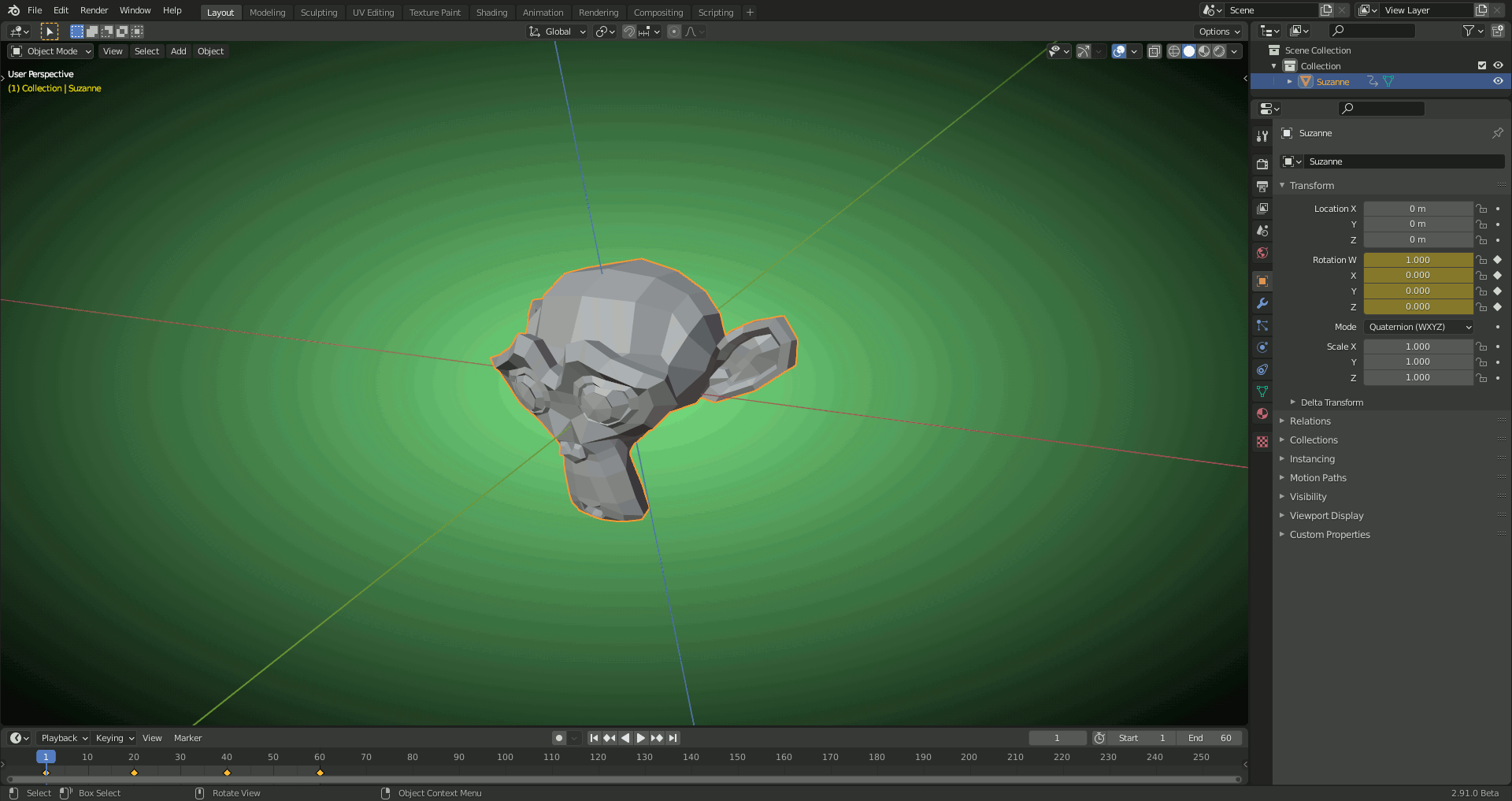

Just as an illustration for the advantages of “Quaternion Rotation” compared to “Euler Rotations” when dealing with rotations around all three axes:
1) XYZ EULER: Rotating Suzanne around the “Local Y Axis” 90 degrees causes “Gimbal Lock” (the inner “X Axis” gets aligned with the outer “Z Axis” so that we effectively loose X as “Rotation Axis”) which Blender has to solve by a slight detour when turning Suzanne to the front:
2) With QUATERNION: Smooth blending between the keyframes (no detours):
Note: The keyframes are linked to the different “Rotation Coordinate Systems” so that the different animations can easily be selected by switching between both systems.

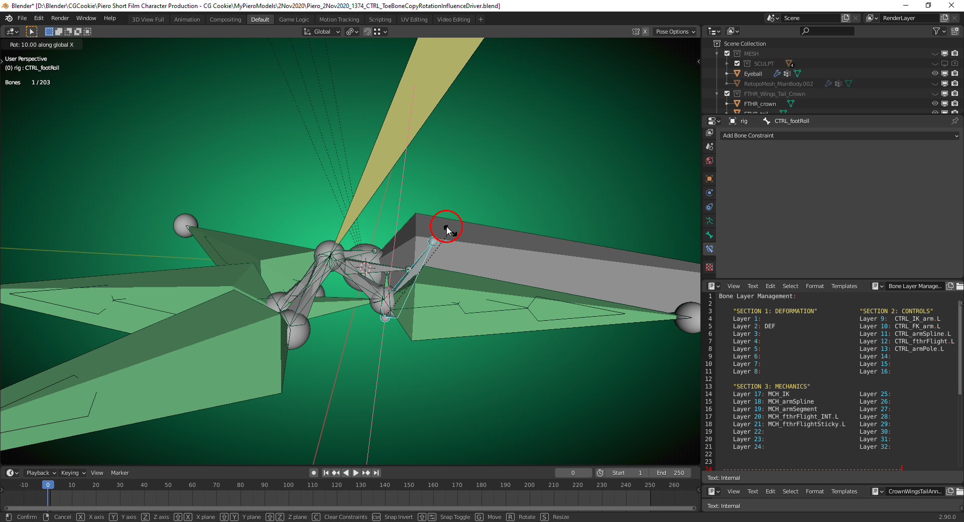

The “Control Bone” “CTRL_footRoll” shall during its rotation to the front toes set the “Influence” of the “Copy Location Constraint” on “CTRL_toeC” set to “0” so that this bone stays on the ground instead of moving slightly upwards (see video from 11:59 on):
When rolling “CTRL_footRoll” backwards the “Influence” of that shall be reset to “1” again in order to make the “CTRL_toeC move upwards.
The rig is here.

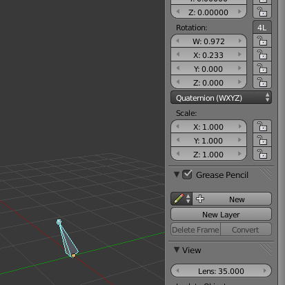

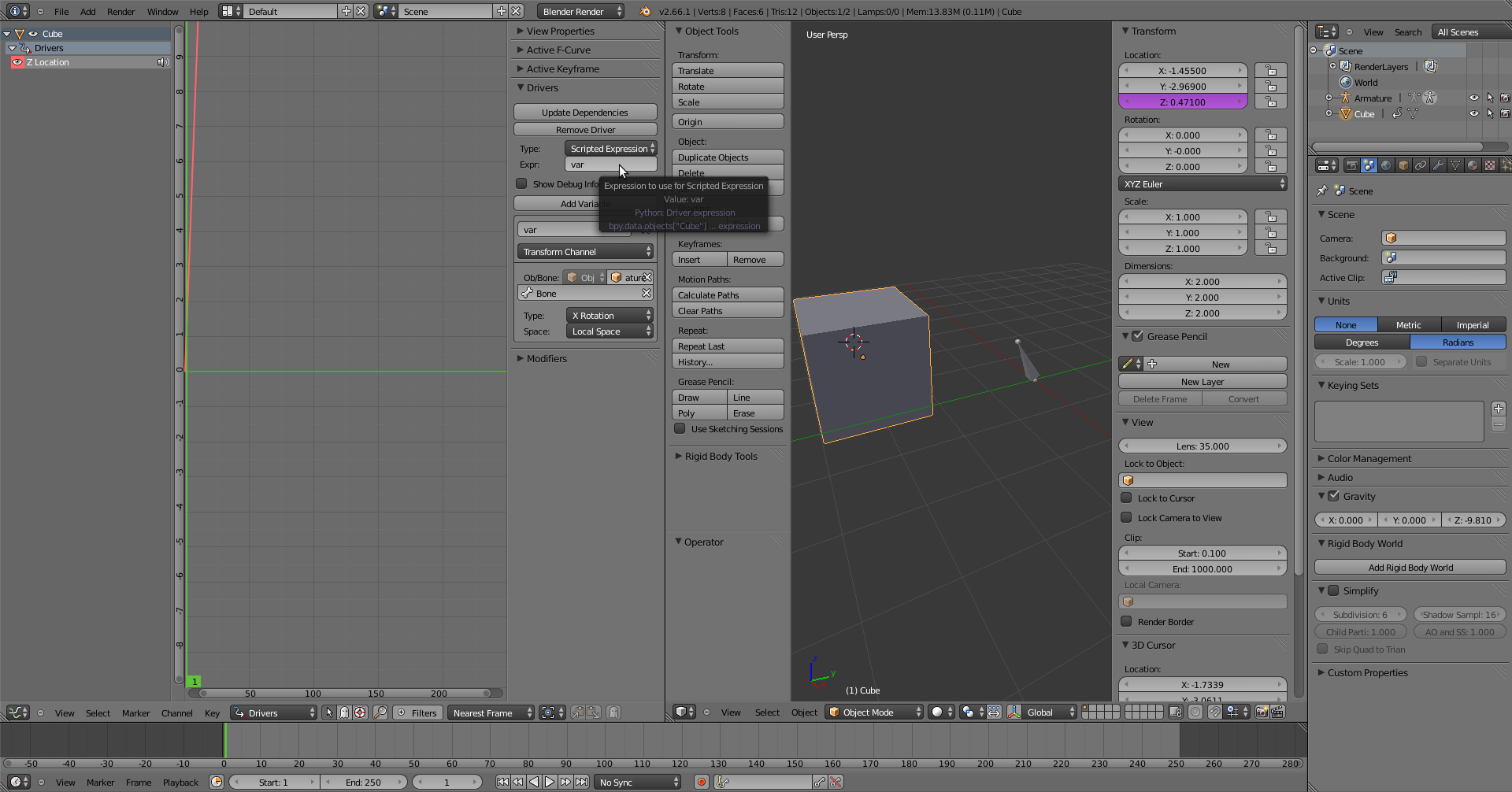

Using “Quaternions” in older Blender versions can lead to wrong values within “Drivers”. A “Quaternion Rotation” in Blender 2.66 with “X = 0.233” results in the value “0.263” when using it in a “Single Variable Expression” in a “Driver” as can be seen here. with a bone’s “X Rotation” driving the “Z Location” of a cube. Blender 2.90 can handle “Quaternion Rotations” properly since you can also select “W Rotation” as driving value which wasn’t possible in Blender 2.66.

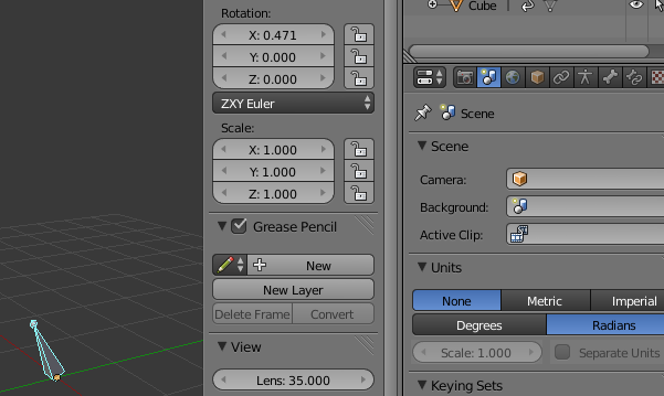

Seems to be working in 2.66a, when not using a constant in the scripted expression field:
and of course using Euler for the bone and radians:
