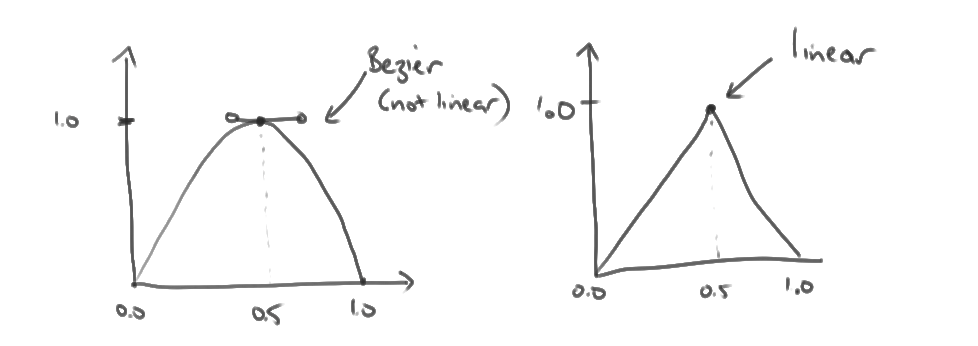

          I haven’t ever found a need to go ‘full spaghetti’ mode with the driver mapping.
          However, there is sometimes a need to fire a driver off at the 50% mark with different interpolation types though.
          Hope this makes sense.
          This might be for something like a corrective shape key which needs to turn on and then off at a specific value.
