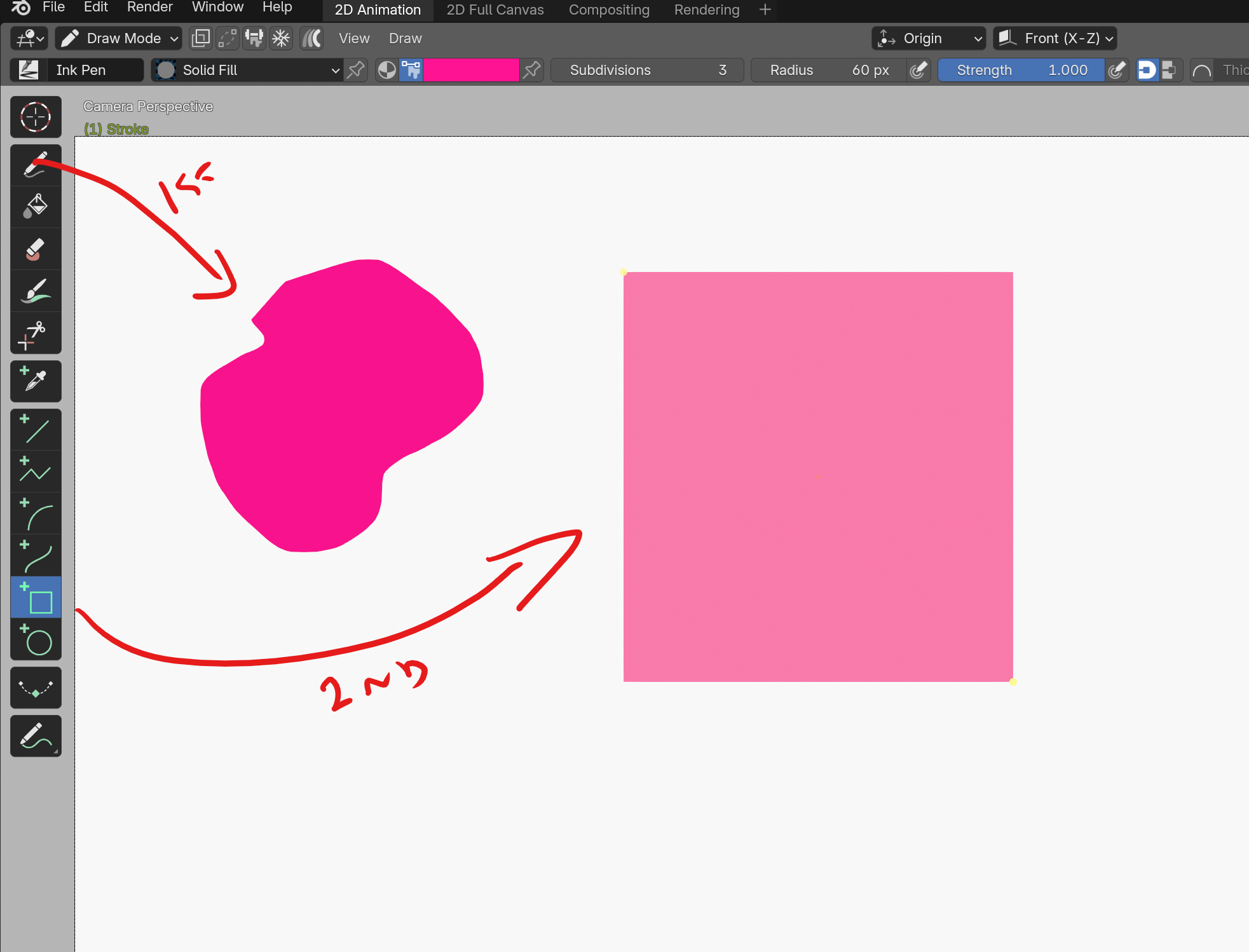

I’m in a Draw mode, with Solid Fill material selected and the Box tool active.

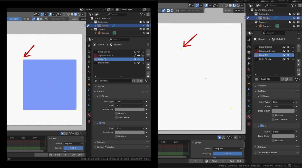

In version 4.1.1 when I start drawing the rectangle, I can see a preview of what I’m drawing in a lighter color. I can adjust the yellow points and when I confirm, the shape gets the full color.
In version 4.2.0 however, I cannot see what I’m drawing. I only get the yellow dots. Once I confirm, the shape appears as expected. I haven’t found this reported as a bug, so is there a new setting in 4.2 that I need to enable? I did my best to compare the versions side by side but I couldn’t find any differences.
