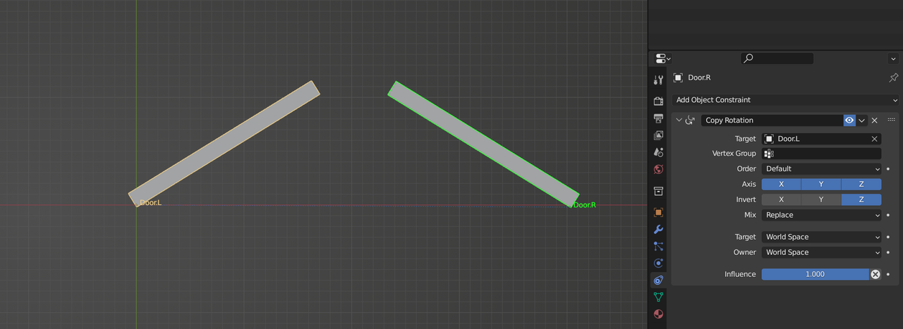

        There are many ways to do this; one would be to use a constraint on one door and rotate the other (mind the Inverted Axis):

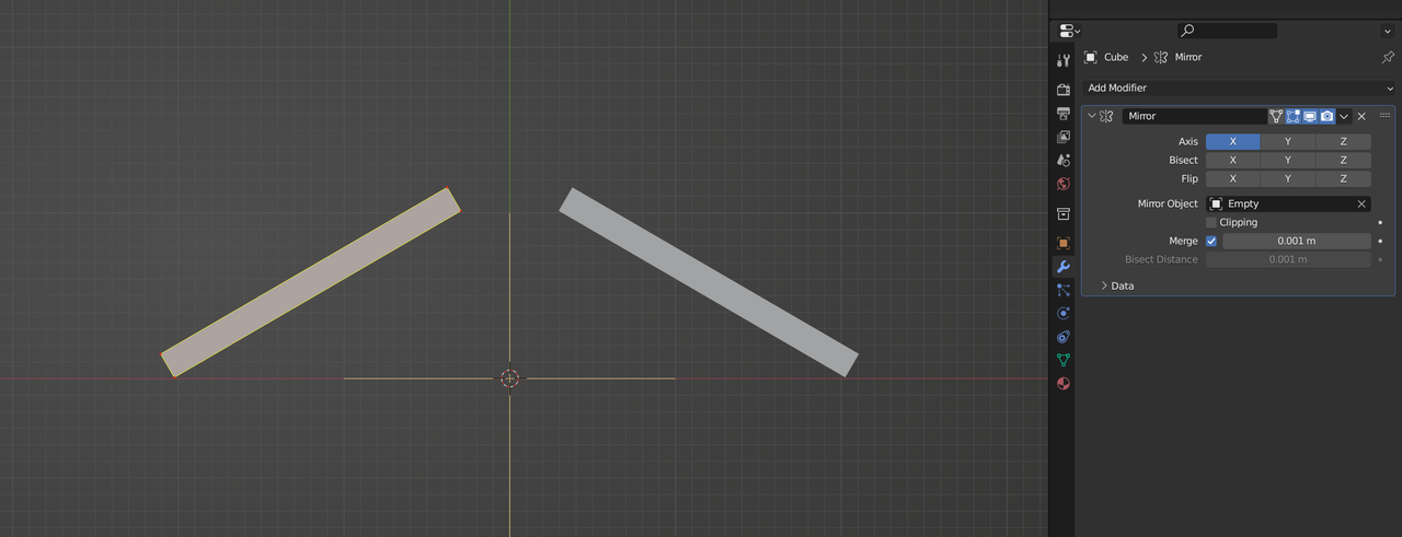

        Or, if the doors are the same, I’d use a Mirror Modifier (you can probably us the door frame as Mirror Object, instead of the Empty):
