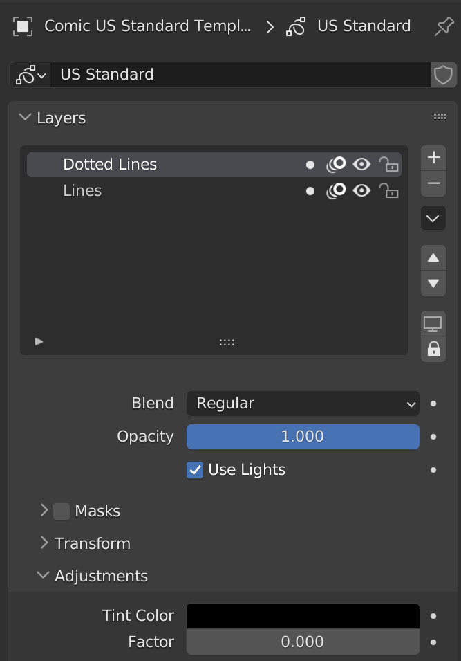

      I’m enjoying your course and seem to be plodding along with some success but I’ve encountered an issue with setting up the dotted lines on the inner-two rectangles. On my first attempt, I noticed that the two inner rectangles changed to gray but yours did not. On my second attempt, I encountered the exact same thing but also noticed that the outer rectangle seemed to have inherited a dotted pattern (see image). I’m working in V 3.3.1 and noticed that the interface was a bit different but I didn’t recognize anything to be notably different. Am I missing a step or two?

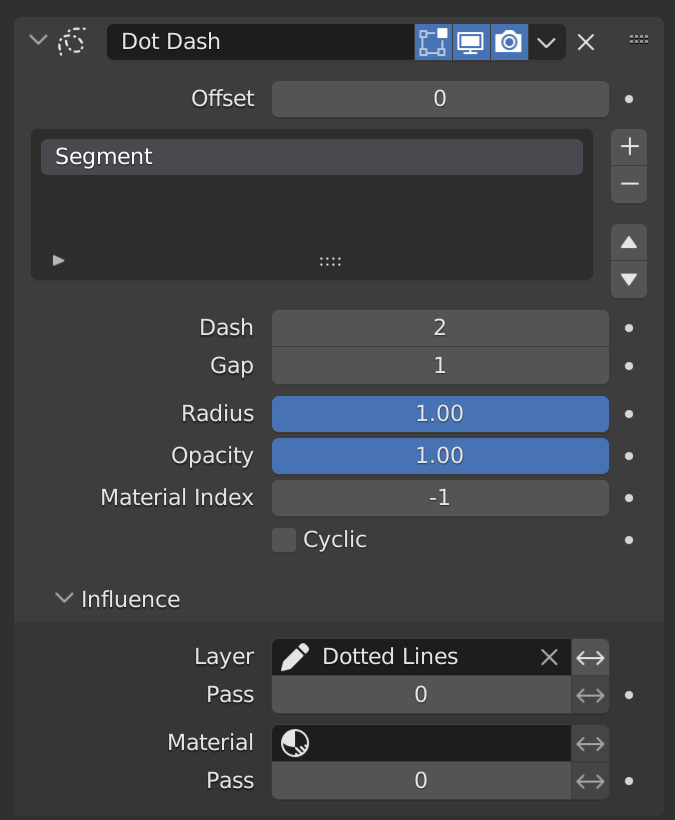

        From 18:14 onwards, I go through the process of creating a separate layer called “dotted lines” and moving just the two interior strokes to that layer, leaving the outer stroke on the original “lines” layer. When I apply the Dot Dash modifier, I make sure that under “influence” I select “dotted lines” from the Layer drop-down. This will isolate the modifier to only strokes on the “dotted line” layer.

          Green Lines.pngPaul,
          Thanks for such a quick response! Looking back at my question, I think I was a bit vague in my explanation. I followed the course all the way up to subdividing in edit mode and then again when I didn’t get the desired outcome, and when I selected the two inner panels and assigned them to the dotted line layer and applied the modifier, the lines became “grayed”. I assumed that (because you had explained about nothing showing until the subdivisions needed to increase) I would see dots after about 5 levels of subdivision but both times I tried, the same thing happened.
          I reloaded the template and went all the way back to the beginning on the second try. All went well until I began the dotted line layer part of the process. Hard to say exactly where, but I looked over all the details you’ve illustrated above before I made my query. I feel almost certain I’m missing some small detail but I did follow very closely and did adjust appropriately with the layer assignment as well as the influence.
          I would reiterate that the “gray” lines didn’t appear until after I applied the modifier. I did consider the possibility that I may have inadvertently activated something in the dope sheet but visually, I could see no difference between our screens.
          Also (on further inspection), I believe the dotted line I saw on the outer panel was just the marquee and when I increased the opacity in onion skinning to 1.000, the lines turned green (see above).
          Thanks so much for your patience and I very much appreciate this course! I look forward to completing it successfully!! 🙂
          #76138
          Paul Caggegi
            I see something from your screen-grab which is hinting at key-frames being the problem. There are 2 on the Dotted Lines layer (check the Dopesheet). Try deleting the key-frame at frame 0 on the Dotted Lines layer; move the key-frame for Lines up to Frame 1 (unlock the layer, select the key-frame, hit G-Key to move and either manually move it, or hit X then 1). Make sure auto keying is disabled (see the activated blue record button?) This is just some trouble-shooting. The greying is because it added a new key-frame to the Dotted Lines Layer and you’re observing the onion skinning.
