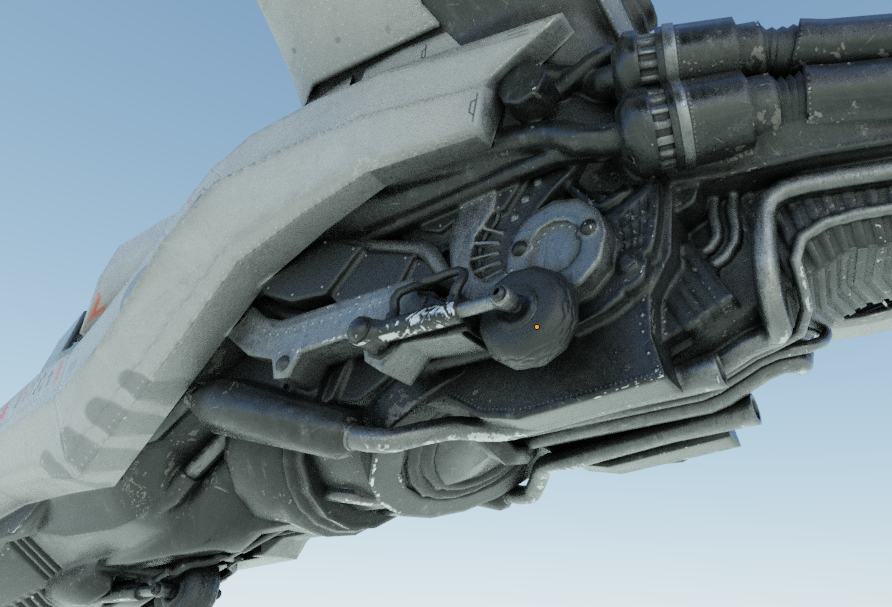

Example of a Cycles material without an AO pass but natural self shadowing because of the raytracing:

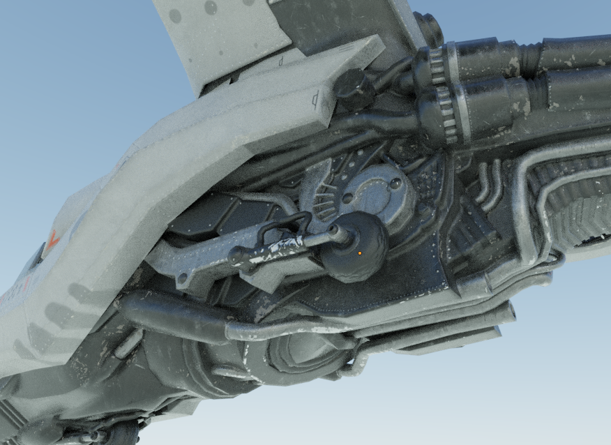

Added AO map for slight extra pop:

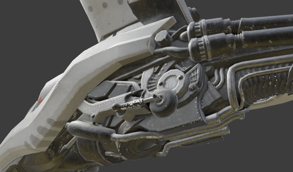

Not a huge difference. Eevee without any AO:

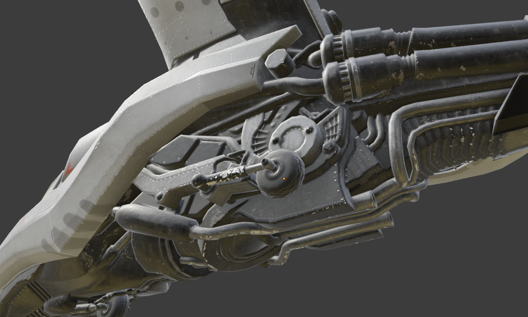

Eevee with AO pass:

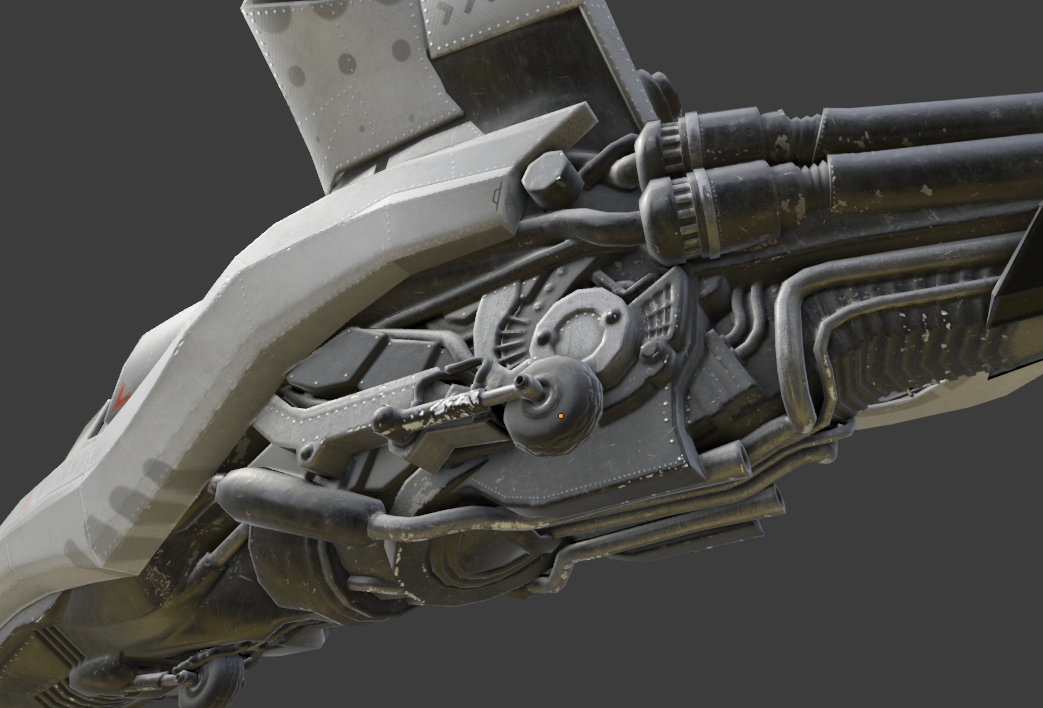

Eevee with AO map multiplying the base color in the material but no AO pass:

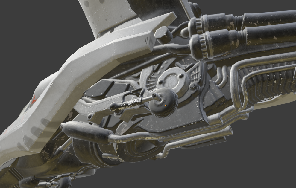

Eevee with AO pass and AO texture:
