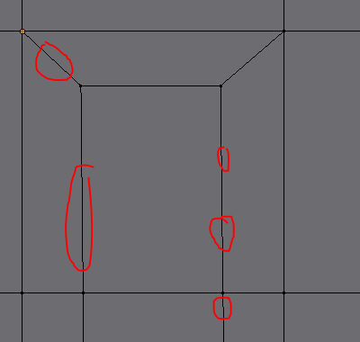

      When doing the exercise I noticed that some of the lines weren’t straight. I tried straightening some and found it very time consuming.
      At the end of it all, does it really matter if small details like those are not fixed?
      #58585
        Hi Jonathan, don’t worry about that; those lines actually are straight, this is due to the fact that a straight line that is not completely vertical or horizontal gets ‘split’ like this when drawn on the screen:
        In your Preferences there is a setting ‘smooth wires’ also the Anti-aliasing setting might influence the look of your edges:
        As far as Blender is concerned these line are straight, only we might see some ‘pixelation’.
        Some people prefer to un-check Smooth Wires, in order to get a visual clue when an edge is not completely horizontal/vertical.
        Again: an edge between two vertices is always straight!
