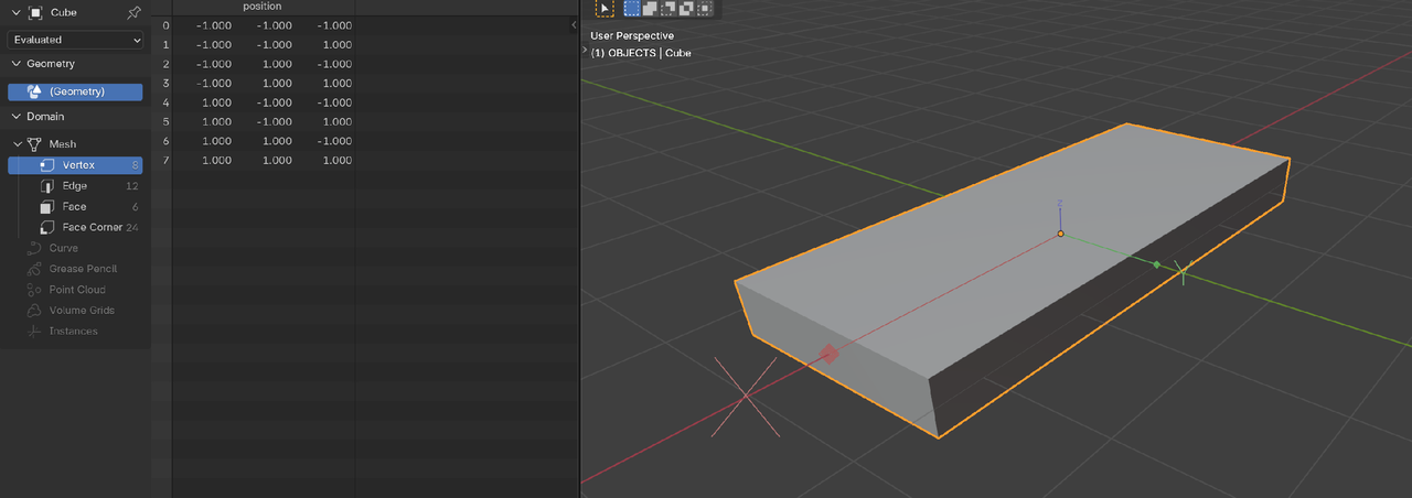

                  When you Scale a Mesh in Object Mode, you are Scaling the Object’s Coordinate System, the Vertices’ Postions in said Coordinate System do not change.
                  But if you don’t Apply the Scale and just keep going, you are working in a distorted Coordinate System, which causes all sorts of mayhem (1 unit in X might be different from 1 Unit in Y or Z):
                  #97862
                  Grady Pruitt
                    And if you start applying modifiers and or using certain tools like bevels, you’re going to get results that are confusing you because they’re not doing what you expected. Even better than scaling in object mode and then applying would be to scale in edit mode so you don’t have to.
                    Move locations and rotations in object mode, scale in edit mode as much as possible 😀
