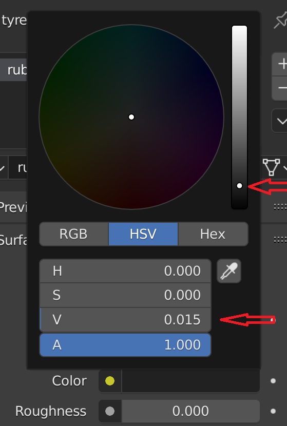

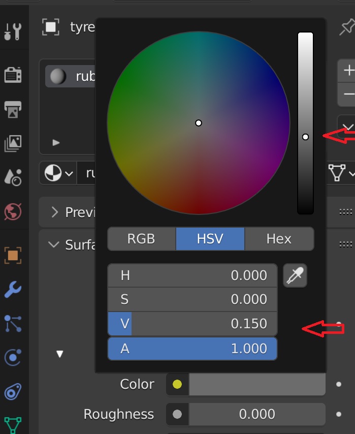

      I am using Blender 3 to follow your course.  Referring to your rubber material in “Shading from Observation”, when you use 0.15 value for the diffuse shader the grey is light.I need to use 0.015.
      My slide bar besides the color wheel is nonlinear?  Has the Blender 3 algorithm been changed or there is a setting in “Preferences…” that I can change scale?

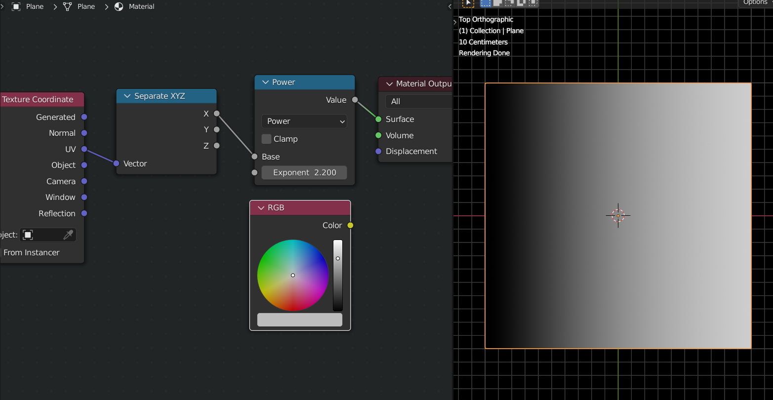

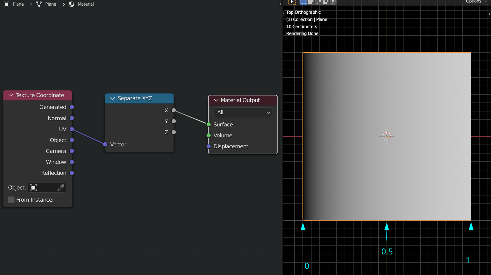

            Let me try this again. This is what a linear gradient from black to white looks like:\
            And the slider is adjusted to human vision and looks more like this:
            The RGB Node is set to a Value of 0.5.
            So, the colors Blender uses are linear (easier to do calculations with linear colors), but the slider is not.
