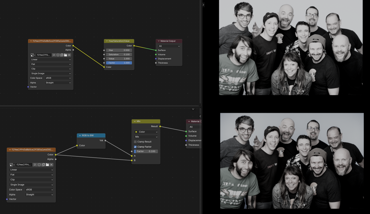

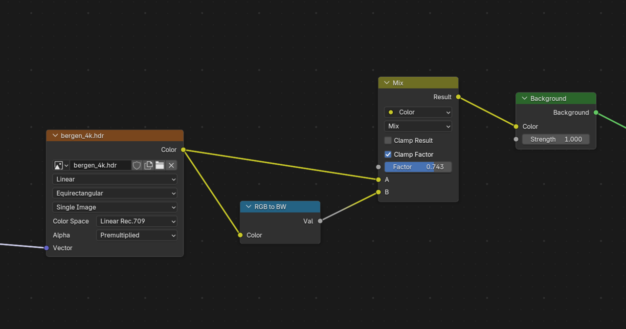

                  Here’s a pro tip:
                  Try desaturating like this:
                  Makes more of a difference with ‘normal’ images than with HDRIs, used for Lighting, but it looks less ‘washed out’. With HSV desaturation, completely different colors can start to look the same.
                  For instance:
                  #133741
                  Nathi Tappan
                    Nice! Thanks Martin! Great tip! Screenshot it so I don’t loose this one tomorrow!
