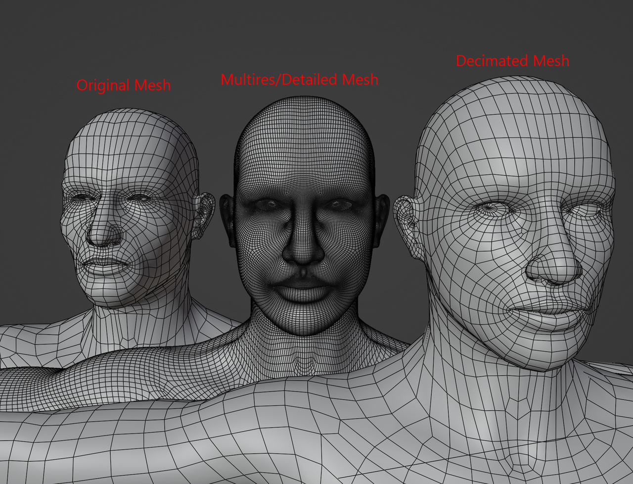

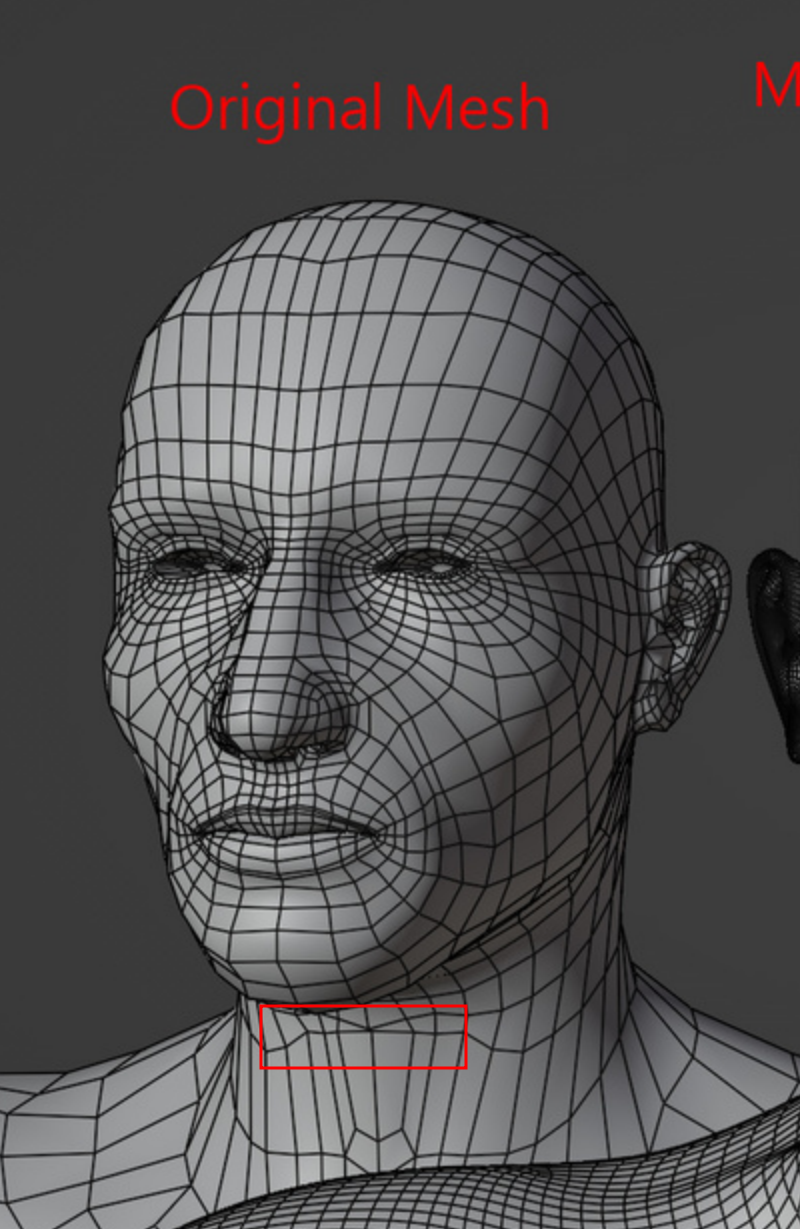

      So I am making a realistic human mesh and here in the first picture illustrates the original mesh with no modifiers. This mesh was a free human mesh that I imported from somewhere.

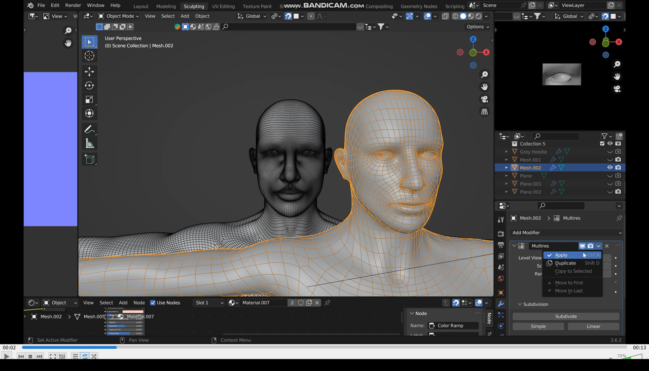

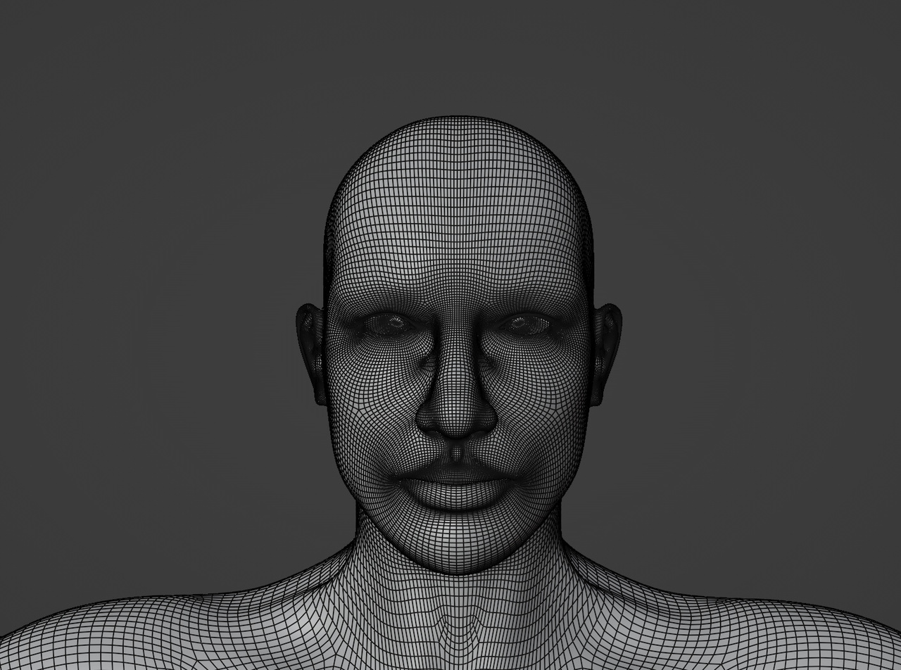

      I detailed his face through multiresolution using 2 subdivision counts to give him more facial definition to my liking. After that, I did apply the multiresolution, which means to me that I cannot revert back to the original faces and now I am stuck with more vertices/faces. I did this without planning ahead.

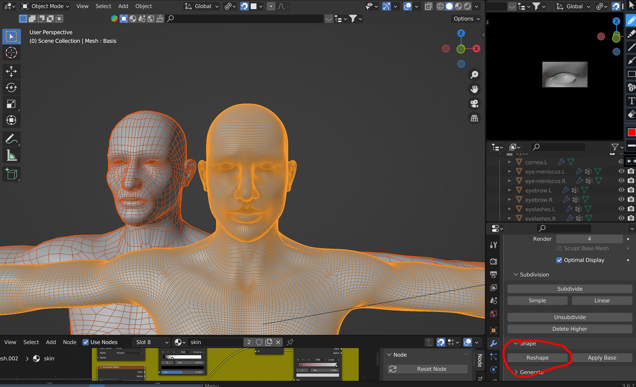

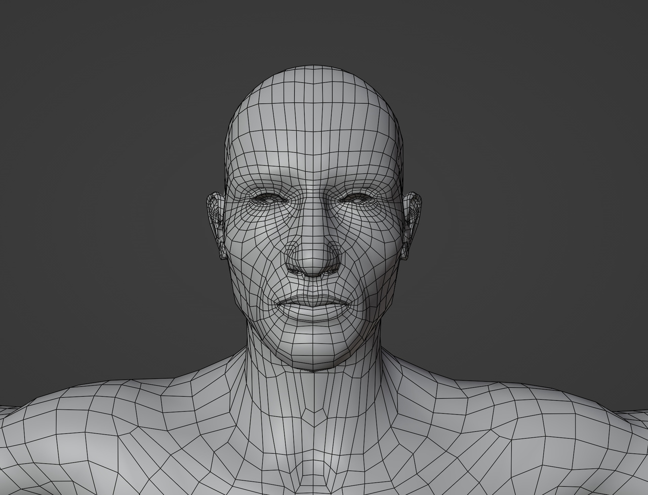

      As soon as I get into sculpting the skin through multiresolution, the max subdivision counts I can go up to is 4, and not 6. I am following the human course tutorial which the instructor would go up to 6 counts without any crashing when baking certain textures. When I bake certain textures, it crashes real bad and I believe it’s because this subdivided mesh I have right now is just too much by default. Like this many subdivisions is what I have for this new original mesh. I want to preserve the details of this new original mesh, so my goal was to re-import the original mesh and then transfer the new subdivided mesh onto the original through multiresolution ‘reshape’. So I added multiresolution on the original mesh with 2 subdivision counts so that the number of vertices match with the new mesh.
      It worked! Topology matches now. But…

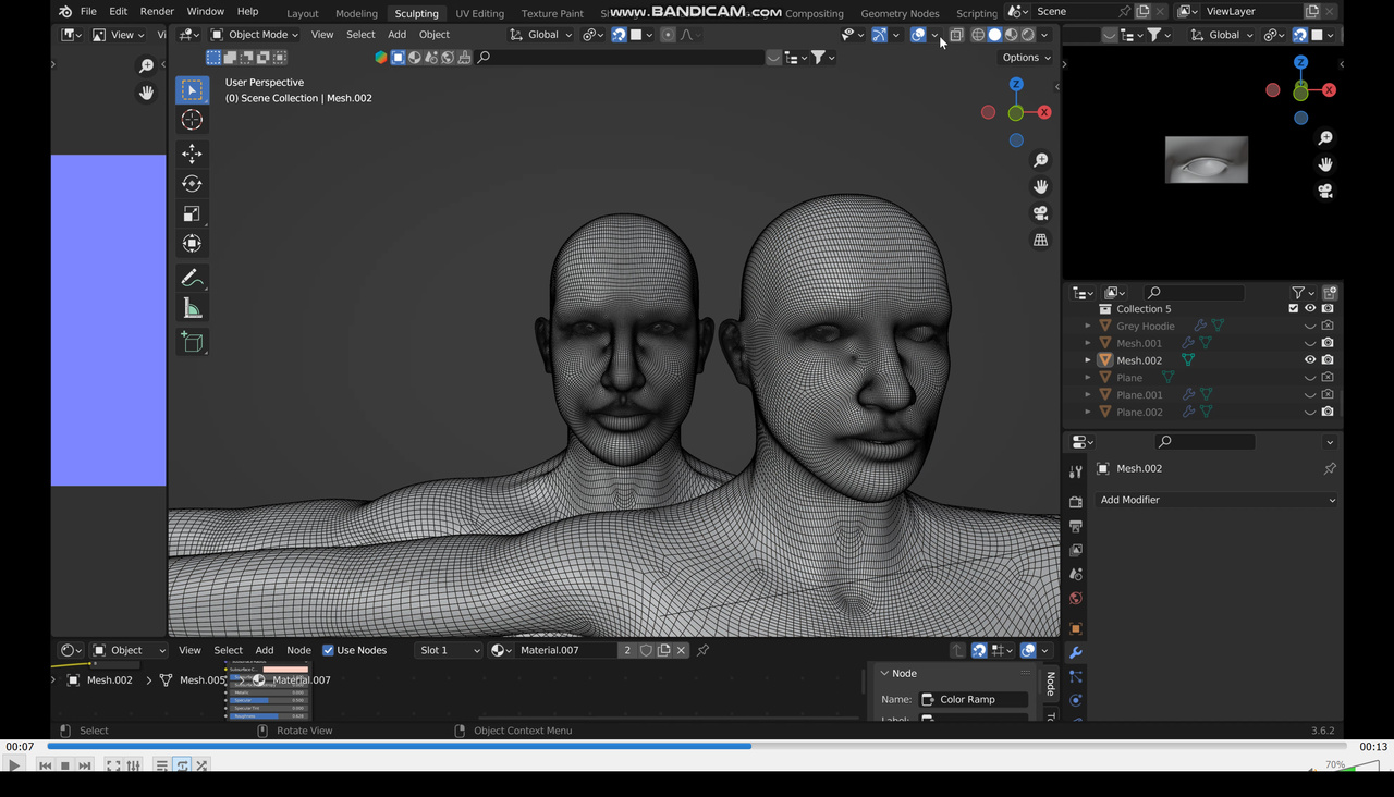

      … look at how clean the topology could possibly be now with the original mesh. I have the wireframe toggle on. Although, I am aware that the original mesh has a 2 subdivision counts in multiresolution – if I disable the multiresolution modifier – it will return back to its choppy mesh (which is the original yes). There is nothing wrong with that of course and I know this is the way Blender works – but now I’m wondering if there is a possible way I can do a retopo with the mesh being a lot cleaner with less faces – also retaining the facial features without having to start a new plane and adding faces over the mesh?

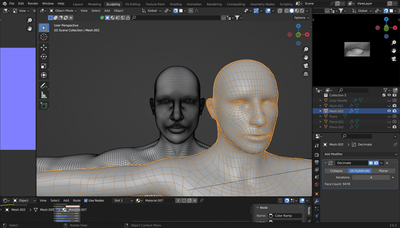

      So my idea was maybe I can make a copy of the new subdivided mesh and then decimate it!
      NOTE: I decimated with 4 counts, seeing if it would look like the same number of faces with the original mesh.

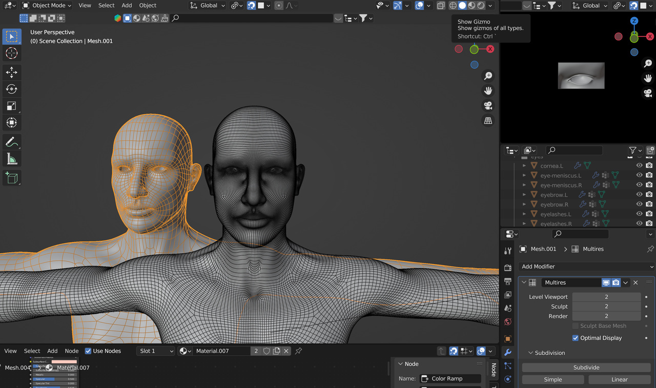

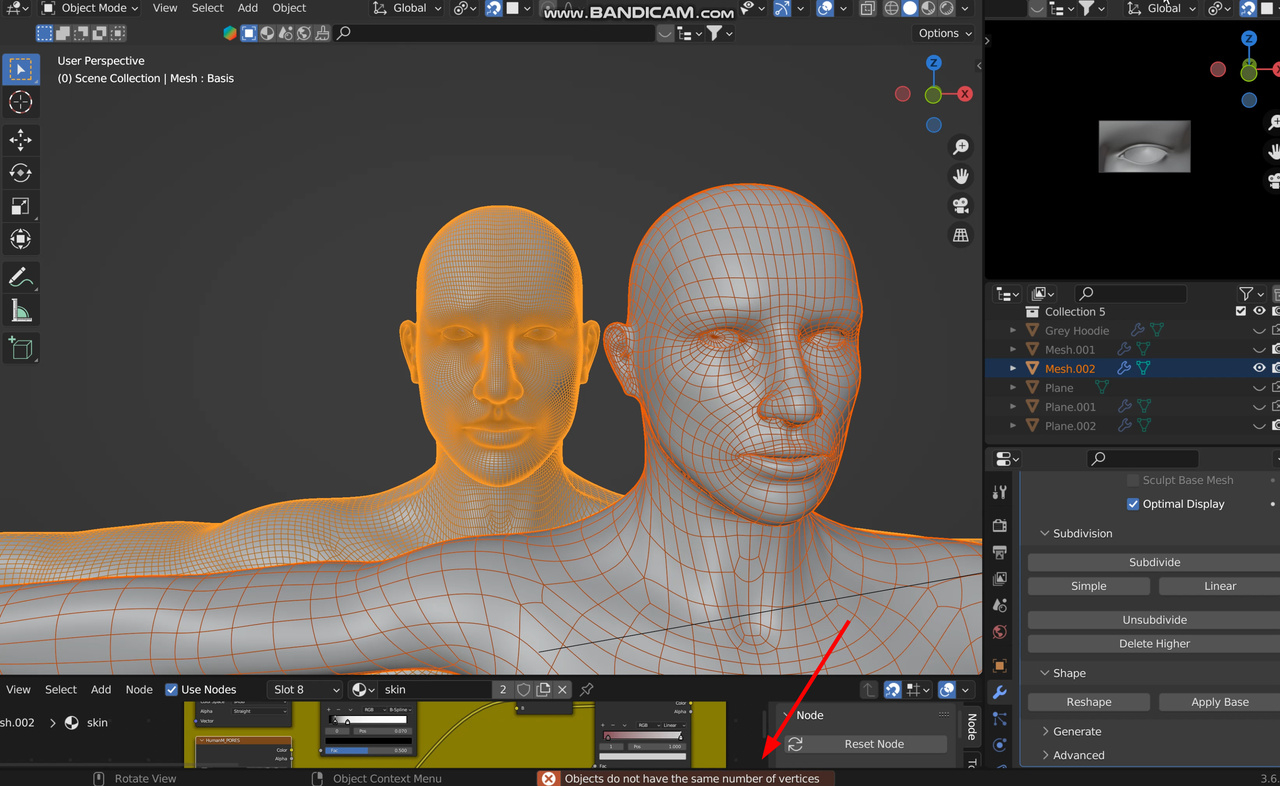

      Although this would compromise some details – so maybe I can also do the same process where I can transfer the new subdivided mesh to this decimated mesh through multiresolution ‘reshape’ key.

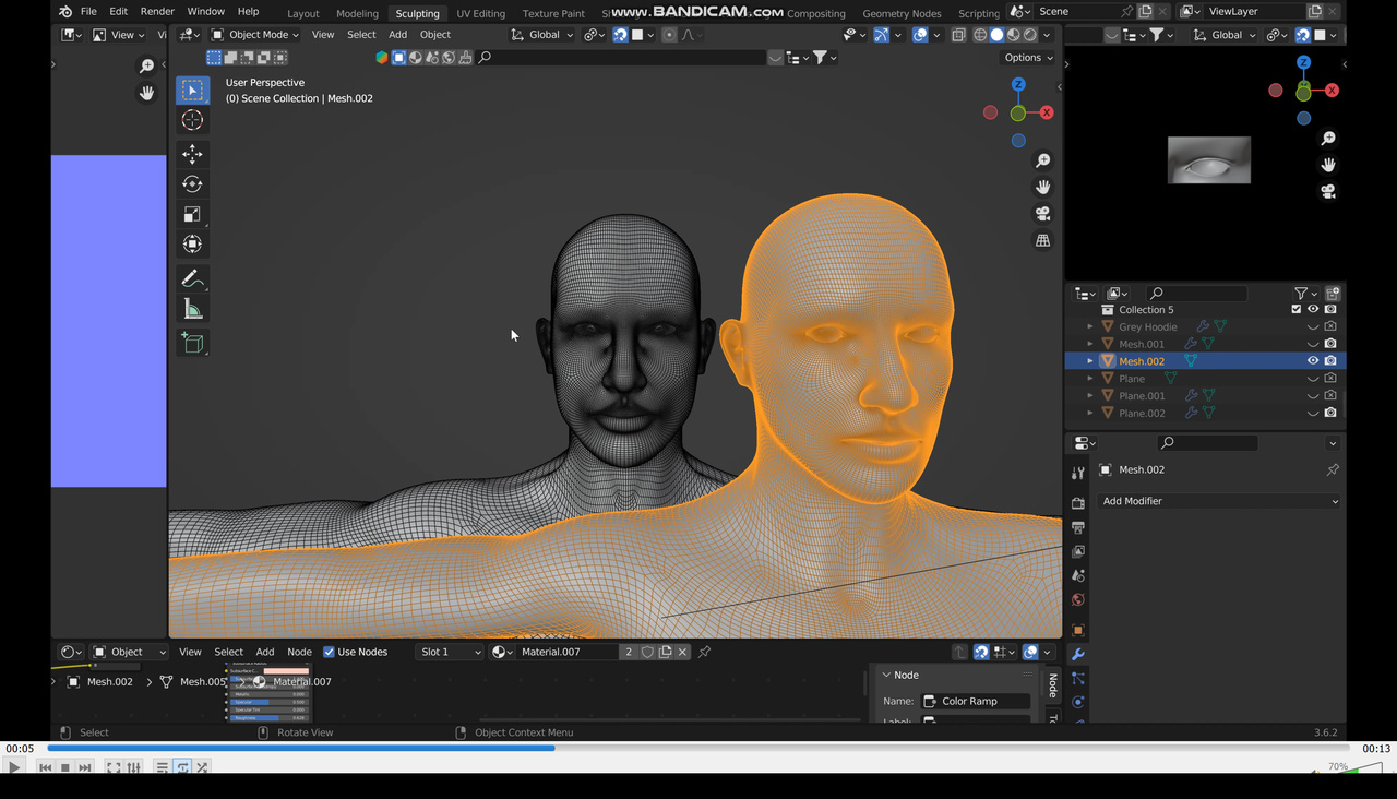

      Things always go funky after using the decimate modifier. The decimated mesh had multiresolution with 2 subdivision counts and it should’ve been matching the same number of faces as the subdivided mesh. Here’s proof that it should’ve been the same.
      -10 03-36-52-207.jpg-10 03-36-57-882.jpg-10 03-37-05-850.jpg-10 03-38-26-247.jpg

        But then you thought hmmm, what if I can make it even better with less topology, let me add a decimate modifier an try to retopo on it. But with the decimate the face count doesn’t match so now you can’t transfer with the reshape. So that is a dead end, that wont work.

            I am not an expert on the Decimate Modifier, but I would guess, that Subdividing Triangles (which automatically makes them into Quads) and then un-subdividing, might sometimes go wrong and your Original Mesh has a weird situation in the red rectangle:
            That looks like an error, (maybe from Importing…two Vertices that were close got accidentally Merged?); there is absolutely no reason for those Triangles.
            And I think those (perhaps among others) cause the Vertex count mismatch.
