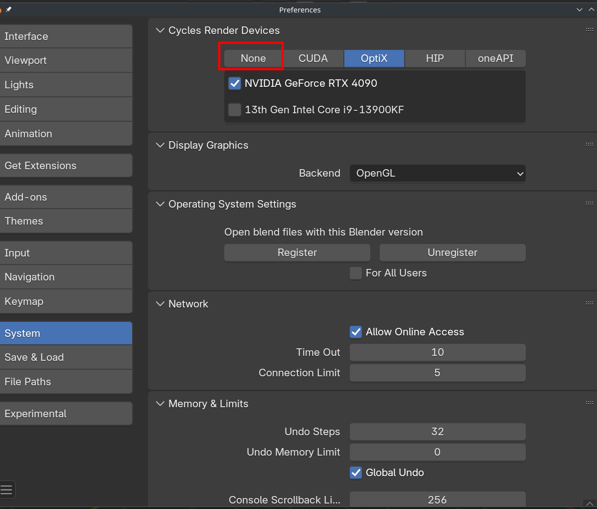

            Hi Stas @Jollium ,
            Make sure that your Cycles Rendering device is set in your Preferences:

            Stas Dushko
              Literaly nothing on the screenshot is avalible for me.

                #95591
                  It should not be set to None (that’s why I drew the red rectangle around it).
                  You probably have different Options, because you have a different GPU.

                  Stas Dushko
                    Martin, nothing is avalible for me. None of the options. I deselected none, others dont work. They all say different reasons on why, but they just dont.  When I press them – there is a checkbox to, well, turn them on – and it is greyed out
