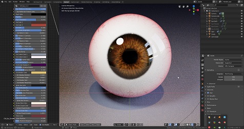

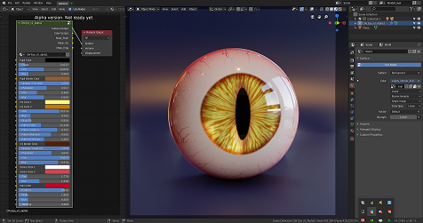

      The blender files that comes with the purchase (to demonstrate it’s capabilities ) work fine individually:

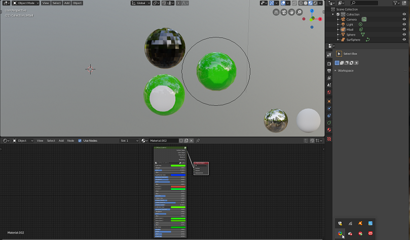

      To demontrate my problem, I created an entirely new project, and created 3 different spheres in it (metaball, surface sphere, uv sphere) just in case my problem was linked to that.
      If I Link (or Append, I tested both) the blender file containing the CW_eye_v2 (the one that generates the awesome looking cat eye above), and then add that as a material to each of these spheres, here’s what I get with Cycles rendering using the GPU (CPU is the same, but slower) :
      As you can see… it’s not exactly giving the same kind of appearance as I was expecting.
      I played around with the parameters, but the default appearance when adding the Group node CW_Eye_v2 is basically the bottom sphere with slightly different colors.
      I was wondering if anyone had any ideas why this doesn’t work ?

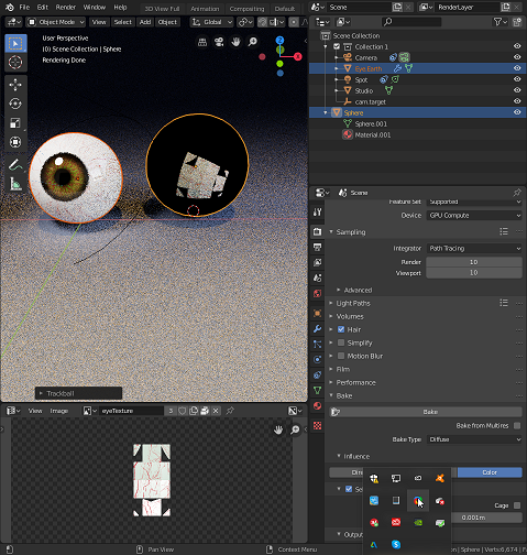

      As a separate attempt at using the material, I followed a guide by the materials creator (attached youtube video), but whenever I baked the texture I only got this on the UV sphere:
      I’ve tried looking around, but can’t find any explanation for that either.

        After some back and forth with the creator, we determined that the problem was due to the way I was attempting both the bakeing of the texture, and the import.
        It turns out instead of appending the material from the external file and choosing it, I was trying to implement it as part of a pre-existing shaders base color (I AM pretty new to all this).
        The correct procedure is to Append the CW eye material, and then choose it as the new material itself:
        The baking issue was due to me not having understood that the object one bakes to has to be superposed with the object itself !
