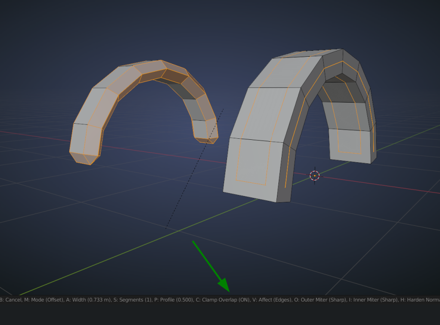

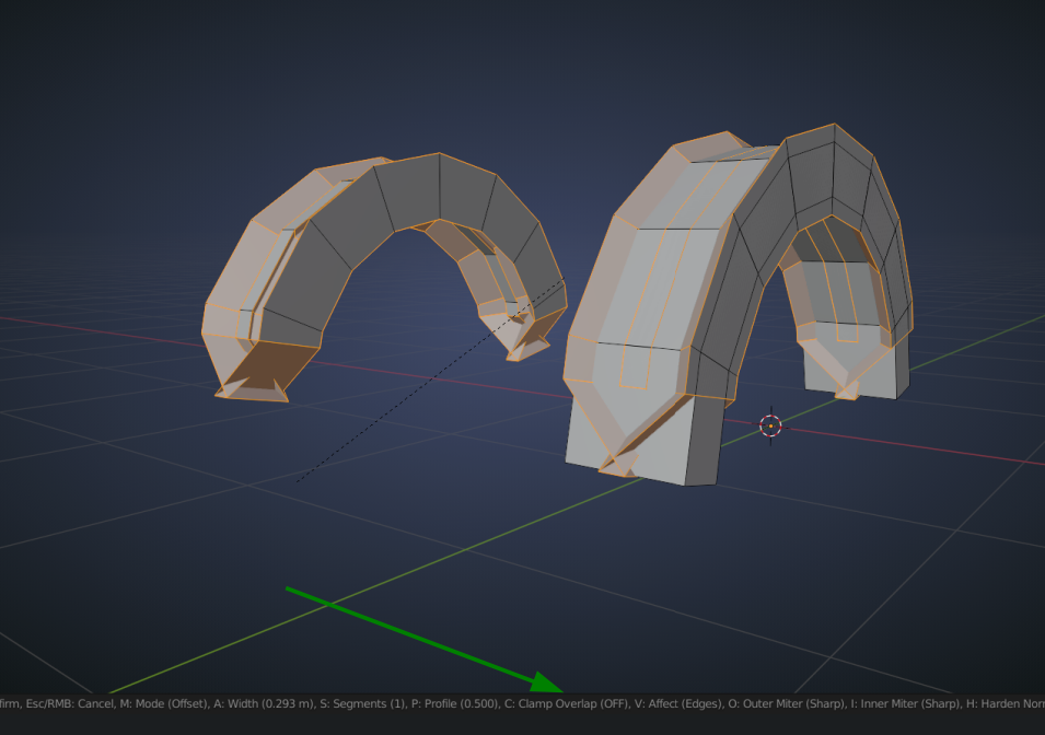

              @wendy10698 here’s a comparison without Clamping (right with double Mesh…’original’ band stays untouched):
              and with Clamping, it just stops Beveling when two Edges meet:
