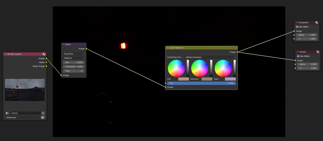

      I was working on a 3D environment creating a stormy ocean environment and I once I was finished, it was time to render…I rendered it in Cycles instead of eve which took over 7-8 hours only for this to happened. 3D Environment: Stormy Ocean

        Well  patrick,
        That appears to be the work of your Color Balance Node:
        #81587
          …and it’s 400 Frames!
          Even with 1 minute per Frame, you’re looking at 400 minutes, or 6 hours and 40 minutes.

            #81589
              Hi Patrick,
              You can certainly use a Color Balance Node, but your Settings are too extreme at the moment (don’t forget to plug it in the Viewer Node as well as the Composite!).
              Render one Frame, to see if it’s okay. You can also get an idea about the total Render Time this way.
              Animations always take a long time to Render…the less Frames, the shorter the total Render time.
