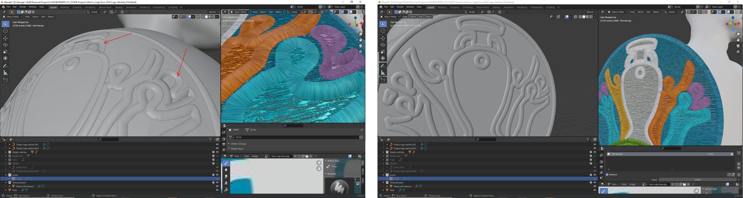

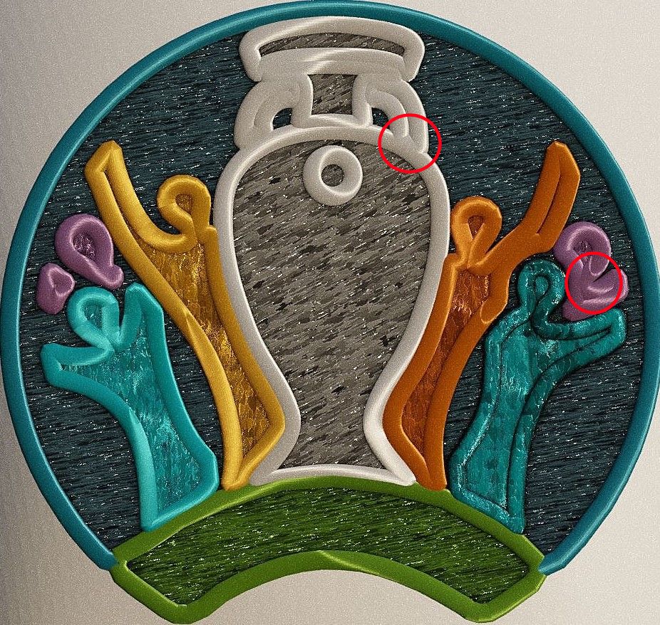

      I have noticed that 2 of my stitches form the oposide way around when I apply the whole patch onto the arm of the model. I have tried separating the wrong stich pattenr and invert it, hoping that that woudl help.
      I could re-do the 2 stiches that came out wrong, but I would like to know why this is happening so I understand it better.
      when they are in flat form, they all look great. it is only when I start deforming them, that is when I get the issue.
      thank you in advance.
      #69362

          Have you checked your normals? If you have flipped normals on those stitches they will flip to align with the target mesh when deforming.

            @adrian2301 yes, I have checked them and they’re OK

              I looked at the image posted in the gallery, it looks like you have some intersecting geometry issues which may be the cause of the problem. You may just need to move some verts around.
              Did you use curves converted to mesh objects? A slightly higher resolution on the curve may of helped on those sharper turns like on the purple piece.

                I will try that. on the other hand pretty much all the stitches overlap each other, so I didn’t think that would cause any issues.

                  Yeah I wouldn’t of thought so either, but may be worth moving verts  around a little and see if it helps.
