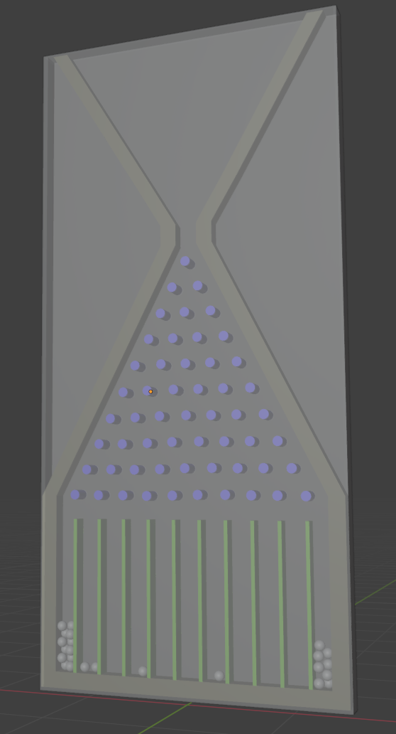

      Tried everything but the balls keep bouncing to the side(smaller pegs, bigger pegs, different thickness for the spokes, shape of the whole thing, big beads, small beads, nothing helps)
      I mean im ok with it, watching the sim come to life is still pretty neat!

        Get ride of the top peg. Then you’ll get more slots.

          Hi @nougat time ,
          That is because of the placement of the pegs.
          If a ball hits a peg, it should have an equal chance of going left or right. In order to do that, the ball needs to hit the peg ‘centered’. When it hits the first pin, that is the case, but, suppose it then goes (screen) left, the chance that it hits the second pin so, that it goes right is very unlikely:
          It will just keep hitting the pins on the same side, therefor most of the balls end up on the outside.
          Here’s a ‘working’ one:  https://cgcookie.com/projects/galton-board

            yup! that really is how it happened!it just kept bouncing off the left or right side…
            thanks for the swift reply!
