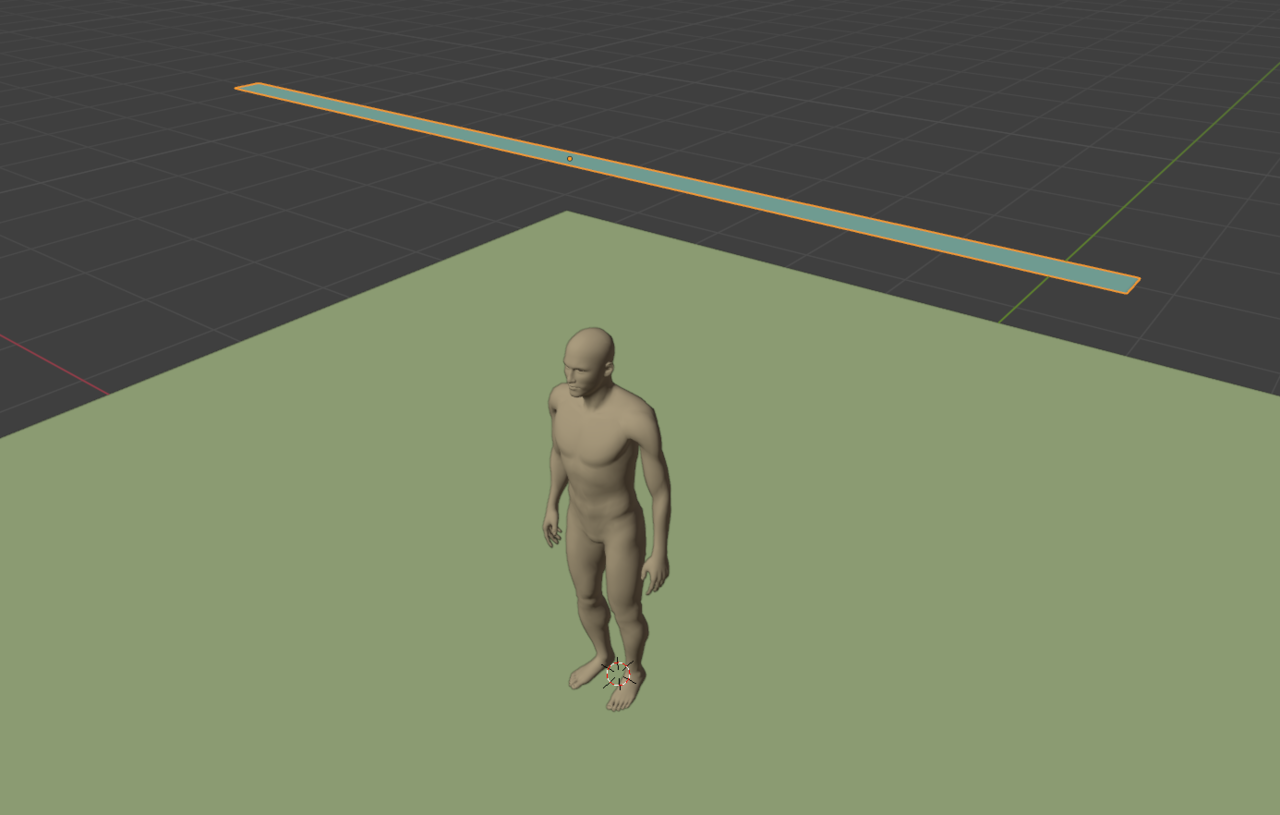

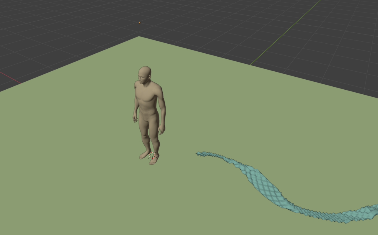

      Andy Kynerd
        Here are a couple of screenshots of the scene described above:

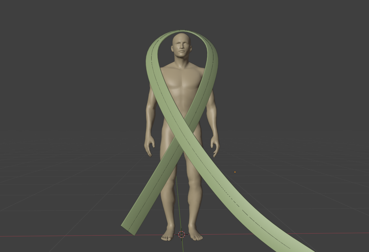

                  Andy Kynerd
                    I haven’t completed this physics course yet, but I did follow along with all of the clothes physics videos. I do get what coyo is saying, and the larger point about getting exact behavior in terms of physics in general. I played with it some more today and tried animating an object along a path, so instead of having the sash float down, it comes into the frame from the bottom and arcs up around the neck and then crosses over on its way back down. This works and it looks pretty good, but my goal here is to make this look like ribbon rather than a strip of hard-edged material. I wonder if I could take what I have here and add some sort of dynamic or “fluid” displacement that would give it some fabric feel without all the actual physics. I really don’t need a lot for the look I’m after. This also got me wondering about geometry nodes, which is really interesting to consider in terms of procedural possibilities. It would be really cool to be able to adjust the parameters of your fabric style, length, width, etc. nondestructively. But, that’s a whole other area of fundamentals I’m only barely getting acquainted with …

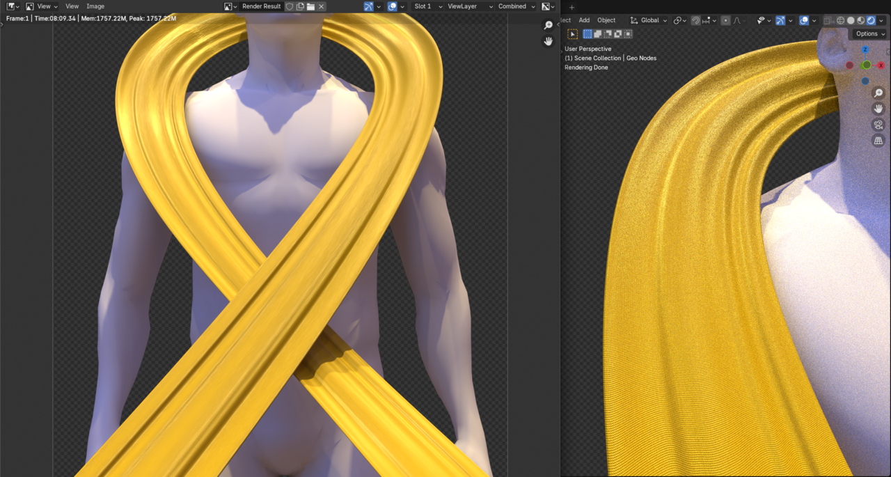

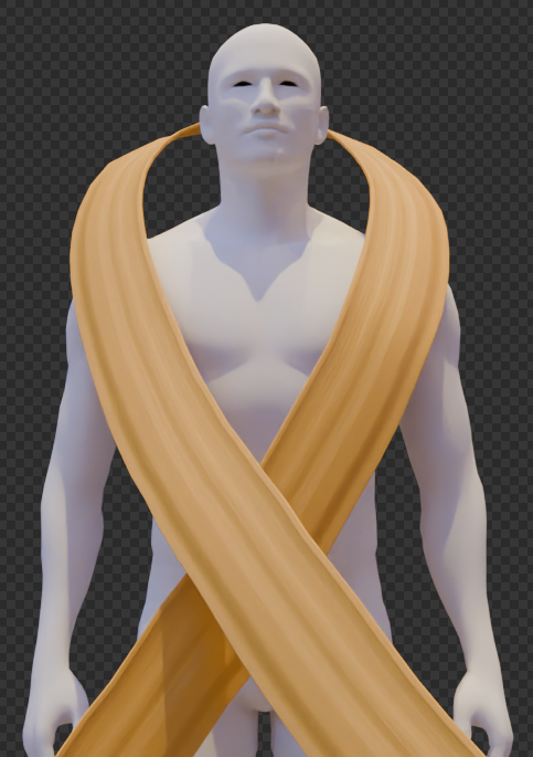

                        Andy Kynerd
                          Here’s an update, at hour fift – oh nevermind – where I think I have it a bit more believable looking – though, if I were nitpicking I would do something about the edges of the ribbon to make them look more finished. I still haven’t figured out how to build the mesh for the ribbon procedurally and have it instance along the animation path (curve). I realize I’ve gone off the rails and this is off-topic for where I originally posted, so thanks for hanging with me 😉

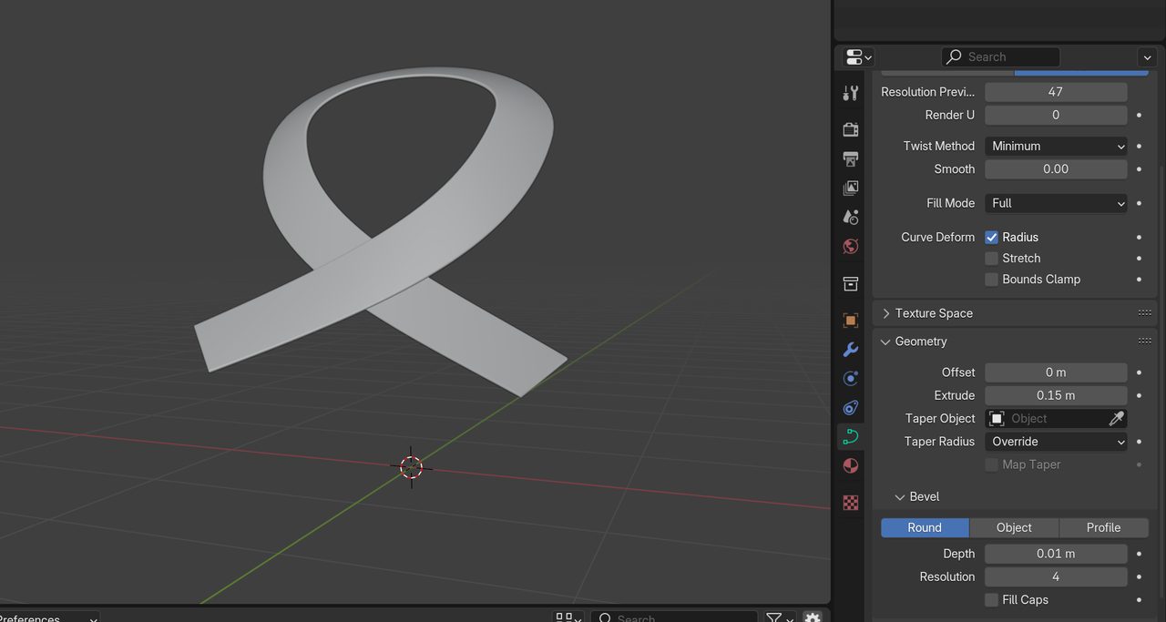

                          #88829
                            Hi @AhtfulDodja ,
                            ” I still haven’t figured out how to build the mesh for the ribbon procedurally and have it instance along the animation path (curve).”
                            You do know that you can Extrude  (and Bevel) Curves, right?
                            In Curve Edit Mode, you can adjust the Tilt of the Control Points as needed.

                            Andy Kynerd
                              Thanks, Martin! I haven’t done a lot with curves but yeah, I’m learning more every day. Right now I’m using a spiral curve, which I don’t know a lot about but it’s nice that I can just move the individual points around (while adjusting scale and tilt), without fiddling with bezier handles. I’ve made some progress with creating this procedurally using geometry nodes, but now I can’t figure out why my scene render looks so different from my render preview. The fabric texture looks pretty good to me in preview, but then it just looks muddy in the render — again, almost painted or wooden. Obviously there are a ton of factors that can figure into that, so I’m just bumbling my way through troubleshooting the overall look. That’s nothing to say of actually animating the geometry, which I’ve yet to figure out.

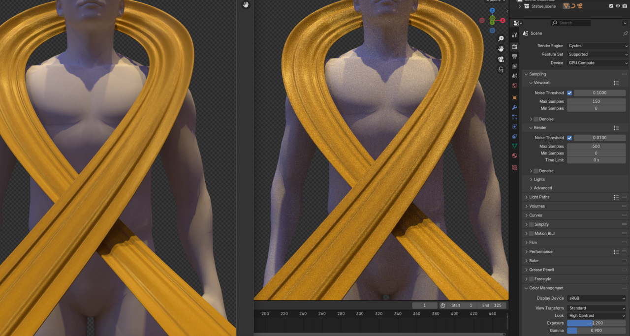

                              #88831
                                Are you using denoise? It typically wipes out the texture details if you’re not careful.
                                #88832
                                Andy Kynerd
                                  I’ve tried it with and without. Here’s a look at my setting with denoise turned off. Maybe it does help some. I also tried upping the samples to 1500 at one point but that didn’t seem to make any reasonable difference. I really liked where I got with the texture in preview but I guess at the end of the day the texture detail might not actually matter that much, if the plan is to animate the ribbon and the camera focus will never be closer than this in the final scene.
