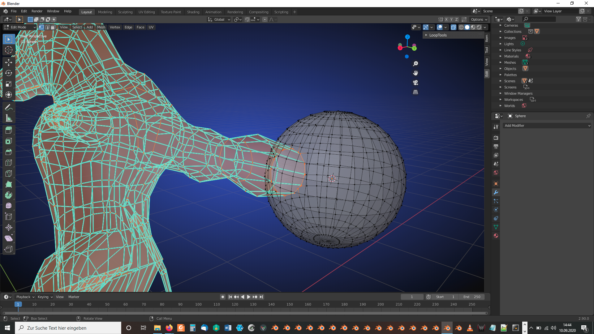

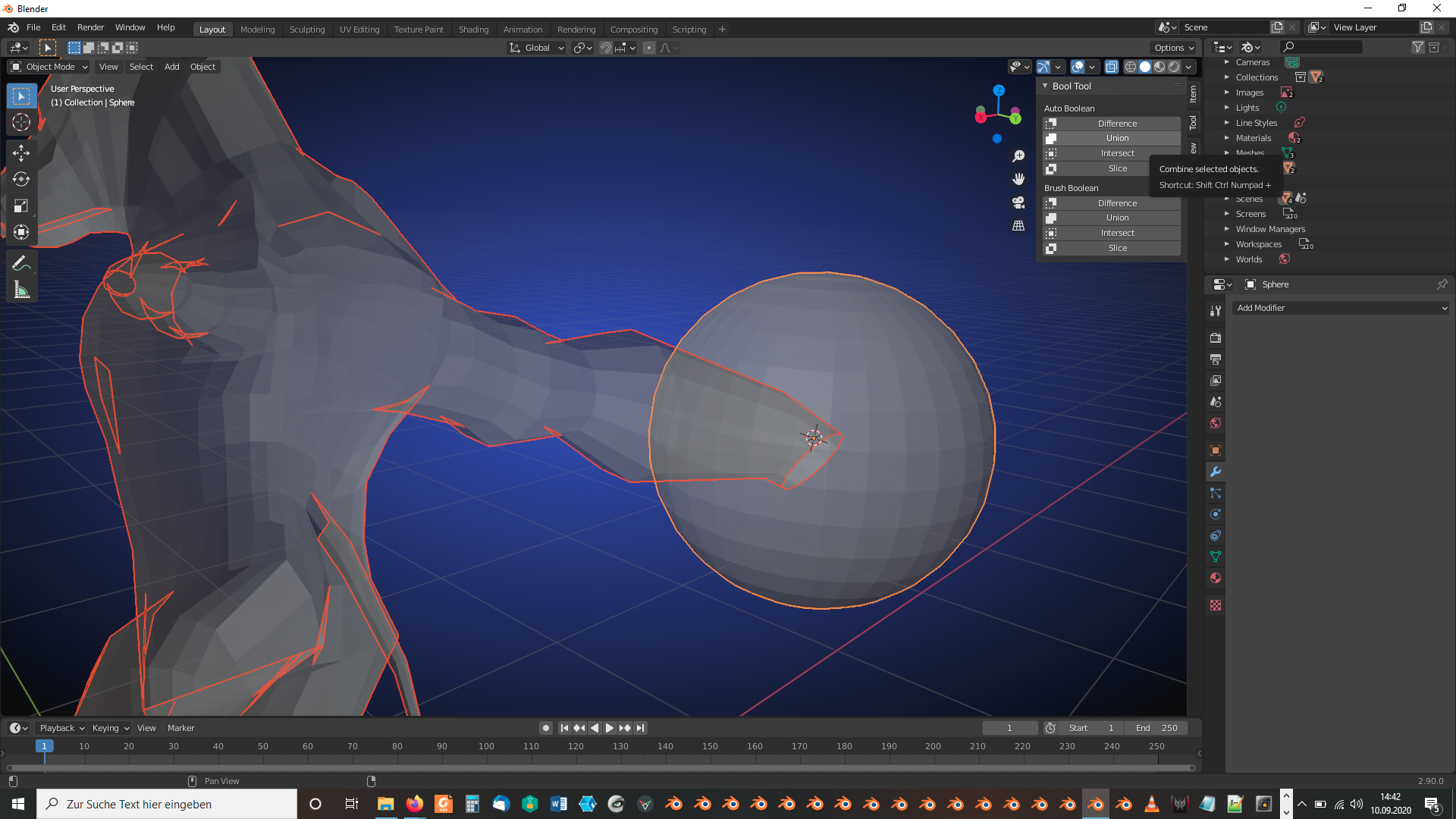

        You could use the “Bool Tool” which is integrated in Blender but has to be activated in Blender’s “Preferences”:
        Select the meshes which you want to join in   “Object Mode”   and press in the   “Properties Panel” ‘s   “Edit Tab”   under   “Boolean Tool” => “Auto Boolean” the “Union” button. This joins the meshes (applying all modifiers on the choosen objects) under the name of the object which you selected last:

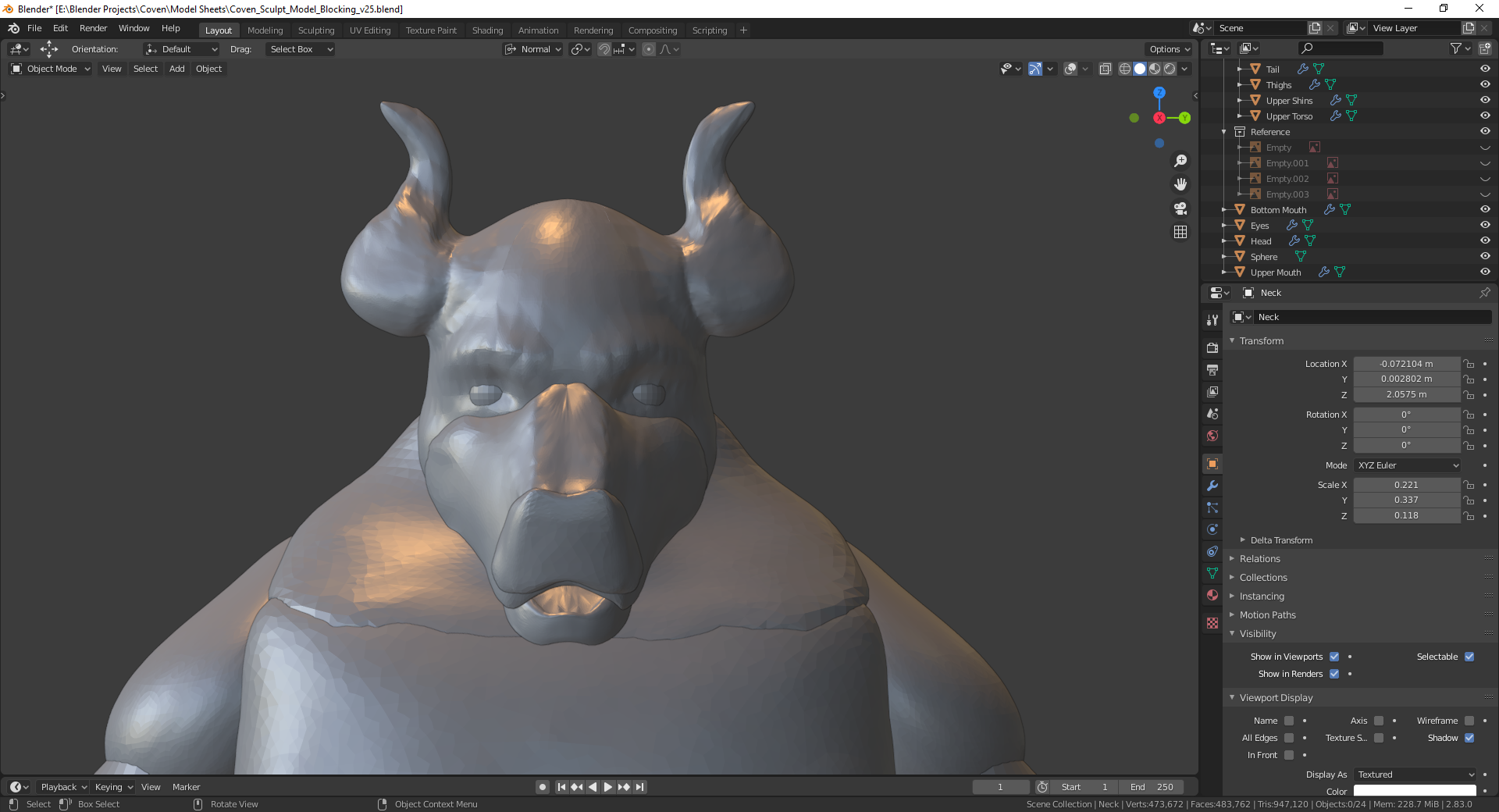

              Which objects are randomly disappearing? Do you have a screenshot? I’ve tried it joining everything with the “Upper Torso”:
              Maybe, it’s the modifiers that are causing trouble. Select all parts and select in “Object Mode” under “Object” => “Convert to”  the entry “Mesh from Curve/Meta/Surf/Text” which is an easy way to collapse the modifier stacks on all selected objects:
              If “Bool Tool” still doesn’t work for you, you can now join the parts manually with CTRL + J under the name of the part selected last.:
              The “Lower Torso” front looks now transparent which indicates an incorrect face normals orientation pointing inside the mesh instead of outside:
              Tab into “Edit Mode”, select everything and recalculate the normals outside with SHIFT + N so that it looks in “Object Mode” with “Face Orientation” overlay like this:
              In “Sculpt Mode” (after saving your current version) press the “Remesh” button in the “Remesh” dropdown menu:
              If the newly created mesh is too coarse for you, repeat the same with a smaller “Voxel Size” using your saved version from the previous step or after undoing the remeshing. The mesh with the default settings should now look like this:
              A voxel size of 0.025m should provide enough detail without risking extremely long calculations:

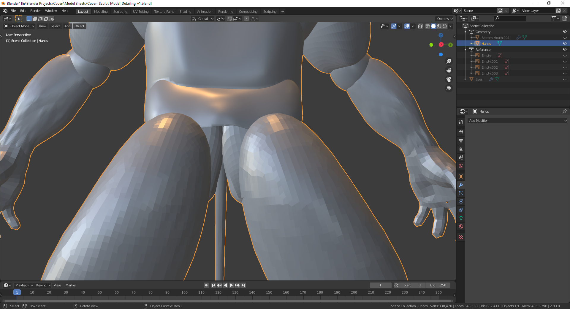

                So, as far as what usually went missing: it was either the Lower Mouth or the Groin (as seen below).
                I will follow your advice above and see where I get.

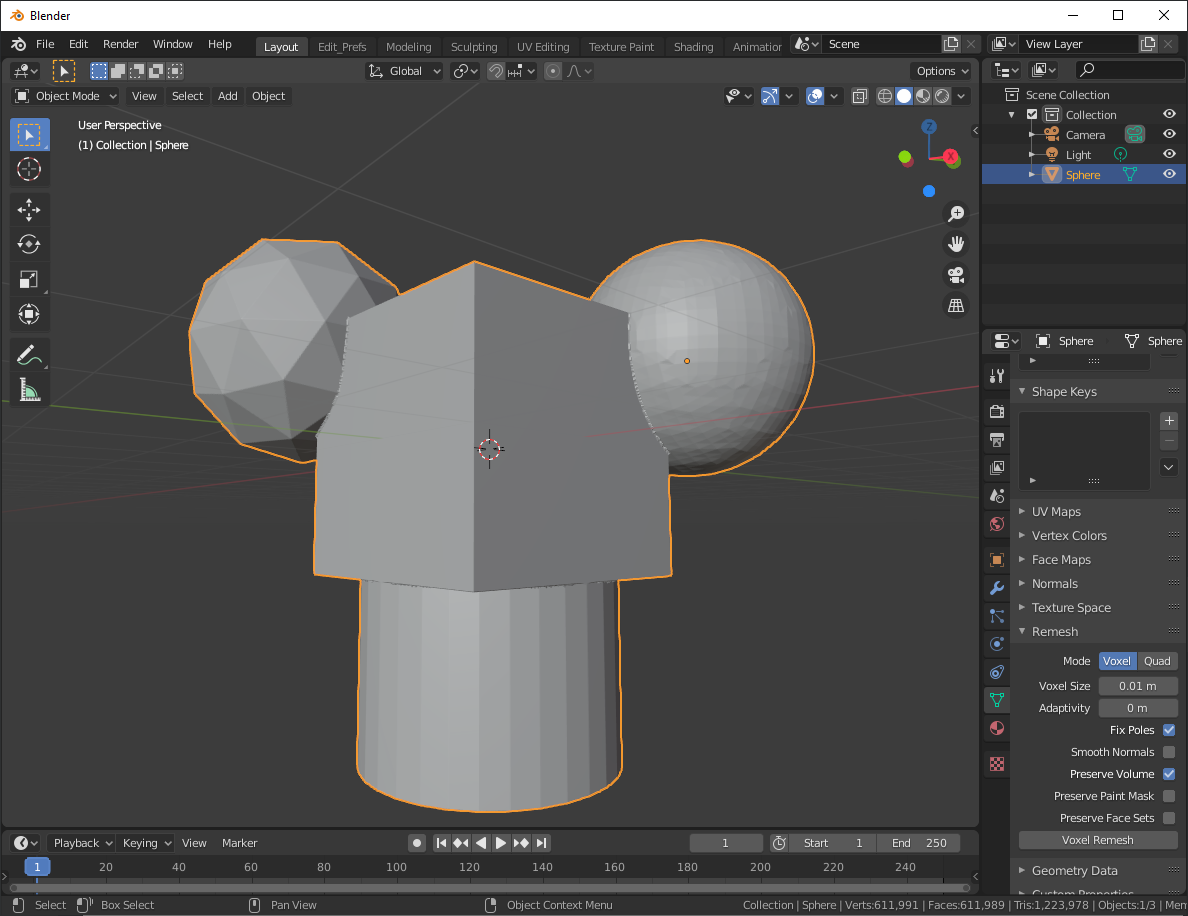

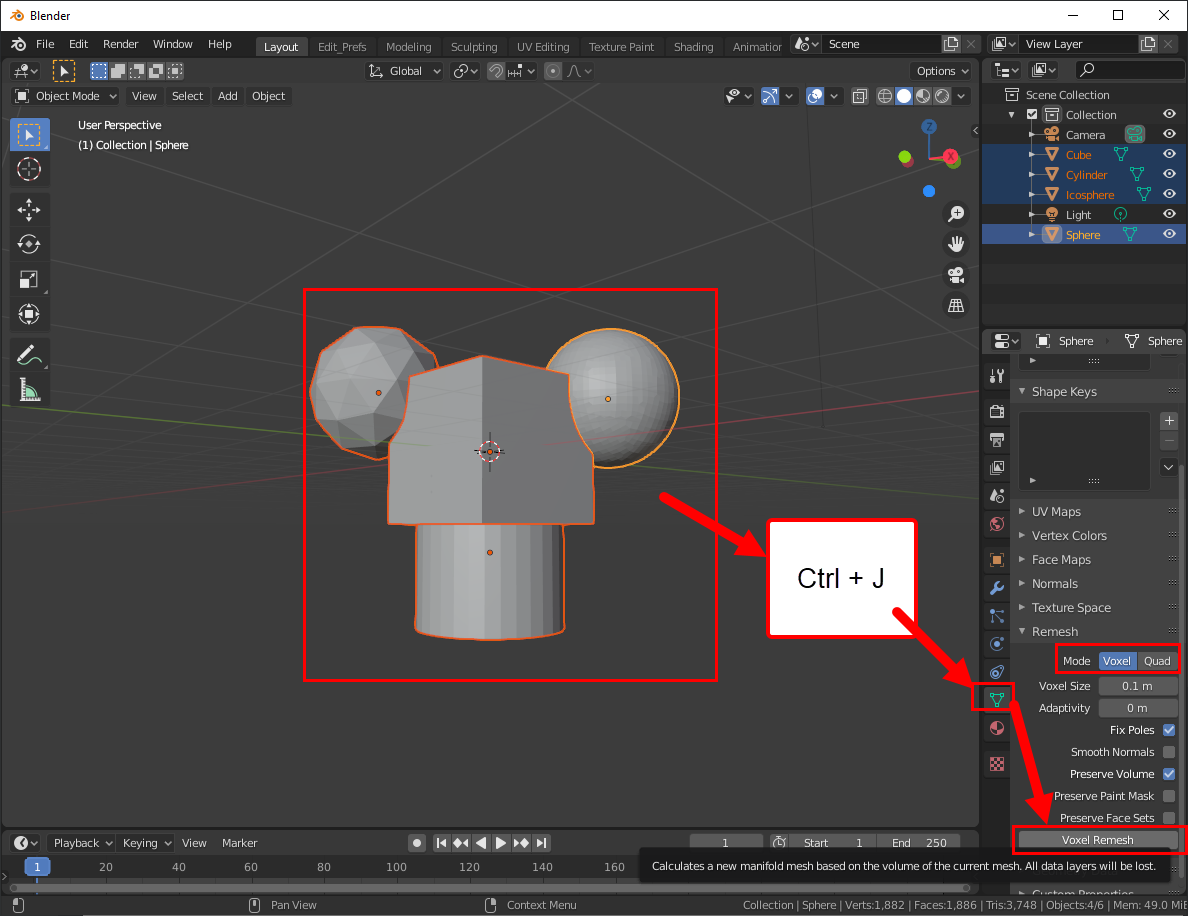

                    @cjolson The remesher also joins multiple objects together super easy but you may lose topology detail (you can adjust remeshed resolution though. You can join all objects together with Ctrl + J and then go to the Object Data Properties and you have the remesh menu to make use of:
                    #59750
                    Shawn Blanch
                      This is a remesh with 0.1m voxel size. Looks pretty dang close (granted the topology is going to need some retopo if you plan on using a UV map)
