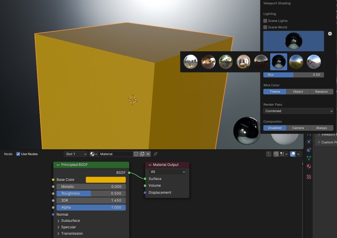

      Why are my colors different? in the properties of the materials it is a color and when it is applied the color is a different tone
      #84025
        Could you elaborate on that a bit? Maybe add some screenshots as well…

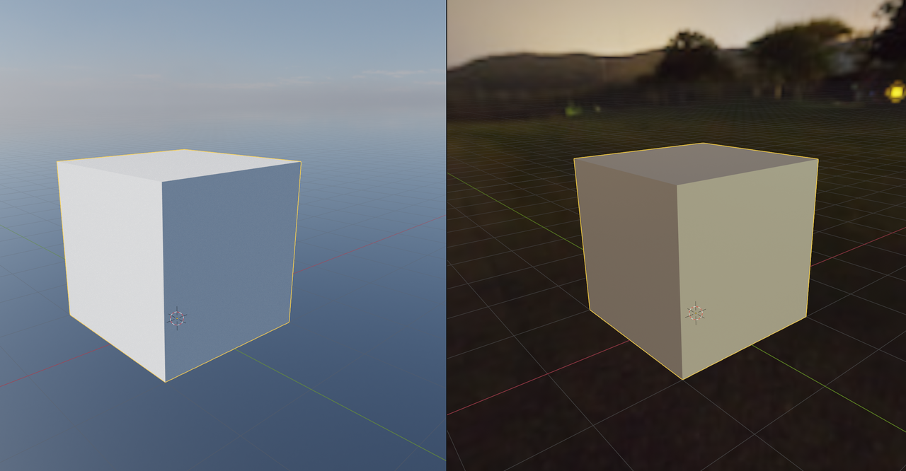

          …a lot also depends on the lighting.
          Here is the same Cube, with the same Material, in different lighting:
          #84027
          Ionut Horju
            #84028
            Ionut Horju
              Is like the tones off yelow are not the same

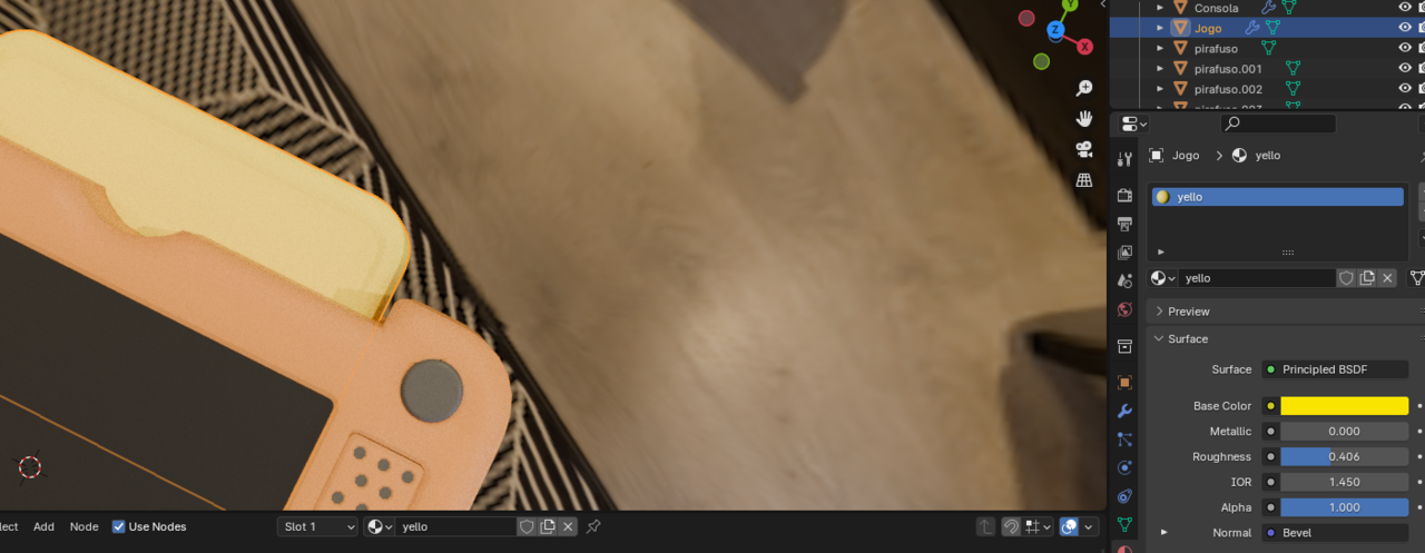

              Ionut Horju
                #84030
                Ionut Horju
                  the ajust panel lock more bright than the console even tho the brightness is max
                  #84031
                    Yeah sure.
                    What I told you.
                    There is a difference between the Base Color of a Material and the way it looks when lit.

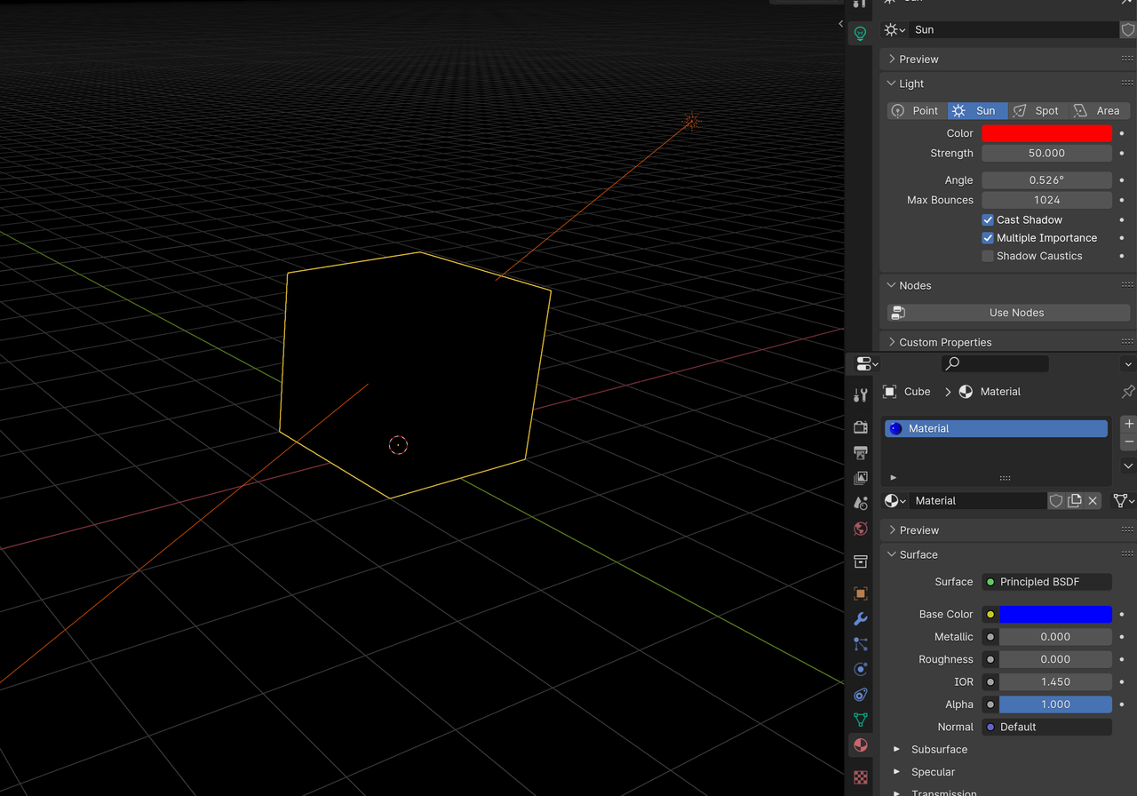

                    The (Base) Color is what colors of the light are being reflected of the Surface. Here’s a fun one, a pure blue Cube, lit only by a pure red light:
                    The other parts of the (Principled or other) Shader tell how light is being reflected.
                    The behavior of light is complicated…luckily, you don’t have to learn all about it to make beautiful renders.

                      You can always go for a more neutral light like this one if the color shift is too distracting for you.
