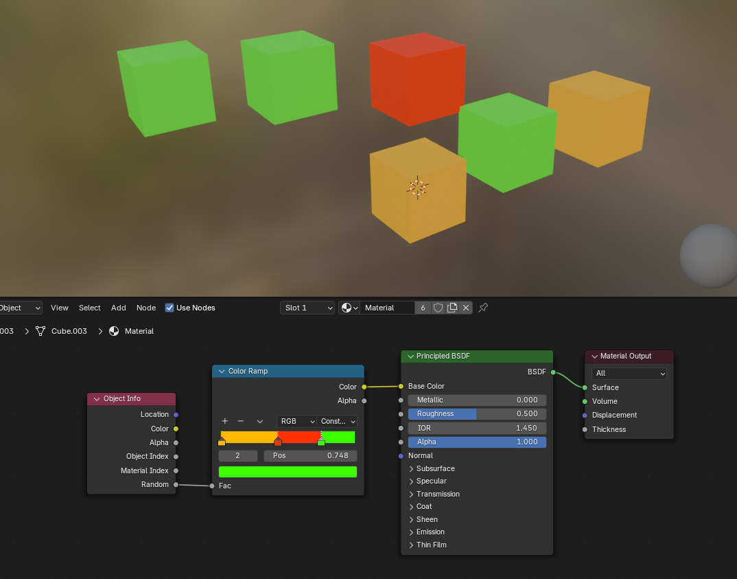

                        #89701
                          You could built that into your shader. Something like this:
                          With each new instance it’ll assign a random color of your choosing. I can get more complicated than that, but a simple set up should be enough.
                          #89702
                          scottfassett
                            Hi Omar and Dwayne,
                            Thanks for your suggestions. I tried Omar’s approach, but couldn’t figure out how to change the color, other than sliding the Color Ramp sliders around, but then there are only three options there. I imagine I could create more color ramp slots, but is that the way it’s supposed to work?

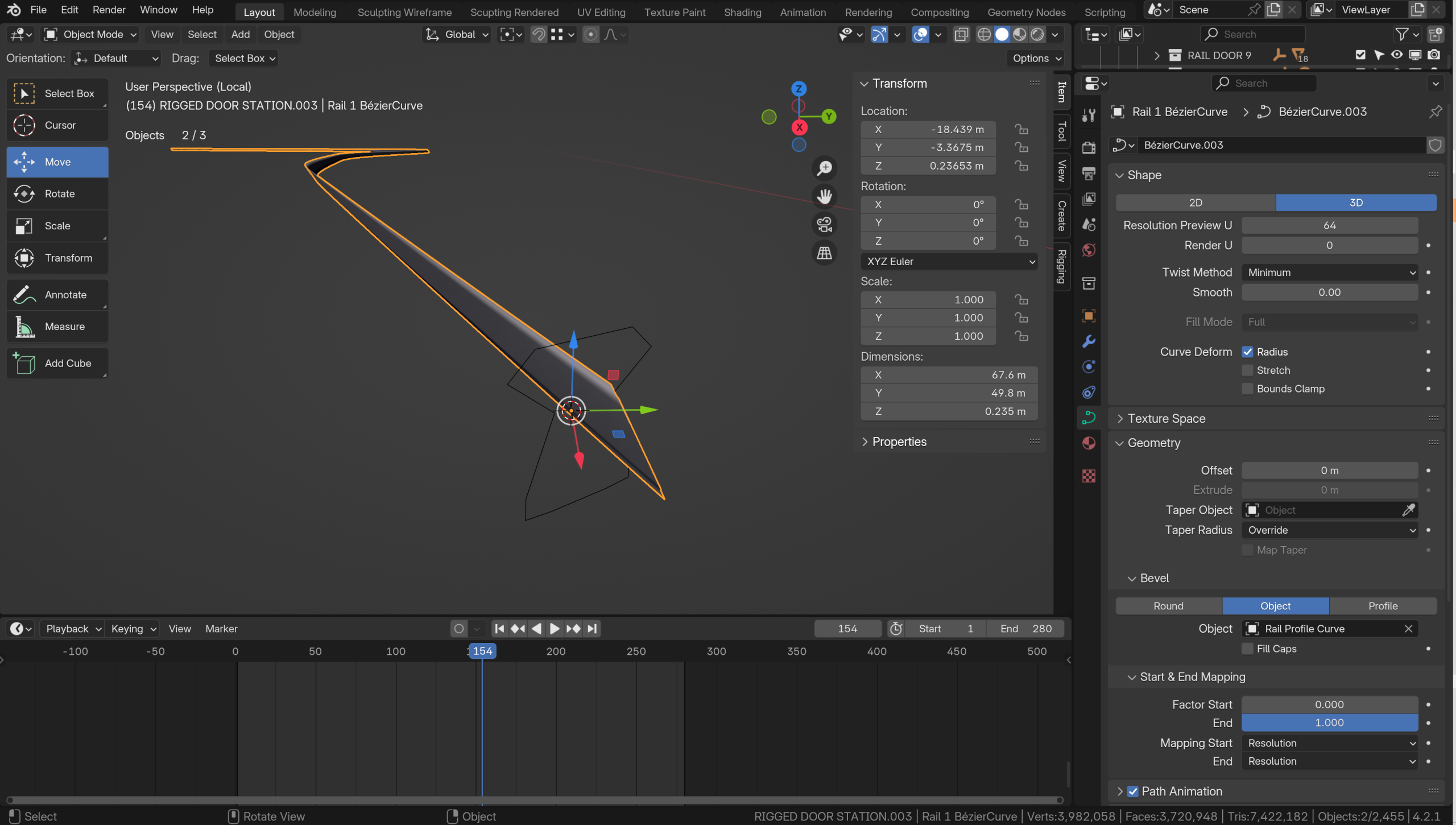

                                  I have one more question for you that’s not related at all. I’m trying to do a simple Bevel extrusion using a Bezier curve and a profile curve to create a curving rail. The result is a flattened extrusion – not reflecting the shape of the profile. I’ve tried rotating the profile curve, which has worked in the past, but no luck today. See the attached image. Hopefully you can see the profile curve next to the axis gizmo.
