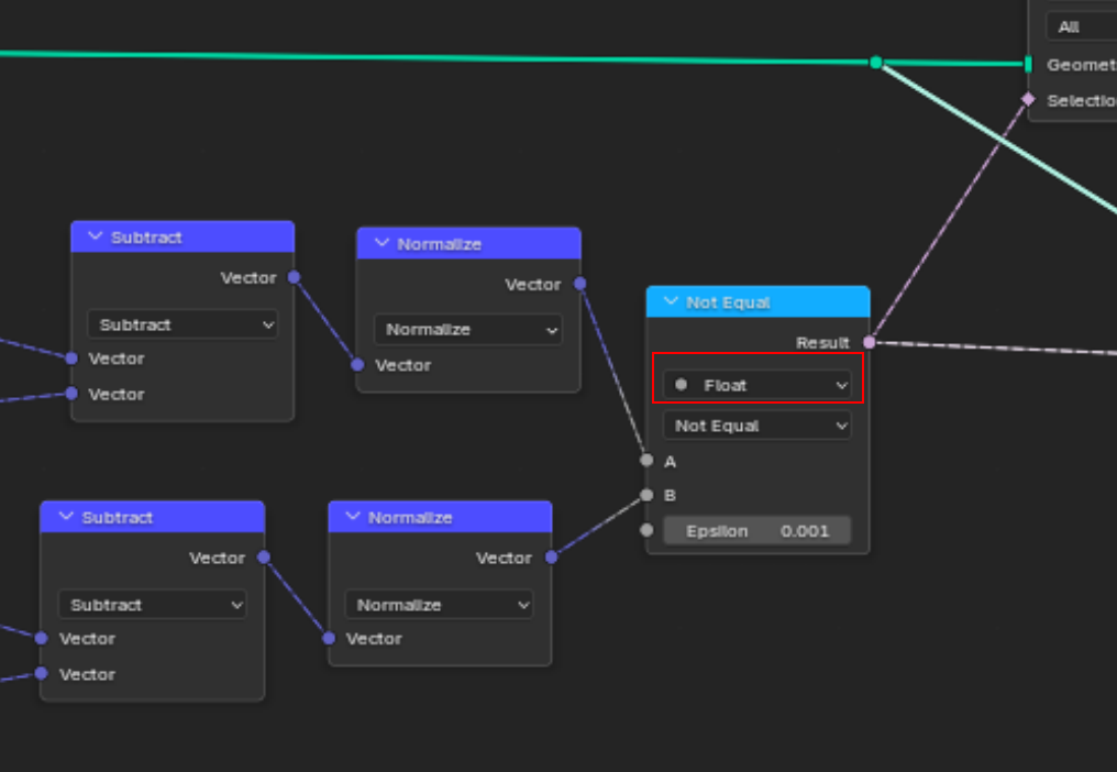

I have aquestion about the collapse points process, because in the latest Blender 5.0 seems the nodes have changed and the result its different., how could I do it in this version
HI Ruben,
I think that it’s not so much that the Nodes have changed, but that you are using a wrong Setting in the Compare Node:
(It should also be set to Equal, but you probably know that already.)
Alternatively, you can set it to Direction and skip the Normalization:
Thank you so Much! :), I could solve it.
