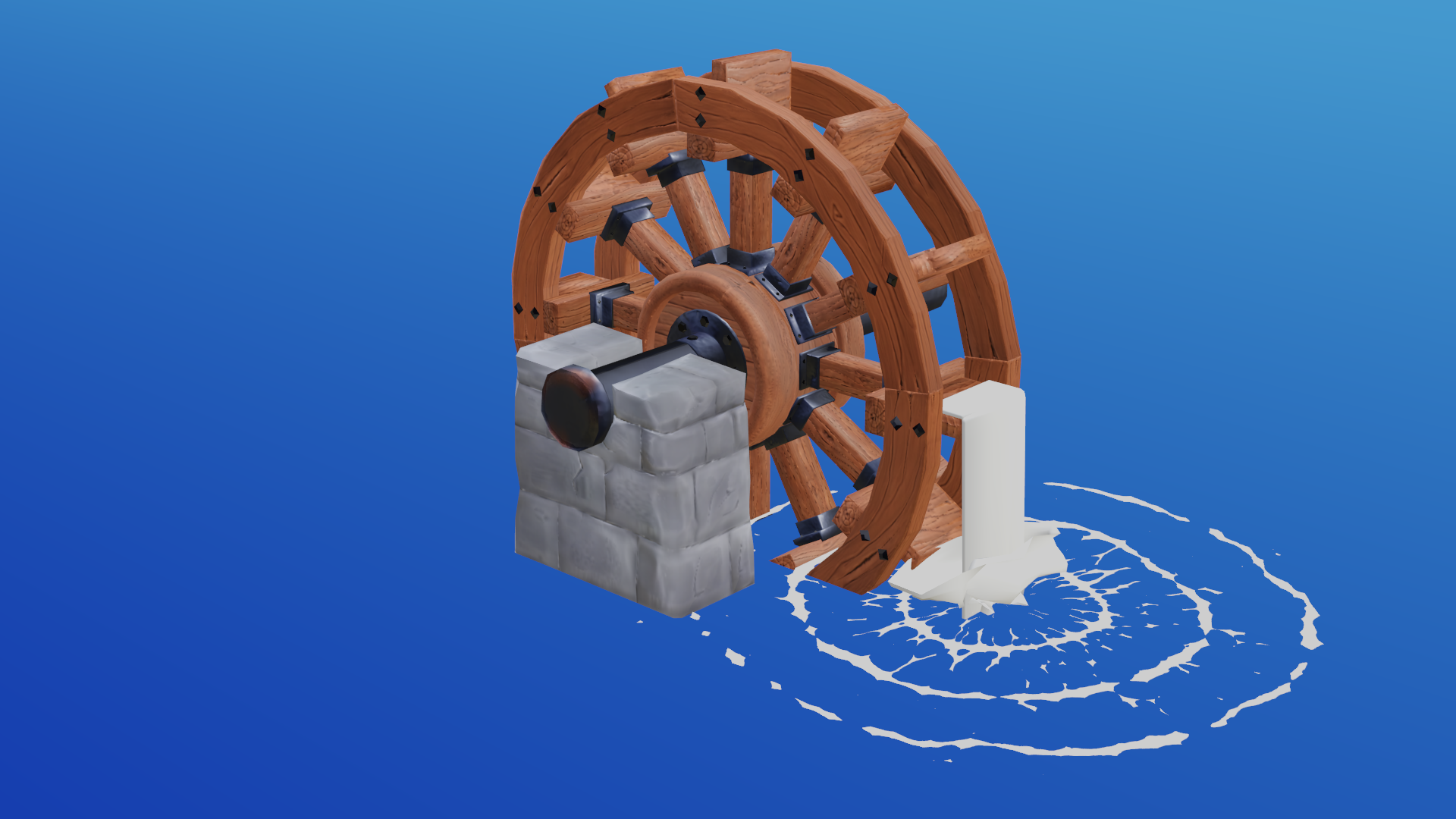

        @ladymito Awesome work on your waterwheel! Even with 1K textures the details read well, which is a testament to your UV layout and baking workflow 🀝
        The only note I offer is to avoid zero reflectivity. The wood material has barely any reflectivity and the stone has none. I recommend always adding at least a little reflectivity except for rare examples. Even if this asset wasn’t in the water I would recommend a little reflectivity but even more so since it permanently resides in water.
        I tweaked your material a bit and saved as SPICE-VENDORS-HOUSE/SCENES/MODELS/MASTER_acc_water-wheel_ladymito.blend if you want to see what I did.

          Working in water splash

                This looks great! Is it the effect from the above video? How easy would it be to slow it down?
                #65338
                ladymito
                  @procyonlotor   Yes, it is the effect of the Video. The shader is very easy to slow down, as well as the speed of the wheel since they go by #frame command. It is not the same with the cascades of the paddles, since I animated them with shape keys and bones. They would have to be manually repositioned with each rotation speed and water fluid adjustment.

                        Personally, I don’t care about what is missing (the water rings aren’t colliding with the stone support, for instance..), but absolutely loooove what is there and the effect is sooo convincing! Totally fits the style of the artwork (and going beyond that..)!
                        #65342
                        ladymito
                          I miss the effect of hitting the stones as well. I didn’t want to go too deep into the shader as I didn’t know what style the river will end up going for. In any case, with that shader, creating water effects is as easy as duplicating a plane.

                              @ladymito Great effect πŸ˜€πŸ‘! Do I see it right that the adaptation of the waterfall effect from the linked video tutorial above to a moving object like a whater wheel is your personal creation?  I’m fascinated by the precise timing for the “water strips” to be attached to and detached from the wheel paddlesπŸ‘!

                                Once again high quality work from you, @ladymito πŸ˜€! Your animated water wheel is one of the  highlights in this Collab 2021 πŸ‘! So, I can barely wait to see your mill mechanism in action πŸ˜‰πŸ˜€!
                                #65346
                                Ingmar Franz
                                  Wow πŸ˜€, I just discovered that you’re working with  “Shapekeys” and “Drivers”  as well as “Object Constraints” (rotation and location):
