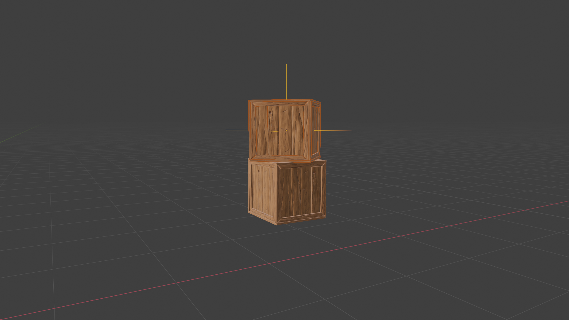

                            Angela
                              made some changes in the texture to better fit the artwork
                              #65995
                              Angela
                                @elubie noticed there is a stack of two crates behind the barrels
                                she and i both made a version of those crates.
                                I reused some of my planks.
