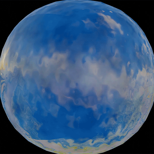

            John Sanderson
              Hey guys! Hoping to join your team.  trying to sign up for the creek as soon as i can get the google permissions. Don’t know that modeling is much of a factor for this asset so I messed around with shaders a bit and came up with this.  Please excuse the obvious seams.  Want it to be more painterly.  Trying to figure out the best way to go about that. Other troubleshooting involves screen space reflections, it will reflect the world but not other objects in the scene.  Did I miss a setting somewhere?  Also getting some kind of foam around intersecting objects.  As most of the intersections will be static I think we can get away with just hard-coding the foam once everything is placed. May not be perfect with a moving waterwheel though. Anyway, excited to be here (potentially) and would love to hear any suggestions/advice.

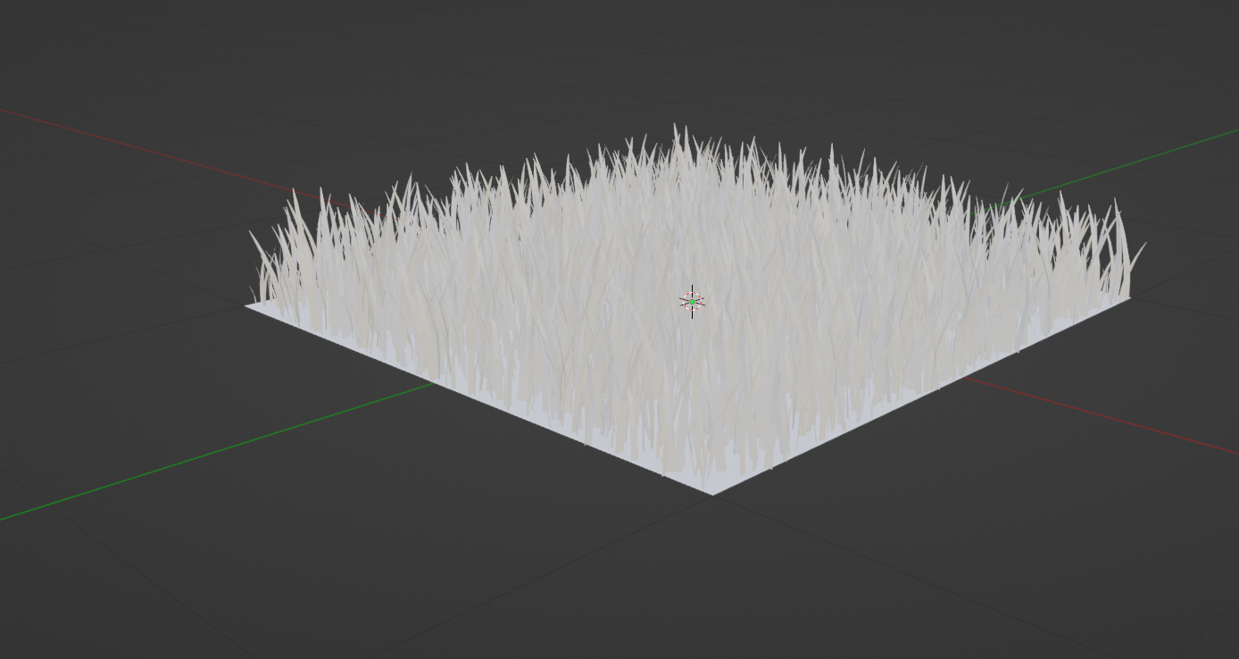

                    rstich
                      First Batch of Grass in a Matter of Minutes.
                      I need a little bit to figure out GN but if you allready know how to use them it takes more time to Model the Grass then to populate a Plane.
                      If there is no Performance Improvement in favour of Particles i would go for the Nodes.
                      Combined with Image Planes and maybe even just Texture Painting in some low key Areas…..
                      I thought Grass would be harder but that gives me plenty of room to produce Super Deluxe Grass ^^

                      rstich
                        Just tried how far i can go until my System/Blender crashes.
                        You cant use any of theHeavy Load Systems on its own thats for sure.
                        Now the Fun Part begins.

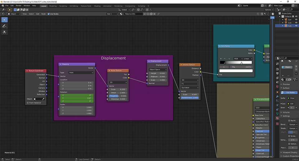

                              John Sanderson
                                @spikeyxxx  I came across this video in my research and wanted to use a similar technique for the water shader. You can skip to 3:30 to see the technique.  My question is how to setup texture displacement in blender without necessitating that the textures share the same mapping data. Is that possible?  Here is my current setup.  You can see that I used a displacement node but the only place I know to input it is in the texture’s vector input which is where I would normally put the mapping info.  This disables my ability to scale and animate the textures separately.  Is there a better setup you know about?

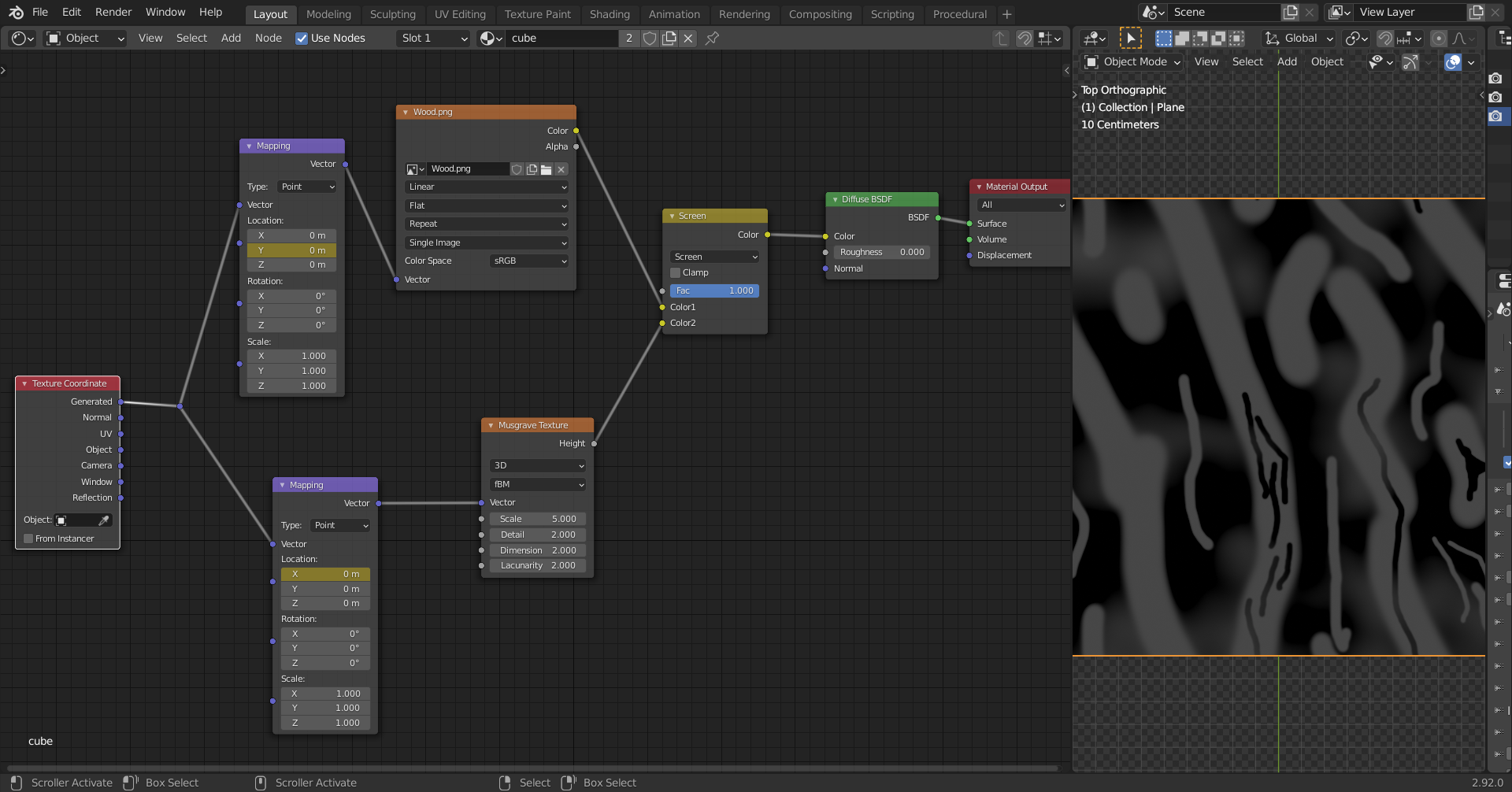

                                #66539
                                  @procyonlotor I didn’t watch the whole video (although I looove that Nintendo style!), but I#d say: just use something like this:
                                  Don’t use the Vector > Displacement Node!
                                  That is for displacing geometry.
                                  I haven’t even tried your set-up, I am too scared to do something like that 😱
                                  And I probably wouldn’t animate the rotation here, only location.
