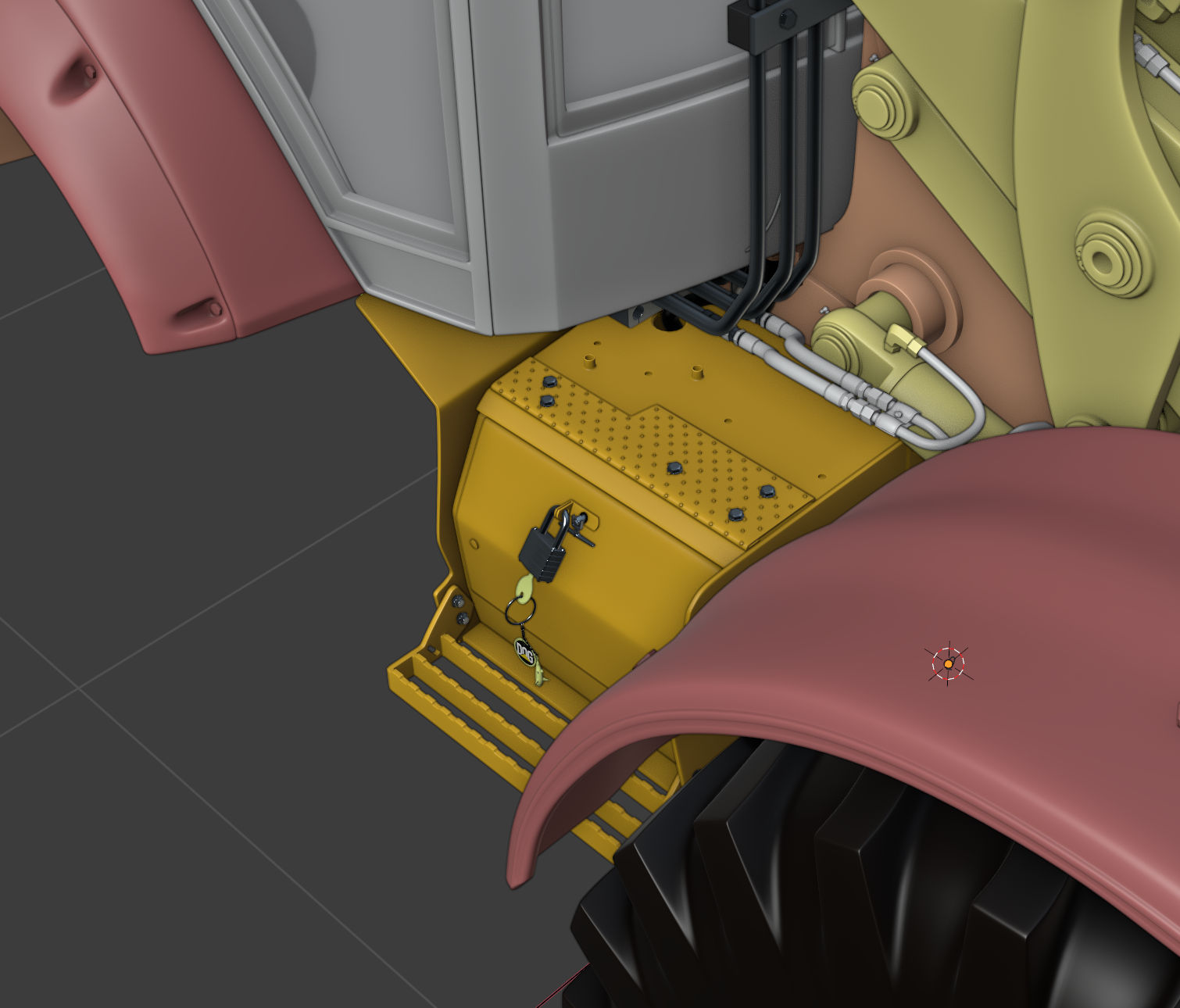

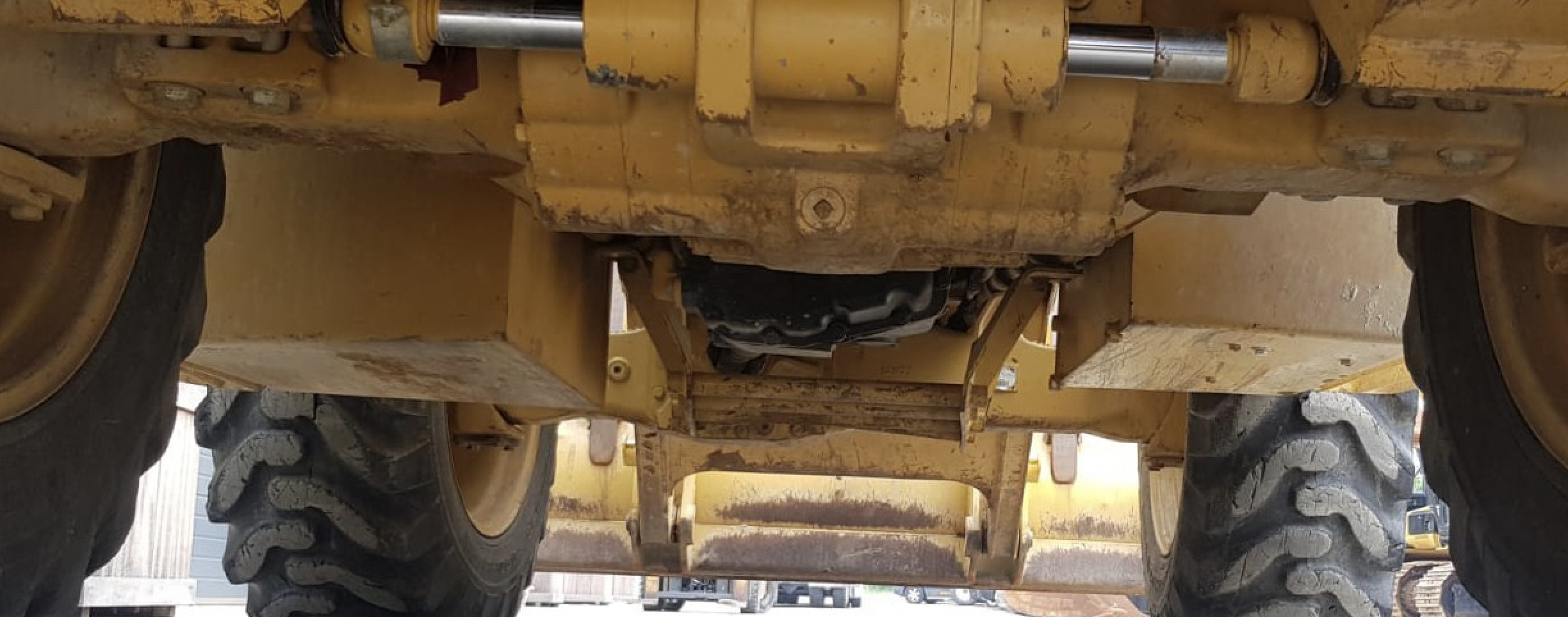

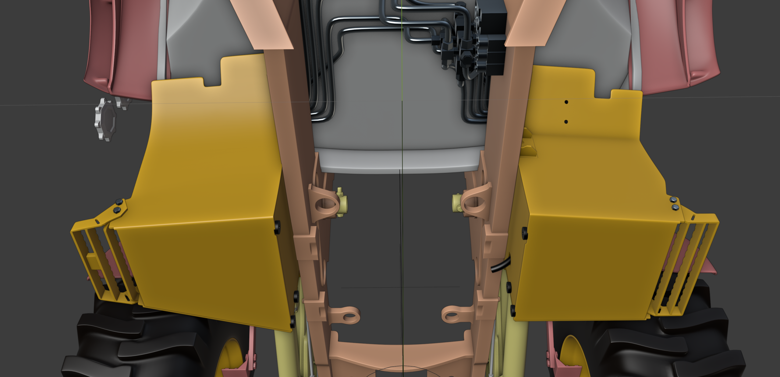

      One thing still baffles me, why are they so tugged in like that? Like a turtle who is too shy to stick his head out.
      They go all the way to the frame both in 3D and real life, yet they don’t stick out enough in 3D. What is going on there?
      #54723
      Adrian Bellworthy
        It looks like the depth of the box might be too shallow. X-axis scale. The step size looks good, maybe the best option would be to bring them forward to the correct positions and extrude the back toward the chassis. Not sure how it will look but might be the simplest solution.
        #54724
          Yeah that was the solution I went with, almost done.
          #54725
            And then you think you pick something simple;)
            #54726
              Dude, that’s why I went with the most difficult looking one for the interior, to not make this mistake again.
