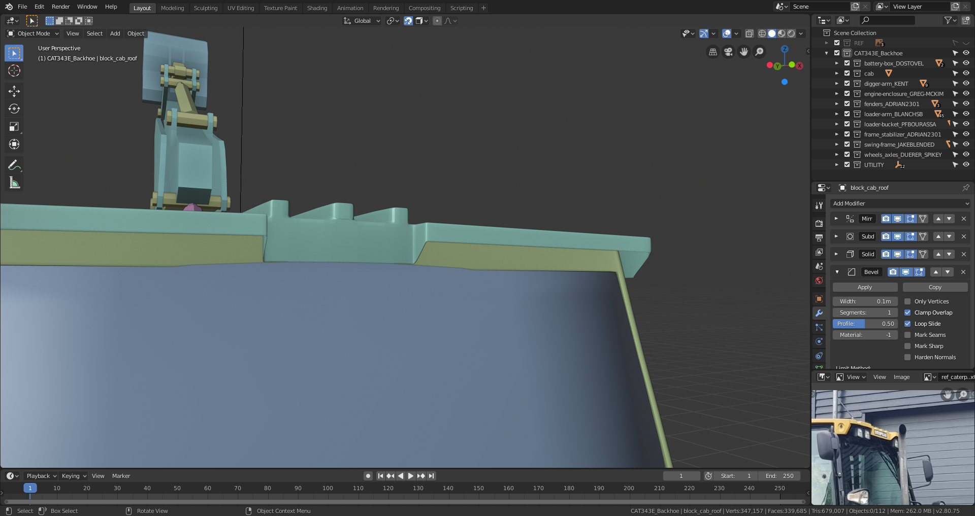

      Ok, I found some of the culprits.
      I turned off all the modifiers. If you select these faces and G to move them, you’ll see they are not connected. That creates problems.

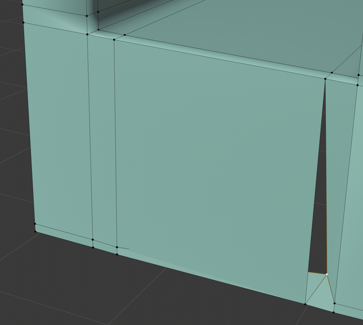

          There seems to be other funky geometry, if you select this vert and G to move it around
          You’ll see you have a flying face, I don’t know the actual professional name for that.
          But this edge should go all the way to his other end.

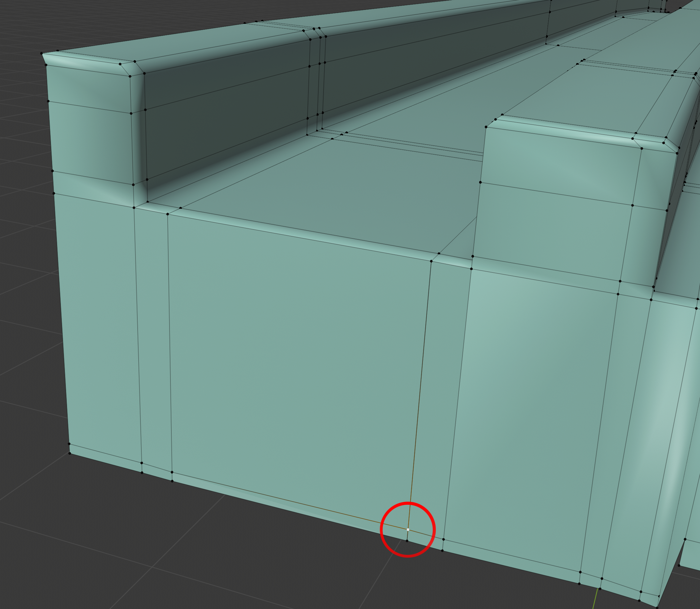

              That face shouldn’t go all the way down, it should stop at this edge.
              If you delete it you will see there were faces down below, occluded by the large face.
              Now fill the face and it reaches the edge it is supposed to and it stops.

                Now it’s all good. I deleted the bevel and solidify modifiers. They weren’t doing anything there as far as I could tell.

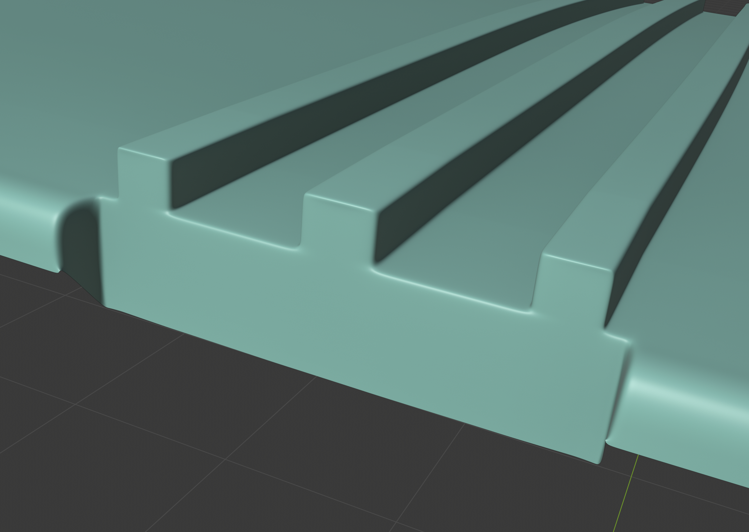

                    @dostovel The reason I put those on was because I heard Kent mention something about the paper thin not looking realistic.

                      Ok I see, I remember Kent saying that. I mean the modifiers there were just making a mess of everything, that tends to happen when things are too bunched up together, you can do the walls and insides manually, just so that the result are cleaner.
