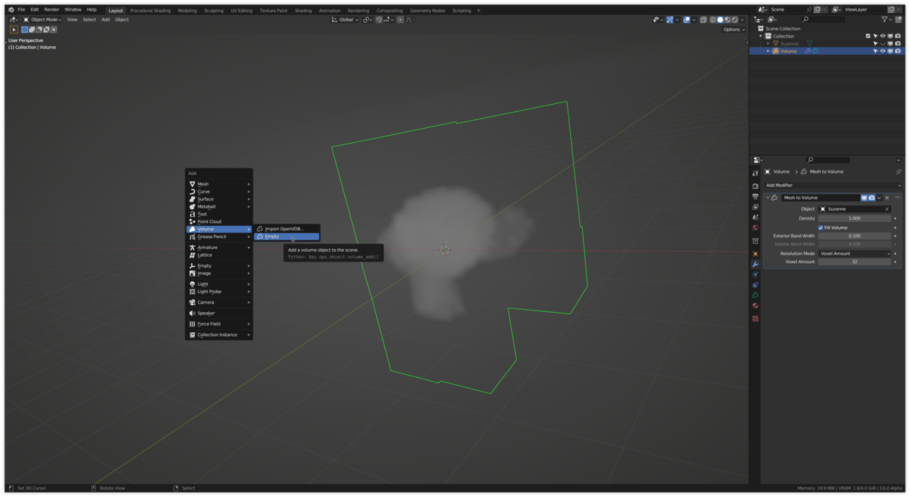

        Make any shape (Object) into a ‘cloud’.
        Add an Empty Volume and add a Mesh to Volume Modifier to the Volume. Choose your Object in the Mesh field and hide the original shape (Outliner).
         Play with the Volume Settings. You can even add another Modifier after that to Displace the Volume.

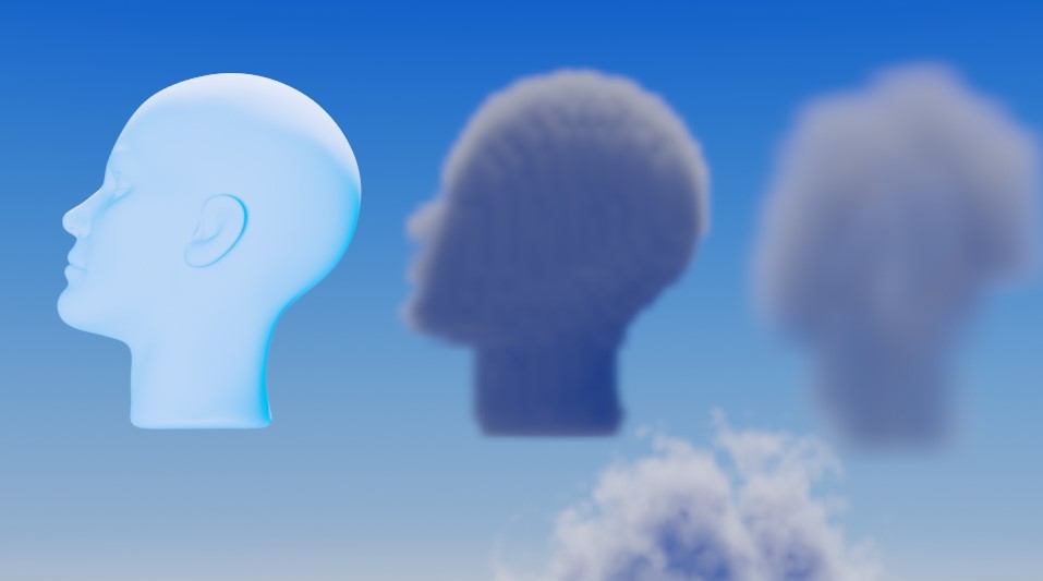

              There looks to be some good options for some quick cloud creation. I’d like to try and make it as realistic as possible and have the whispy organic look of the clouds from the tutorial. Here’s a screenshot of the object and mesh’s with different settings available in the “Mesh to Volume” box. The Resolution Mode, Voxel Size/Amount, do give me some good starting points – though I’d like to add some large/medium/small formations around the object (similar to the tutorials and I’ve put a cloud formation from the tutorial at the bottom of the render).
              I’m not sure if that’s doable but this gives me hope!

              Mark Sze

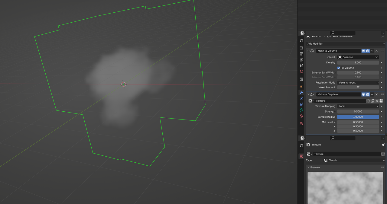

                  Hi Mark,
                  The Volume Displace Modifier (try different noises, Clouds could actually be a promissing choice in this case) might give you what you want:

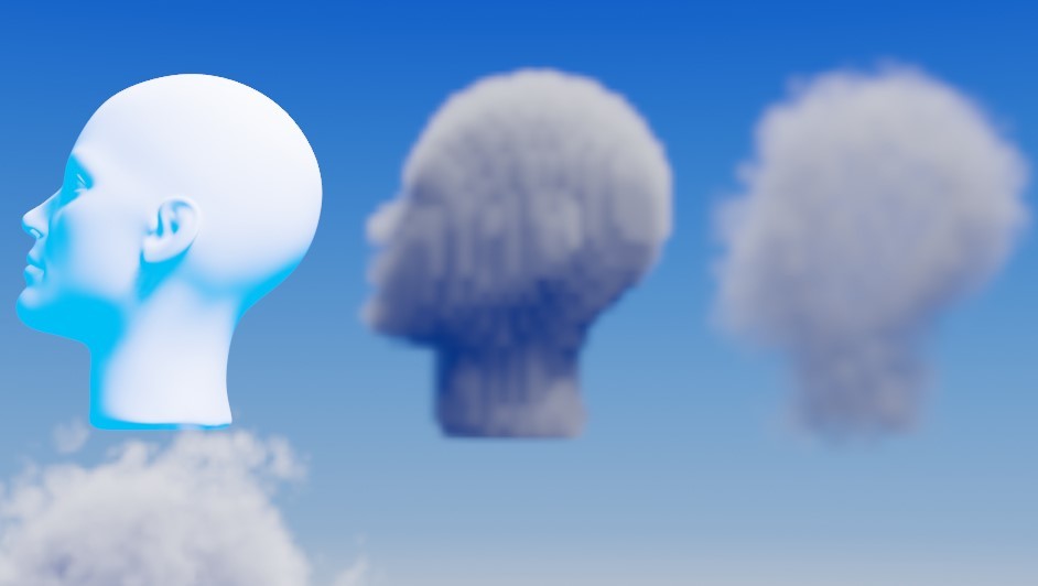

                  Mark Sze
                    Thanks again, that moved it closer indeed 🙂
                    I could possibly layer multiple different clouds on top of each other to get the desired effect. I’ll try that out.
                    In terms of lighting the clouds, I assume these volumes should take lighting just like the clouds formed in the tutorial? I tried an area light at an angle to get some shadow but I think I need to do bigger noise and perhaps more layering to get the desired affect.
                    The new cloud is on the right, looking much more organic 🙂
                    (Note: I used Clouds Texture and use the “Voronoi F2-F1” Noise Basis which aligned with the Voronoi they used in the tutorial)
