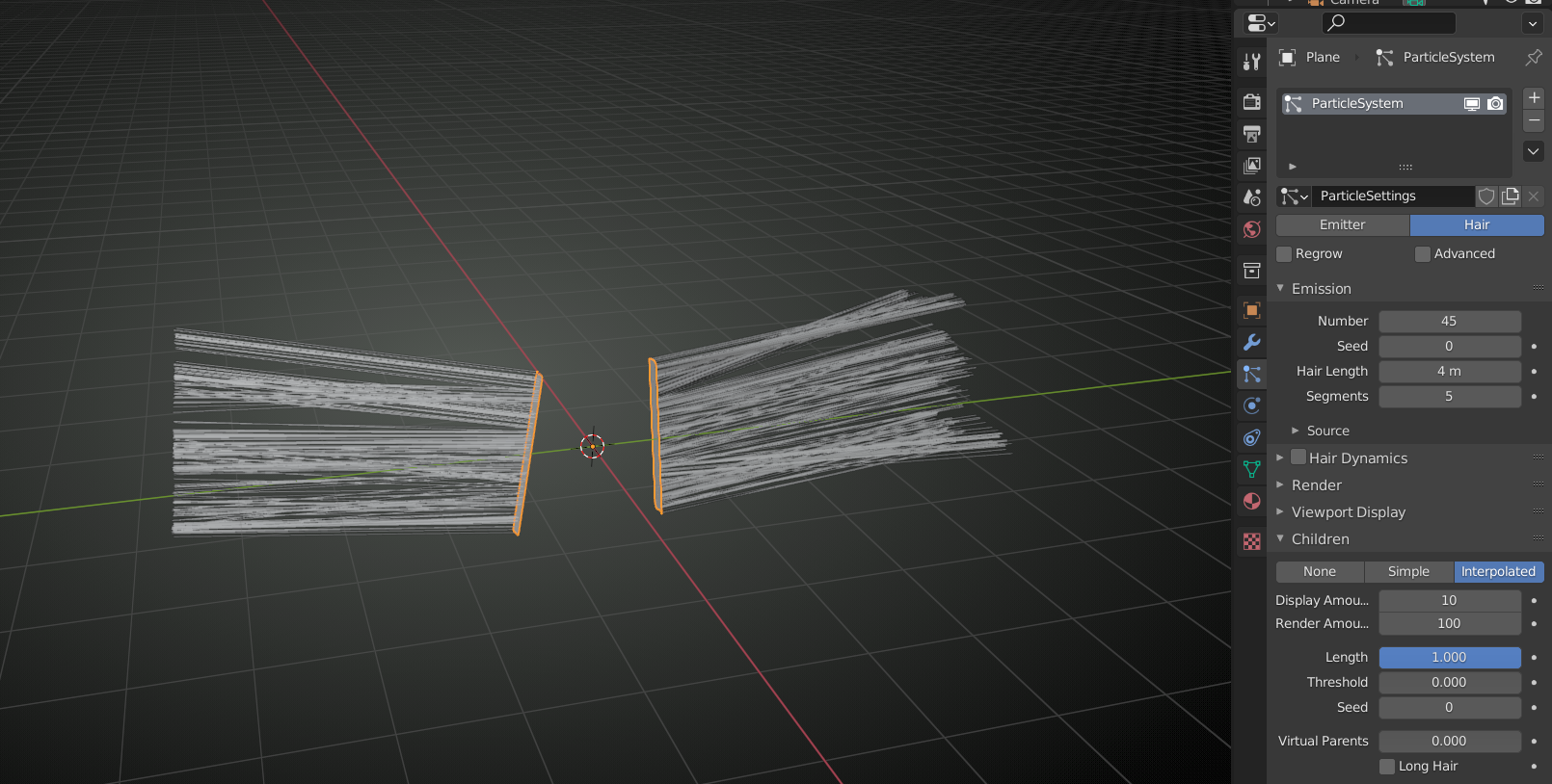

        Maybe, you have a situation like this:
        using Simple Children with a roundness of 1, places the children on an imaginary sphere with set Radius around the Parent. The Children (blue) are still all pointing up, but some of them ‘start’ below the Parent (green)…

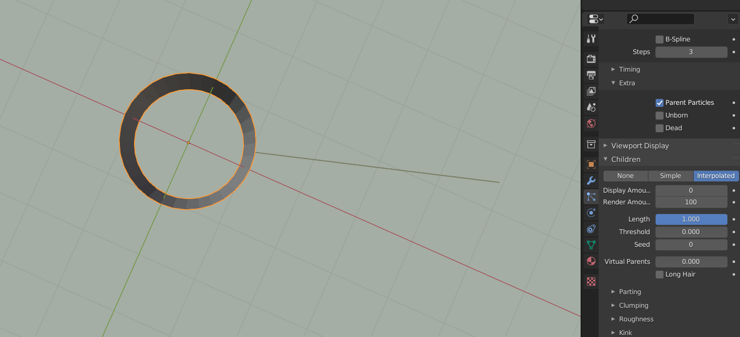

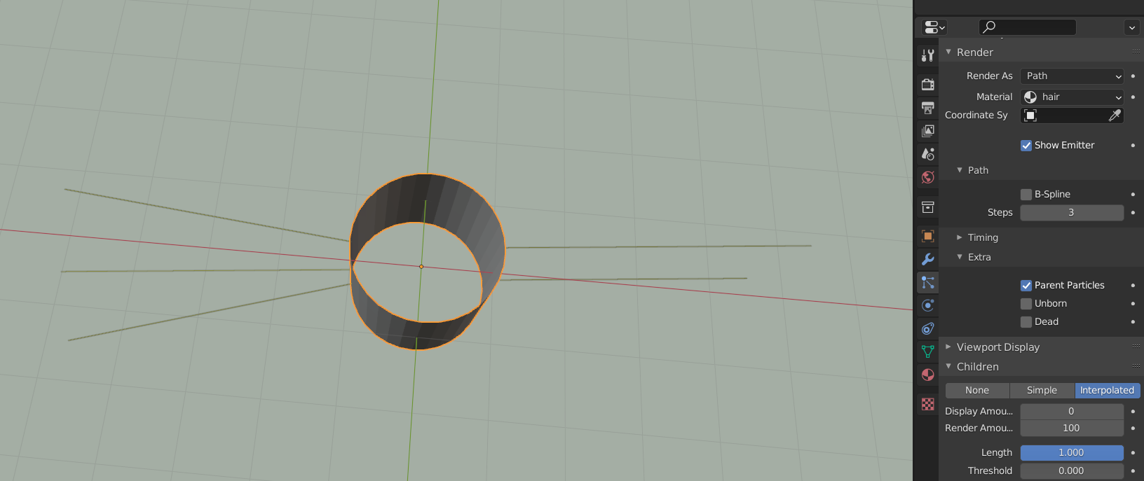

            That seems to be, because of the way Blender calculates the interpolation of the Child Hairs. With only one Hair:we get:

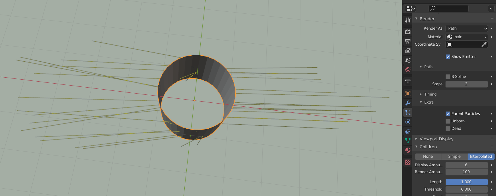

            But with more Hairs:
            we get:
            Not only do some Hairs go through the Mesh, but some Hairs are also shorter!
            Apparently Blender considers a Hair going in opposite (World) direction to have an opposite (negative) length…
            I’d call this a bug, but the system is going to be replaced/overhauled anyway (if I understand correctly).
            It’s not some kind of Setting that you can change, you didn’t do anything wrong.

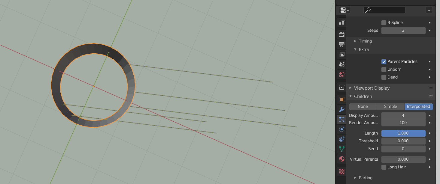

            What you could do, is to not use Children, simply more Parents…
            Or use two Particle systems, one for each side….you can use strips that you Shrinkwrap to each side as Emitters.
            #68629
              Or even using one Particle System, something like so:
