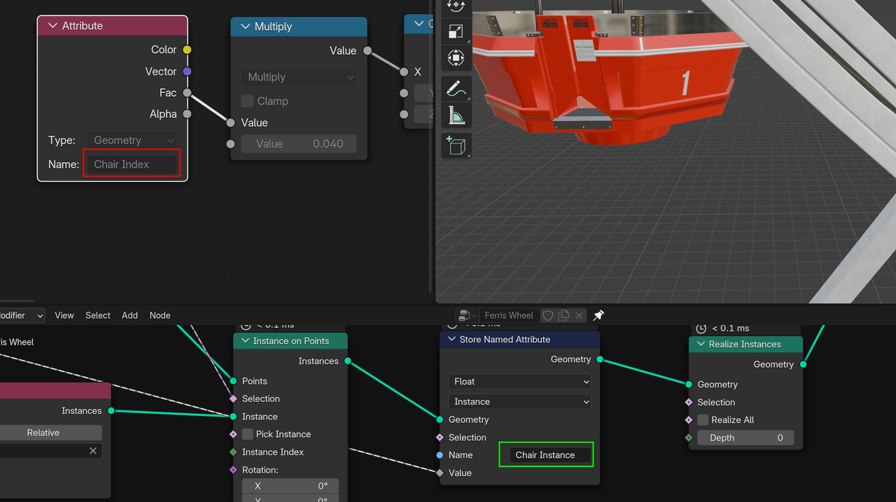

      nothing happens after using the Realize Instances node. It stays 1 on all of the gondolas.
      Is there a change in the behavior of some nodes in version 4.2?

          Hi Abdullah @Esseperse ,
          Try enabling the Realize All in the Realize Instances Node.

          Abdullah Alshammari
            Hi, Martin
            I tried that before posting but still the same.

              Hi @Esseperse ,
              Could it be something in the Shader Editor?
              If you want, you can upload you file (File > External Data > Pack Resources. Save the File.) to Googledrive, Dropbox, or so and post a link here, so we can have a look; complicated scenes like this are often really hard to troubleshoot from screenshots alone.

                  HI Abdullah @Esseperse ,
                  I’m having trouble overriding the Material, so I can’t test it, but it seems to me that this could be the culprit:

                  Abdullah Alshammari
                    Thank you so much, Martin
                    It’s all fixed now with a few clicks. I don’t know how I didn’t pay attention to this.
