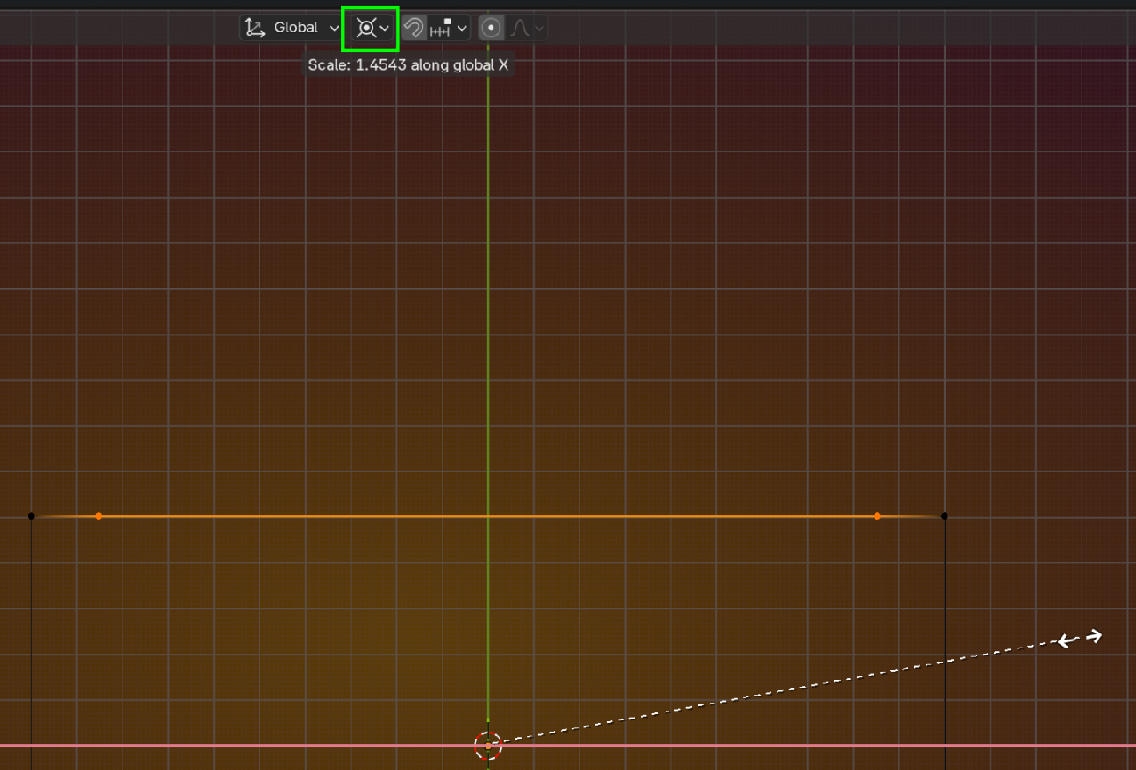

      At around 1.34 I resize the edge loops in vertex mode, but when I constrain around the x axis the red guide becomes thick, and I can’t see the vertices at all, so I have to iterate resizing blindly until I dial it in, and eventually get it to work.  I’m in top view.
      Is there a setting to adjust the opacity of the red line or to increase the visual size of the vertices?  I’m using 5.0.0.

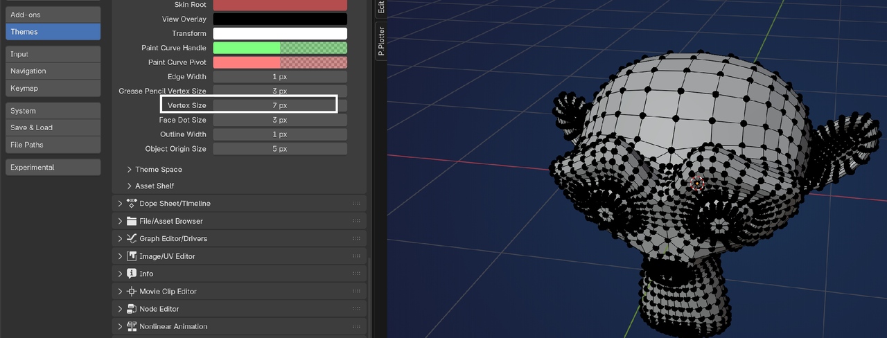

        Hi David!
        You can increase the size of the vertices by going to Edit> Preferences> Themes> 3D Viewport then scroll down past the bands of colors. You’ll see customizable settings for edges, vertices, etc where you can increase their scale. Hope this helps!

            Hi David @RavenMenace ,
            You can also move the “X-Axis Scaling Guide Line” (this is probably not what it is called officially) out of the way, by Changing your Transform Pivot Point to the 3D Cursor:
            That is less ‘destructive’ than making the Vertices larger, which can get problematic, when your model gets denser:
            Then you’ll have to change it back and changing a Preferences Setting back and forth is not ideal😉

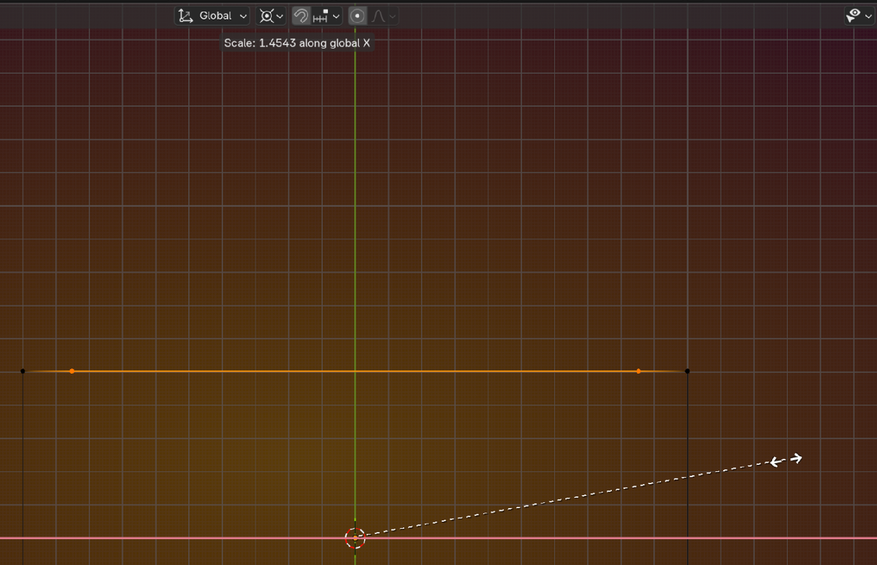

            #98113
              Sorry, forgot to mark where to set the Pivot Point, so for clarity:

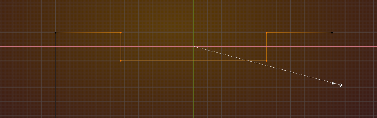

                Here’s an other idea:
                First make the Extrusion and then Scale:
