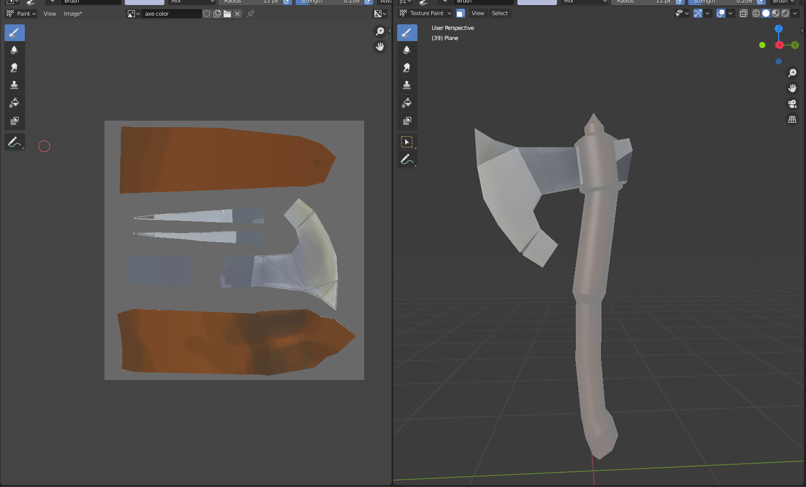

      I am completing this exercise in Blender 2.83.  I can’t see painted part in texture paint view port  and the axe blade look weird. I check normals but those are fine. attaching screenshot.

        Hi! Could you share the file via dropbox or pasteall.org? My guess is that either there’s a second UV map that’s being used or a different image is selected in the shader editor, but if it’s not those things then I’d probably need to see the file.
