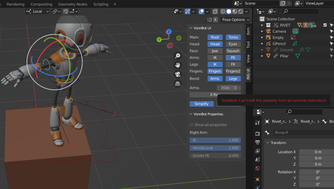

      Whenever I try to edit one of the properties of the rig e.g. hiding the arms, it says ‘Disabled: Can’t edit this property from an override data block’. How do I stop this?

        Go into the original rig file. You’ll have to edit each property and check “Make Library Overridable”
        You can find the source for each property by hovering over the button in the UI.
        I don’t have access to check out the most recent Rivet Rig but the arm_vis should still be located in the root bone’s bone properties.

          I will need to do a quick hot fix for this, but with library overrides all the custom properties need to have the “make overrideable” enabled in the original rig file.
          When I get a chance I will fix all the download files but if you need to quickly get it up and running – here is a script for you.
          Copy and paste this code into the text editor, select one rig at a time, then run it (Alt P)
          Then save the file.

          It will only work on the active object, if that object is an armature.
          Yes I’ll do a proper update to the download files, but that’s probably not going to be today.
