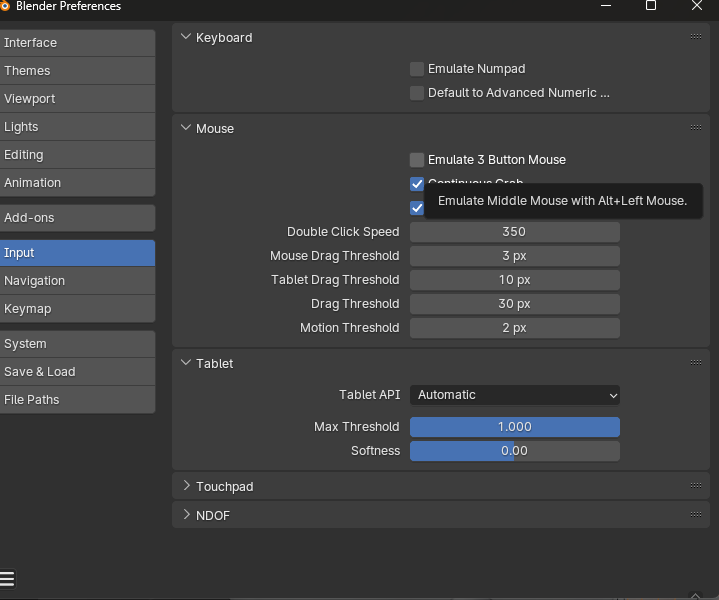

      Hello i have to deselect an edge line in the tutorial but shift alt dont deselect. I notice alt do nothing in my blender. Have an idea?
      #82524
      Stéphane Vahle
        I found the solution. You need to disable emulate 3 buttons mouse
        #82525
        Dwayne Savage
          Yes, when you use emulate middle mouse button alt+left mouse button acts as the middle mouse button. to select edge loops you have to use double click left mouse button.

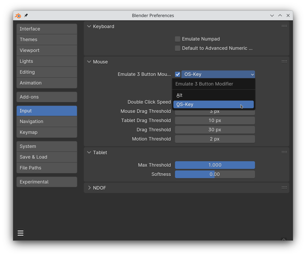

            #82527
              On Linux we have this great ability to use the OS Key instead of the ALT, when using Emulate 3 Button Mouse:
              #82528
              Dwayne Savage
                That option is only on Linux? Doesn’t matter my windows manager(xfwm4) or desktop environment(face) captures it so that didn’t work for me. I have a 3 button mouse now and haven’t tried it on my Linux mint cinnamon.
