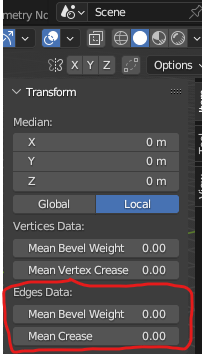

              And also other things, if your object is too small, you will need the longest of decimal points to see some effect of the bevel, be sure your dimension are not almost subatomic. And another thing that often happens is that people will fiddle with the crease but to it in the vertex date, not the edge data, be sure you’re doing it in the correct one, because one being on top of the other can be confusing.
