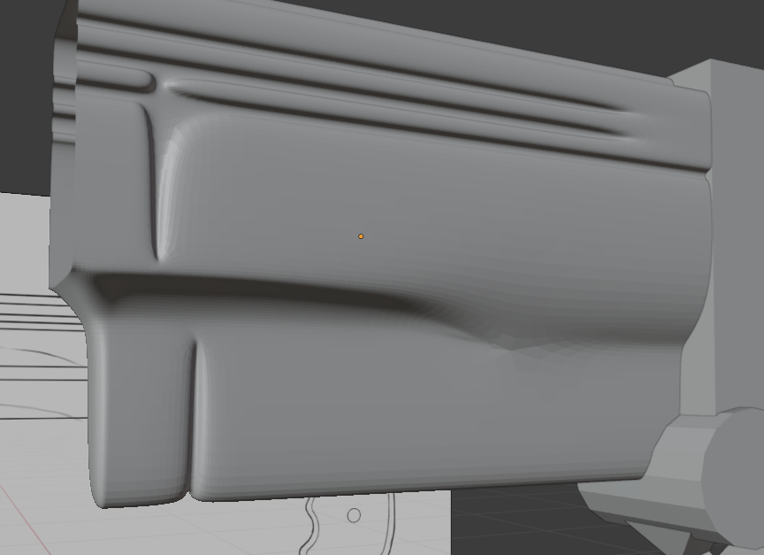

      Here’s my barrel, and you can clearly see there’s something wrong there, when I inspected it on edit mode, I found this:
      I think I accidentally merged those 2 vertices into one creating that 6 sided pole, is there an easy fix to this? I basically wanto to make it into two so it makes a quad with those vertices on the left

          Select the vertex, press V to rip that vertex in two.

              On a second thought, knife tool would be an option too.

                @gabrieljim The vertex in your example even seems to be an 8-pole. In any case, you could select that pole-vertex and use “Rip and Fill” (Alt + V):
                1) Place the mousepointer on the side to which you want to extrude that vertex:
                2) Now press Alt + V and drag the newly created vertex to its final position:
                3) You can now select the edge between the two adjacent center triangles in “Edge Select Mode” and dissolve it with  x + i:
