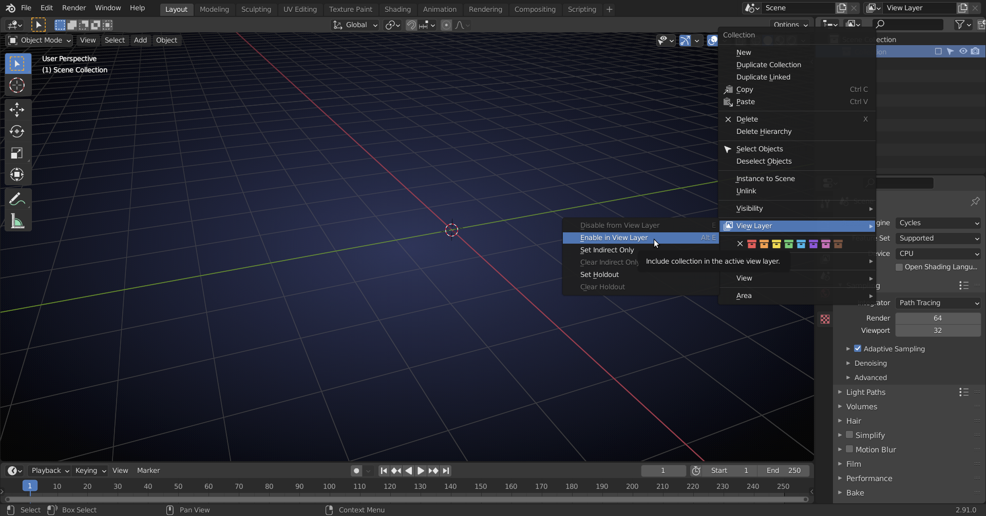

          In 2.91 you can hide/unhide a Collection from the View Layer by using the checkbox:
          This is exactly the same as right-clicking the Collection and under View Layer select Include or Exclude from View Layer:
          When you’ve hidden a Collection this way, you can press SHIFT+A > Collection Instance > …   to add an instance of that hidden Collection
