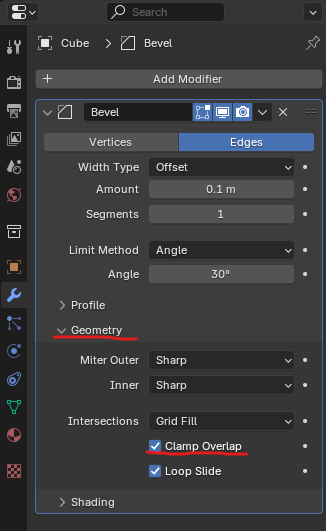

Hi @clovyclov ,
That’s the Clamp Overlap in the Bevel Modifier doing its job. Simply disable that.
Just in case, you have to expand the geometry tab:
