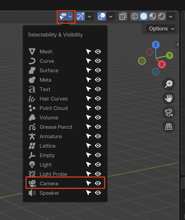

          Also check that the camera is turned on for the visibility:

          Thomas Luther
            Gotcha! I was able to recreate the local cam view so likely this was it. Prolly mashing the keyboard with my unruly meaty fingers…..
            Thanks much Martin and Omar!
