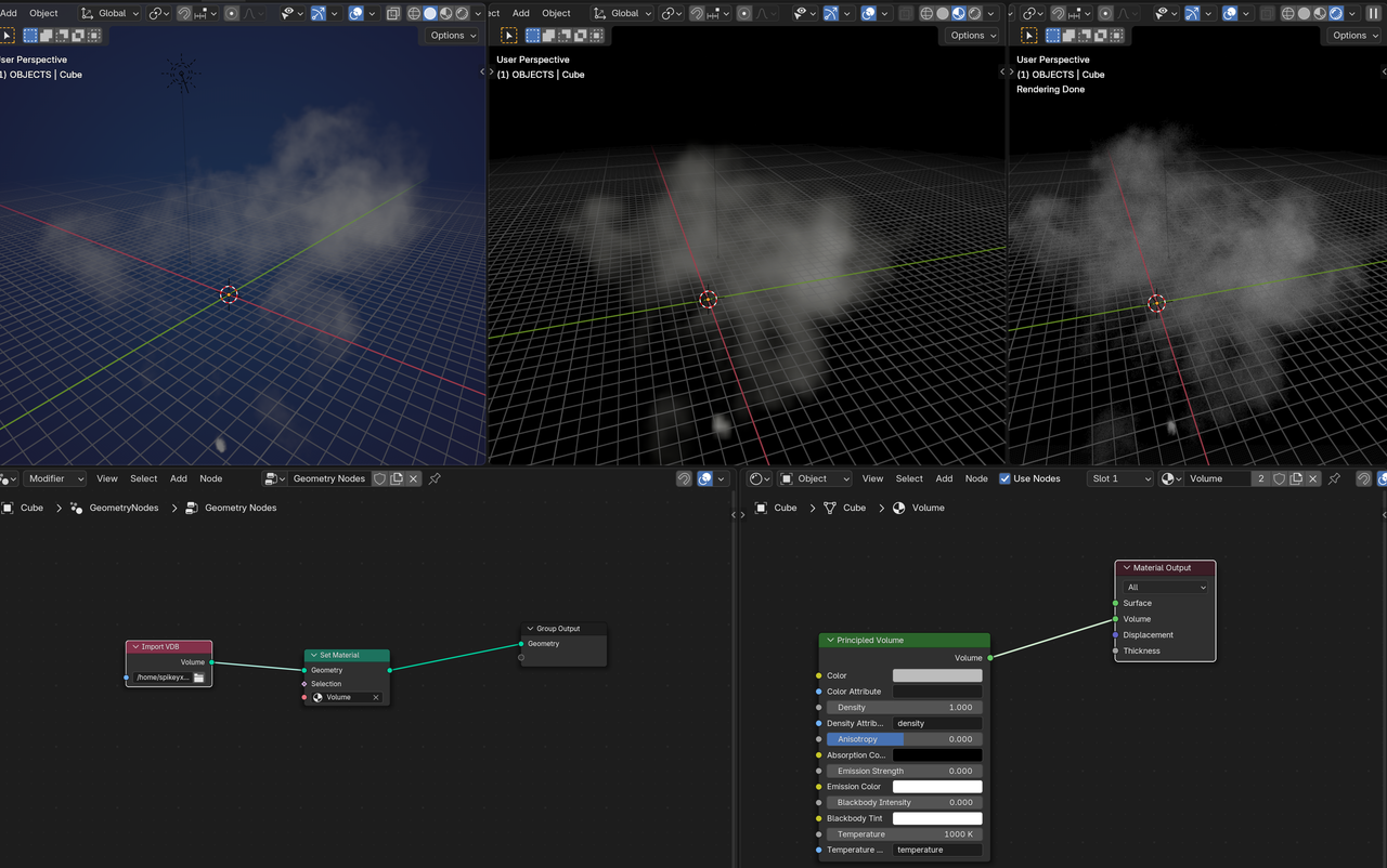

        All three work:
        If you can give us access to the file, we might be able to find, what’s wrong.

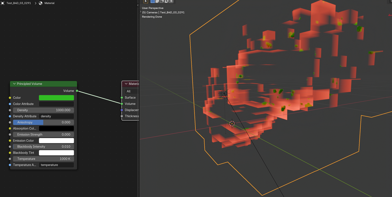

                  Hm, I don’t know (yet); it looks like corrupt data.
                  I can get something with Cycles, but it’s not pretty:

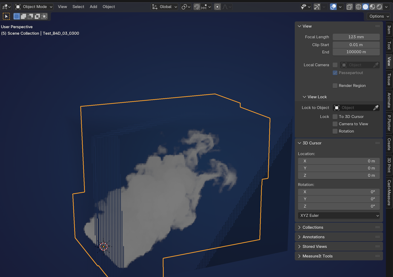

                  And with very specific Settings for Focal Length, and Clipping, we can get something in Solid Shading:
                  So, my guess at the moment is, that it has to do with the Size. It is in the order of 10 km. That might introduce some precision errors in Blender.

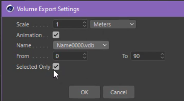

                        Well, I don’t have C4D, but I just watched a video and you should be able to lower the Scale in the Export Settings
                        Mind you, in the video, it Exported it still huge, with a Scale of 1 Meter, so you might need to set that to 1mm or even less. I’d be interested if that would improve the situation in Blender.
