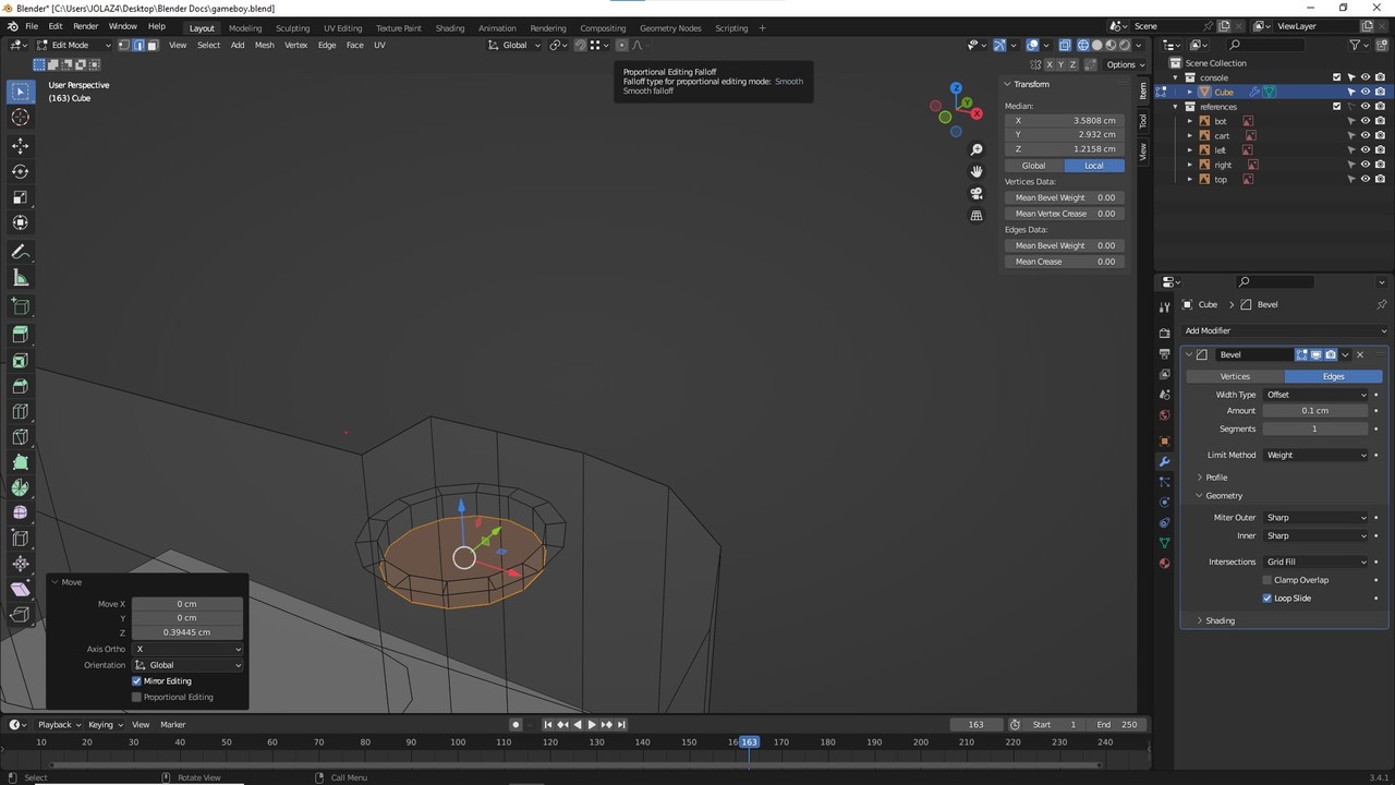

          Jonathan Lazaro
            IM having the same issue at 10:10qqq.jpg
            #79609
              Hi Jonathan @Jojo ,
              It should be: I to Inset, pull down and then E to Extrude (up) again.
              What you appear to have done here is I, E(xtrude), pull down, or maybe I, I, pull down.
