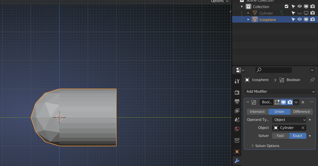

        @mrorangekitty seems to work perfectly fine, if this is what you mean:
        (Also Applying the Modifier and deleting the Cylinder works as it should.)
        What Blender version are you using?
        Or did you maybe use a Cylinder with a hole? It should be a ‘closed’ (watertight) Mesh.

          @mrorangekitty, it seems to work ok for me too. Other than what @spikeyxxx said, the only other thing I can think off is the Boolean is not applied before deleting the cylinder.
