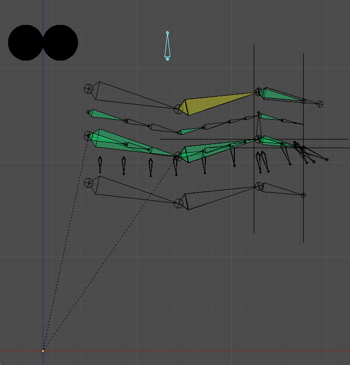

      Working through the Piero course still. I’m having a strange problem. I followed the steps in Kent’s tutorial perfectly, but I’m getting strange behavior with the bezier that is supposed to move the wing spline.
      The settings are exactly the same as tutorial episode 23.

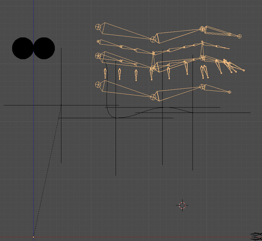

      However, Blender isn’t updating the screen very well. If I move the bones in edit mode, nothing happens at first.
      If I tab back to object mode, it shows how the bezier curve has changed.
      There are no problems when I use the empties to move the spline. They update in real time.
      This makes me worry there will be problems later getting the splines to update, beyond just screen update problems.

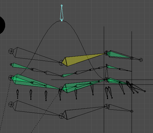

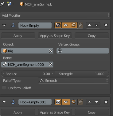

      In fact, I couldn’t even get the bones to update the curve at all until I followed a weird process. Move the bone, tab into object mode then back into edit mode. Put the bone back. Make sure that on the hook modifier, “view modifier in edit mode” is turned on (off by default). Then when I grab the bone, at first nothing happens:
      Hovering mouse:
      I have to actually click for it to show how the spline changed, and this only seems to work sometimes.
      Never seen Blender behave in such a bizarre way!
      Does this problem look familiar to anyone? A bit confused as to what is happening. Maybe a bug that wasn’t in the older blender Kent used to make this tutorial. I’ll tag some people familiar with the tutorial. Thanks for reading!

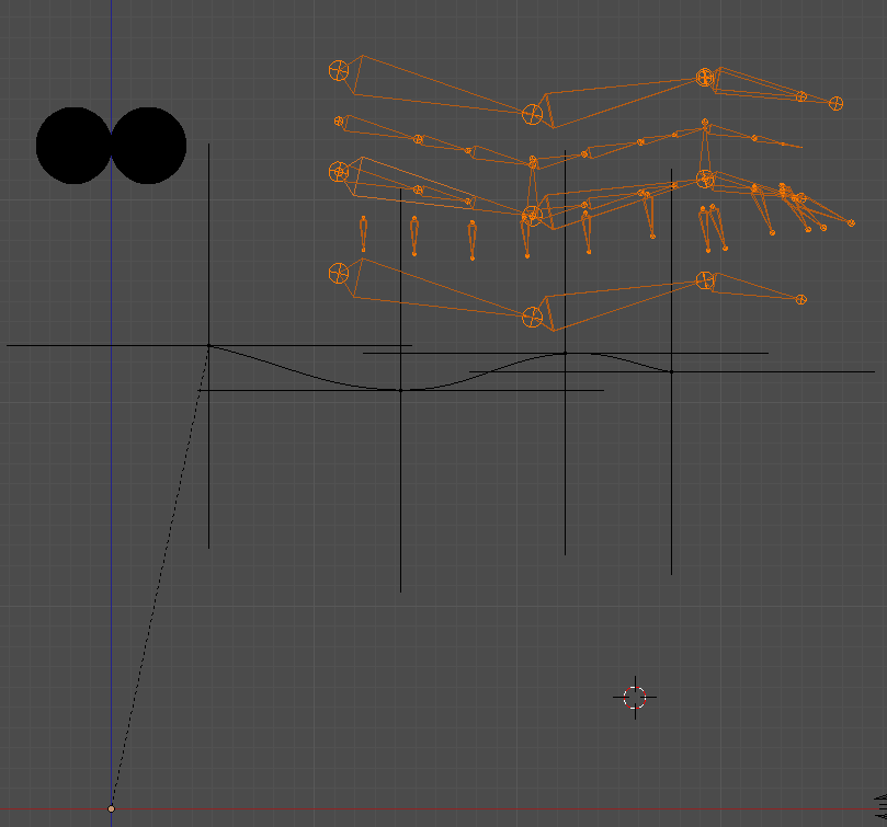

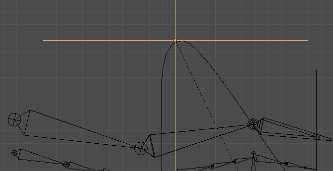

                  Jon’s fix helped with the issue somewhat. When I use the new dependency graph as he suggested, I only have to click once to get the wing spline to settle in at the new position. Without the new dependency graph, I grab the wing, click to reposition it, no change. I have to grab it again and then right click out to get it to settle. (I use Blender 2.78, but I tried it on 2.79 fresh download too, same behavior.)
                  Either way, it won’t update live, even with the new dependency graph turned on. Feel free to look at the Blend file still, but I think this is as good as I can get it. I’ve moved on to rigging the tail, which won’t bend smoothly with the new Bendy Bones options, but I can probably find a workaround.

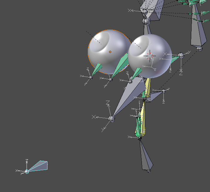

                      Ah, actually, it might be my graphics card or something… are there settings I can tweak to change how the Blender viewport is rendered?
                      It happened to me with the eyes, no splines involved. Just a simple parenting of the mesh to the bones. And I still have to click to get it to set. Weird.
