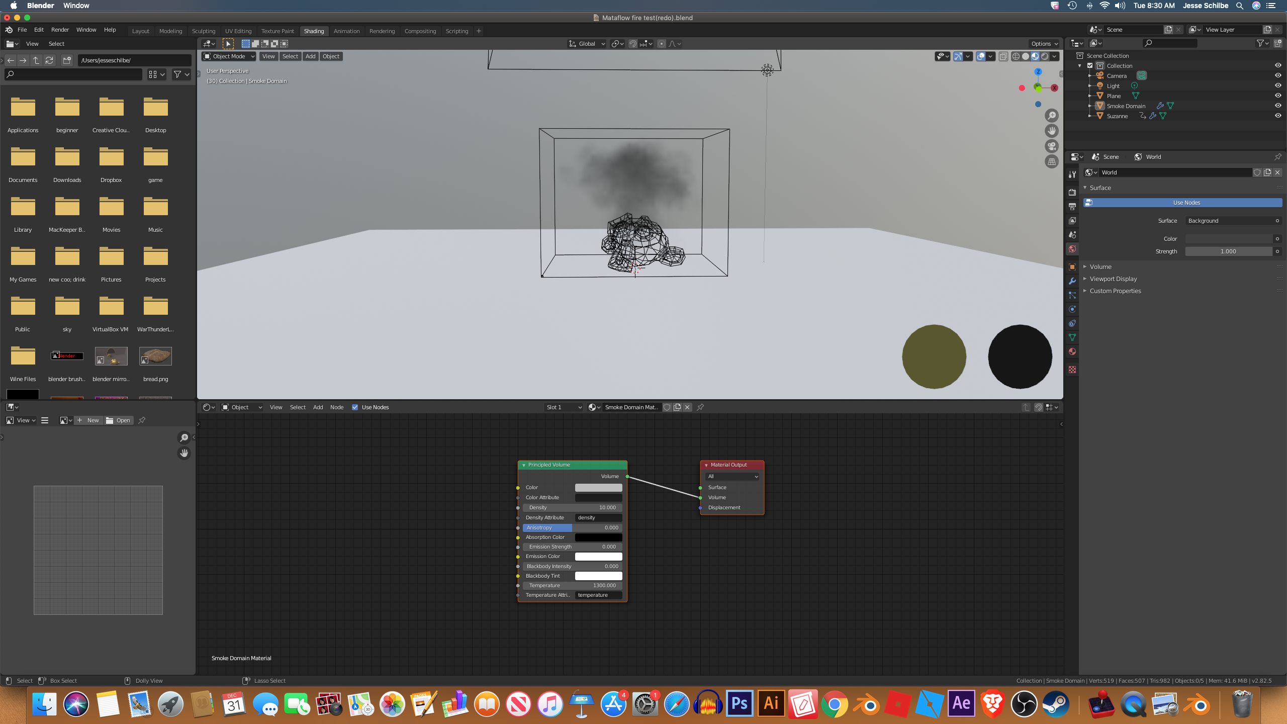

      I’m having troubles with blender mantaflow it won’t show the fire in rendered mode before I ran into this problem mataflow was working but now is not I made sure to make a folder on my desktop for the cache and to bake the data and noise but noting is showing whats going on? here is my blend file http://pasteall.org/blend/index.php?id=52725

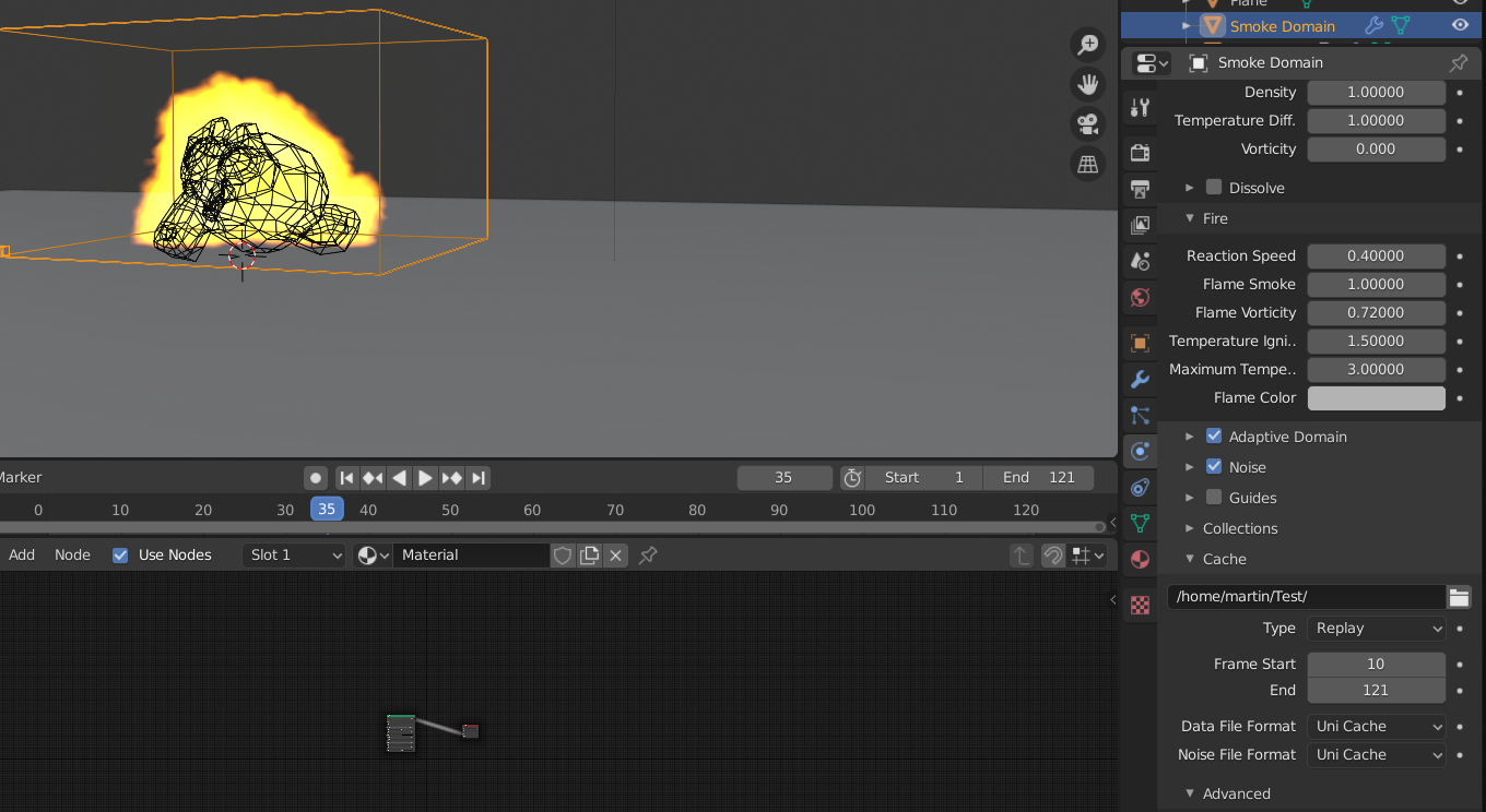

        Don’t know why, but try setting your Cache Type to Replay (no need to re-bake):

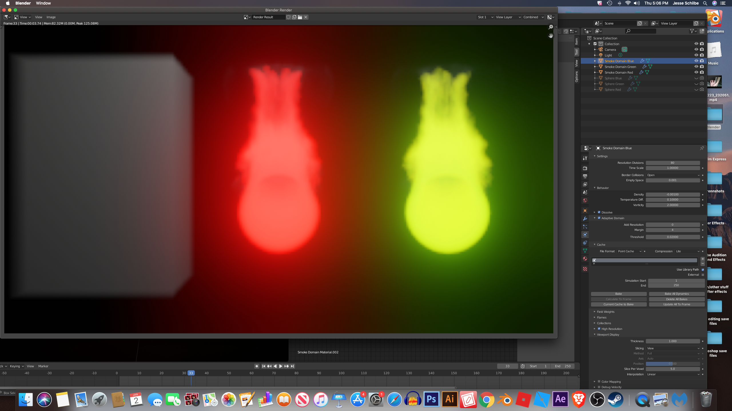

          will I kind of figured out the mantaflow problem but now am having a problem with the latest build blender 2.81I’m also working in eevee I got 3 flames after baking the fire sim 2 of the flames show up in the render but one wont show up in the render I gave a shader to the one that wont render so what go on? and how to you change the bake type to replay? I dont see it
              also heres my blend file http://pasteall.org/blend/index.php?id=52732

            Your file renders just fine:
            I didn’t change anything!
            Changing Bake Type to Replay is only in 2.82 (where it says Modular):
            But I have a later version of 2.82 than you (mine is from 30-12-2019, 18:20 and it is called v2.82.6 (on the bottom right of your screen, you have 2.82.5)), so maybe that is new…
            Anyway, Replay doesn’t write any files to your harddisk, Only Modular or Total. With Replay, you can test the simulation before baking, so it’s a lot faster.
