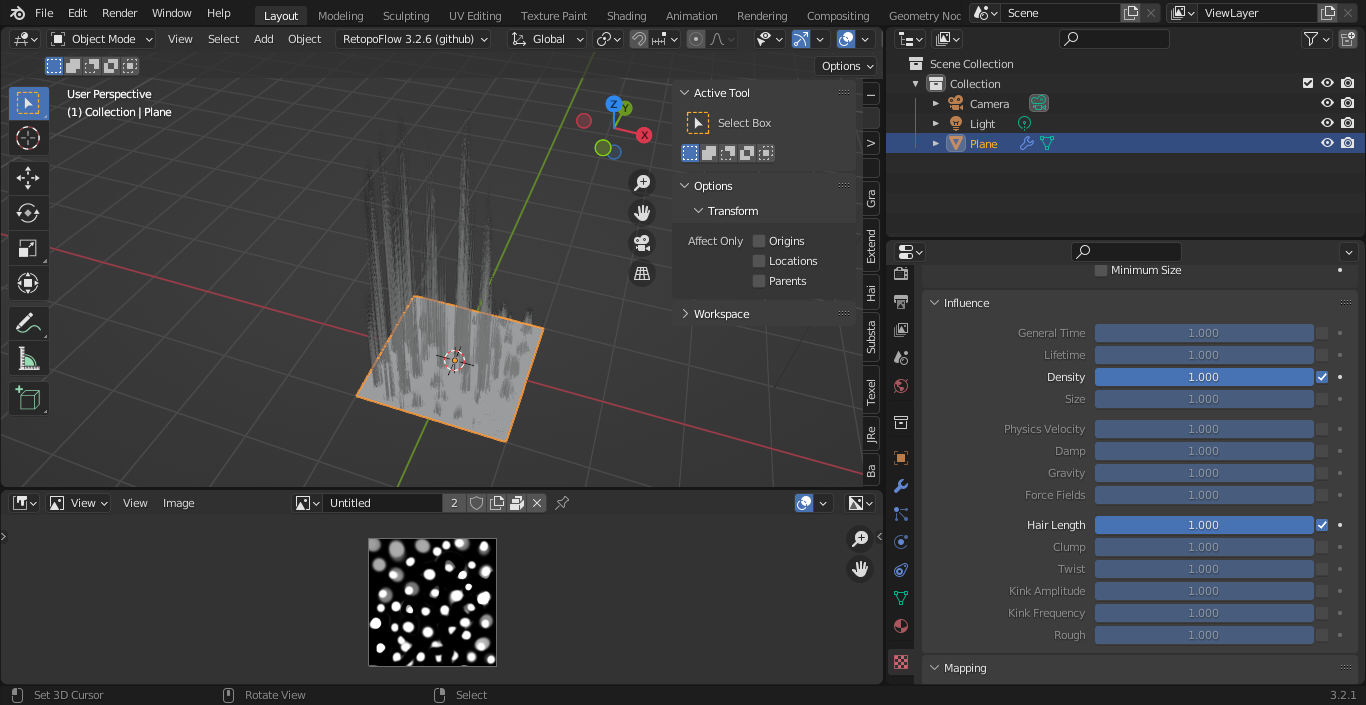

      Does anyone know how hair texture influence work?
      I try to use a texture to affect children hair clump, but it not change anything follow
      the texture.
      I used a mask with random white area, is it supposed to happen clump at white area?
      It can still affect hair density and length like below
      #75241

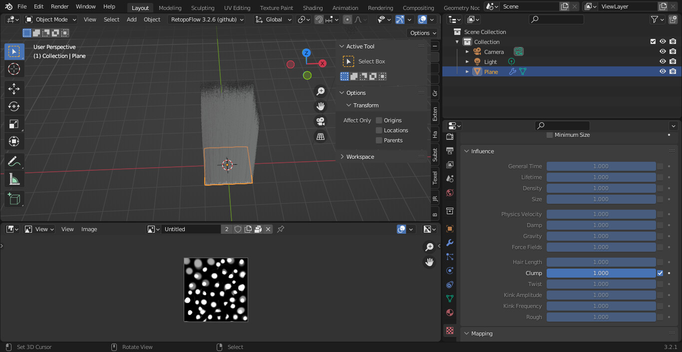

        Hi @zhuk0v1811 ,
        Did you enable the Clump in the Particle Settings (don’t leave it at 0):
        #75242
        PT Binh
          I changed clump value to 1, It look quite oddly. If turn off density and length and leave only clump, it seem nothing affect at all
          The result I desire should look like this with texture influence
          #75243
            It seems to work fine (maybe the effect is less strong than you expect?); on the left, no Texture, on the right the exact same settings, but with a Texture influencing the Clump:
            #75244
            PT Binh
              Hmm, it seem still run, but the way it work it not the same as I imagine lol
              The hair will mostly focus on the hair guide only
