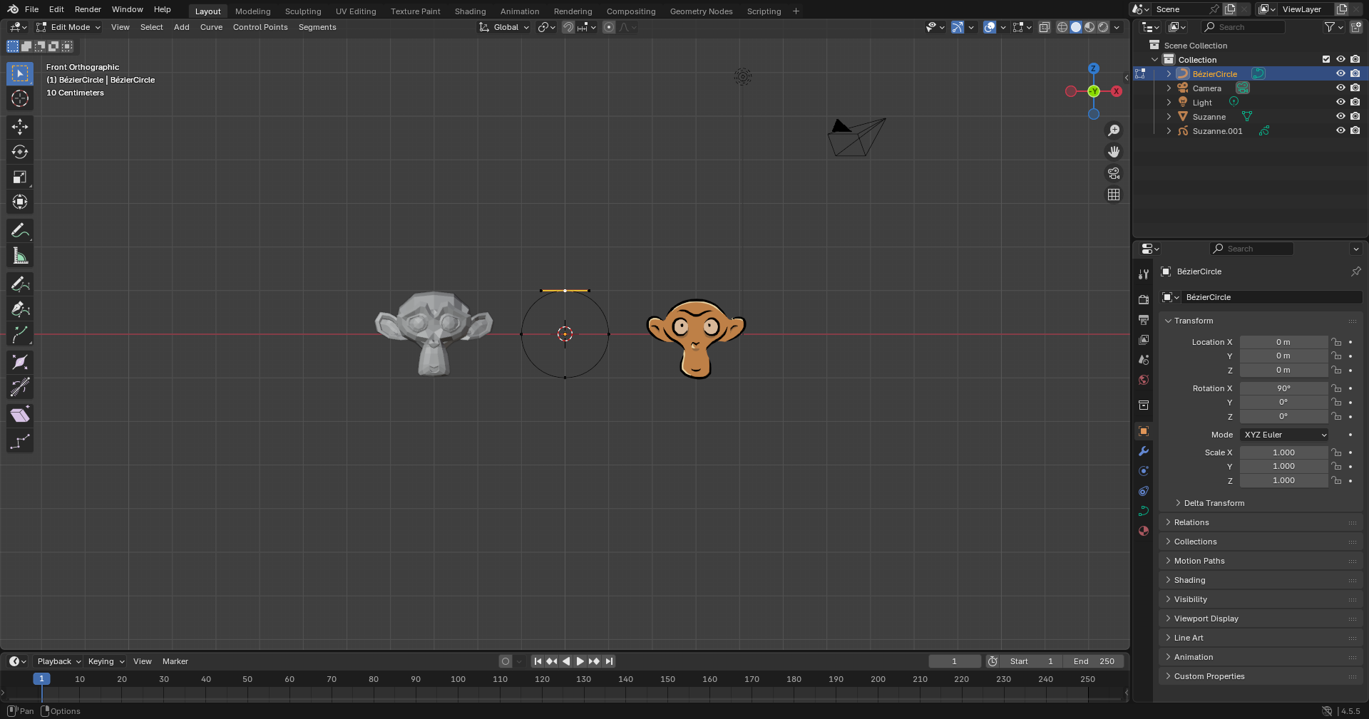

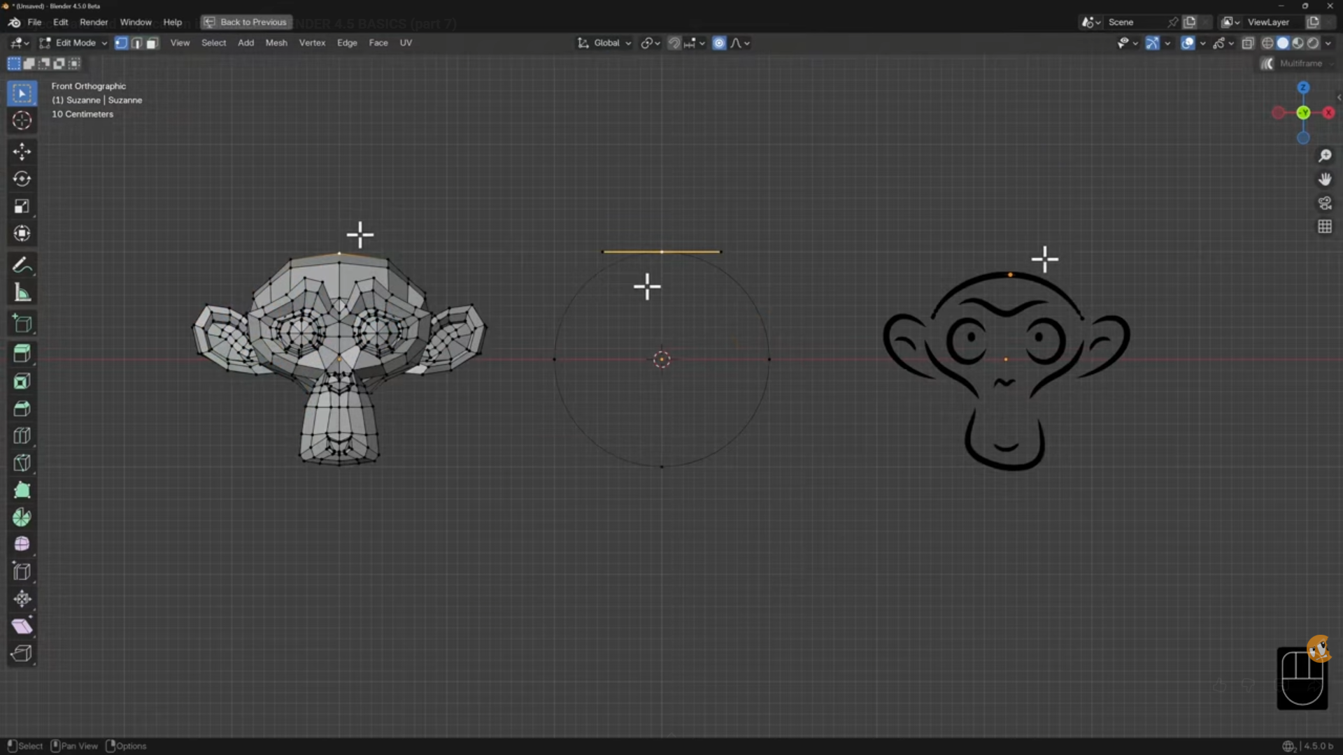

I hope someone can help. I’m currently working on the Course Material for Blender Basics: An Intro. to Blender 3D 4.5 LTS/ Section 2: Editing Objects/ Lesson 7: Object Data & Duplicating. The Instructor gave an example in Lesson 7, where he edited the components of three different objects at once from the Add Menu (Shift A), [the Mesh Monkey, Curve Circle, and Grease Pencil Monkey], by toggling between Object and Edit Mode. Example of his Edit Mode results below:
Unfortunately, when I attempted to repeat the example, I got less than desirable results. Shown here–
Somehow, when I switched from Object to Edit Mode, only one of the three objects’ vertices were visible– The other two, the Mesh and Grease Pencil Monkeys, vertices were missing. I thought it might be my method of selection, but no matter the order, or the number of items I selected in Object Mode, the result was the same– Two of the three objects’ vertices (in this case, the monkey’s) were not accessible in Edit Mode.

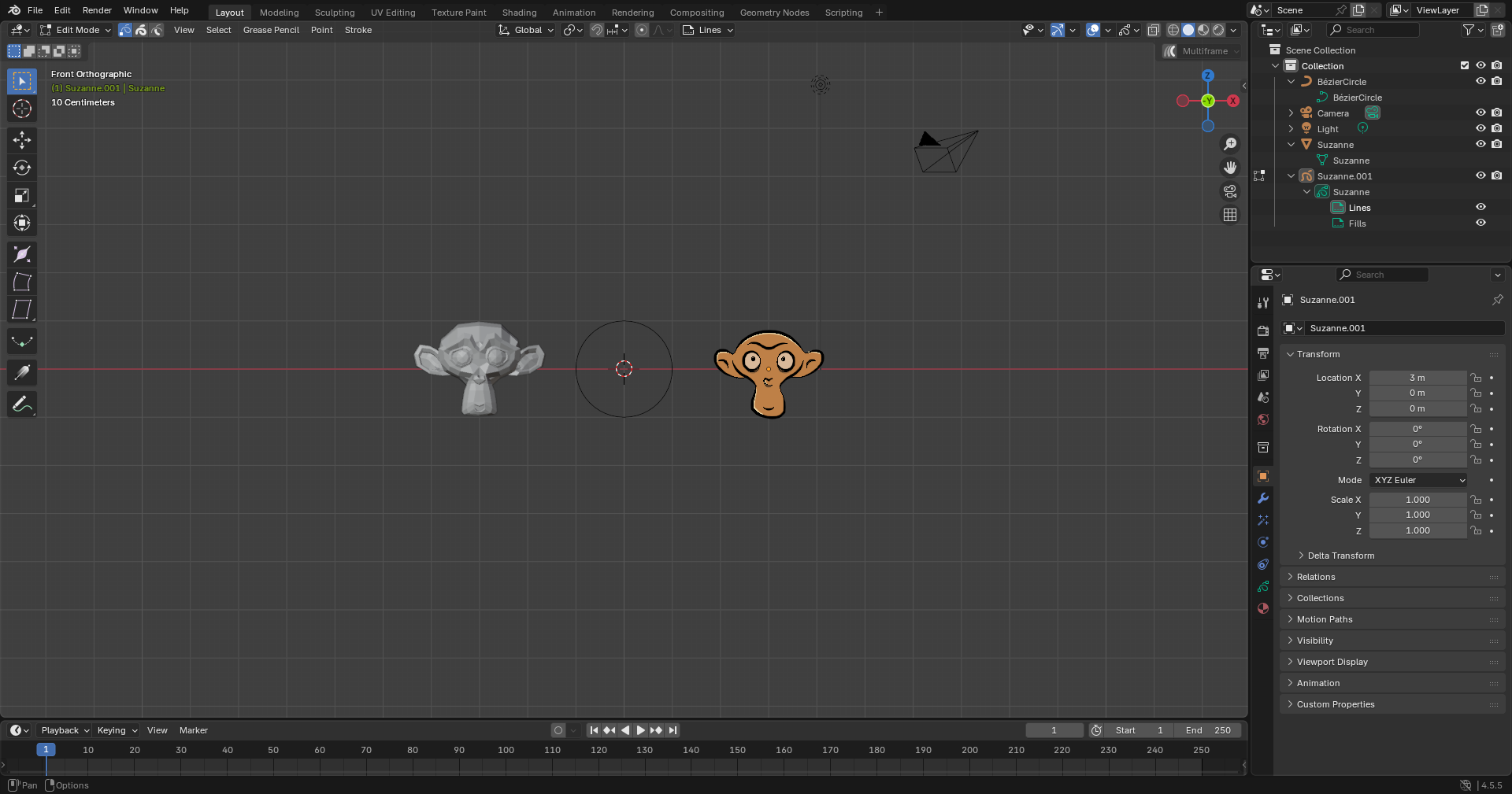

I’ll give another example– Here was a switch from Object to Edit Mode without any items being selected–
Again, notice no vertices. And, yet there was more:

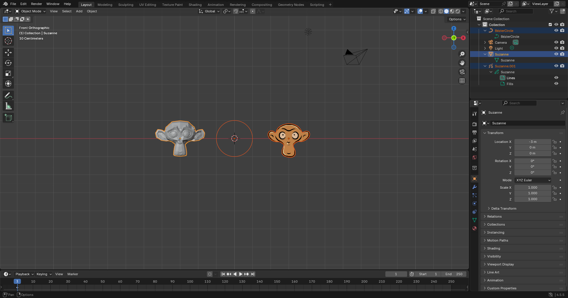

This time I selected all three objects, left to right (although, right to left gave similar result) in Object Mode. When I toggled to Edit Mode this is what happened– Only the Mesh Monkey vertices were visible, but not selected (highlighted), and the other two objects were selected, but had no vertices. Also, I could not deselect the Curve Circle, nor the Grease Pencil Monkey in Edit Mode. Strangely, when I returned to object mode, all of the objects were selected, and could be deselected in any order, or group. Shown below—
Of coarse, I could get the vertices for the Mesh Monkey and the Curve Circle individually in Edit Mode, but not in a group. Also, the Grease Pencil Monkey highlights but does not seem to have vertices, no matter what the Mode, or approach.

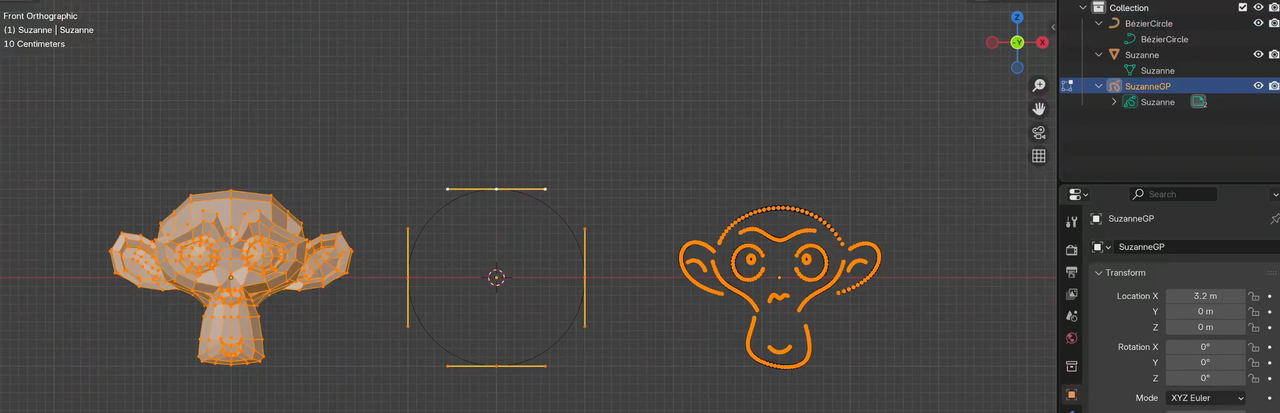

Why could Paul do that then, you ask… Fair question. Paul can’t do that either, but he has ‘doctored’ (Photoshopped?) the footage; it’s fake:
In the Outliner, you can see that only the Grease Pencil Monkey is Selected and in Edit Mode.

Yes that is correct: I edited them side by side to demonstrate how each look like in their edited state.
Even in the very first screenshot in this Post, there are 3 Mouse Pointers…that was a bit of a give-away 😉
