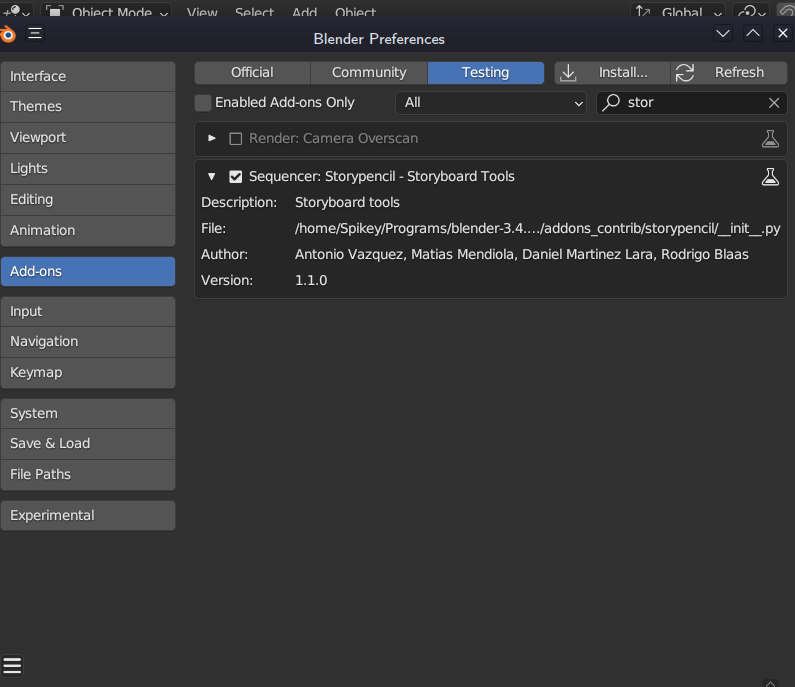

        Sure Craig,
        It’s still in the experimental phase; Testing area:

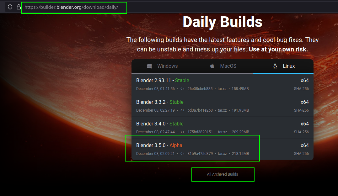

            Oops, sorry. I forgot, in official relaeses experimental features are missing. I still have the Beta version from 3.4. You could get 3.5 Alpha, or the latest 3.4 Beta (30th November) (under ‘all archived builds’):

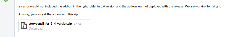

                @jcdelaronde @CCWieland @coyohti
                I found the problem and the solution:
                You can find this page with the link to the .zip here : https://developer.blender.org/T103040
                Save File and in the Addons Tab: Install…:
