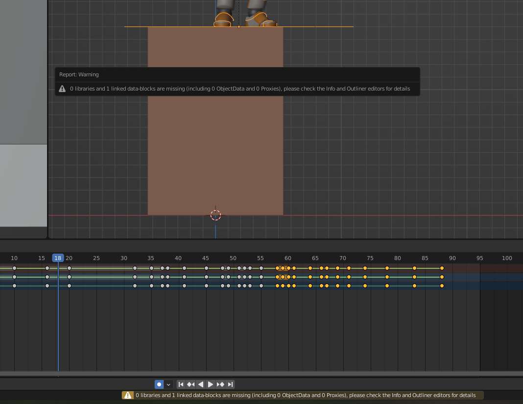

      Hi, today I downloaded Blender 3.0 and came across an issue where my proxy is not connected to the library anymore, another blend file. Turns out proxies are no more for blender 3.0 and we’re using Library Overrides now. My issue is my data is now not linked to the other blend file after saving my progress in Blender 3.0. Somehow it messed it up. my animation where some bones seem to be locked. How do I go about linking my character again to the the library, when I seem to do so the options are greyed out.
      I tried creating another scene linking the character and the scripting for the character, then pressing “Make Library Override” but that does nothing and there are no bones in the character. after that.
      Also the file that was saved in blender 3.0 can’t be opened in 2.93 anymore.

            The error message says that  the library has been found, but not 1 linked data block.
            If you change the outliner to display the blend data – then down the bottom it will show you any broken links – maybe you can find out what it should be linking to.

              Hi Wayne,  I’ve kinda found a file that works. I don’t know why but blender 3.0 seems to be creating duplicated versions of my files when I save. Only have this issue in 3.0,  with a version of .blend, .blend1, .blend11, .blend11.blend1 and also an unknown.blend. I have no idea why it does that, but I found a version where my rig works, so I didn’t closed the project file for a day and just tried to finish the exercise so I can close it. After closing it as I suspected the rig is broken again, but I found a version file that works that I just needed to link my action animation from another file. It’s all so confusing and I don’t know why Blender 3.0 does that.
              I tried the fresh file as well, but when I make Library override on the rivet rig, it makes another armature that is not linked to Rivet, either that or it makes an armature that is just squares.
              I also checked the IK or FK rig it didn’t made a difference, anyways it did worked out in the end and I finished my homework. Thanks for the reply Wayne, always appreciate the help.
